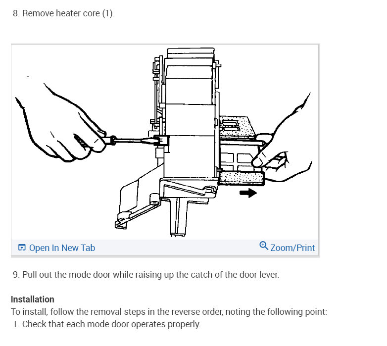

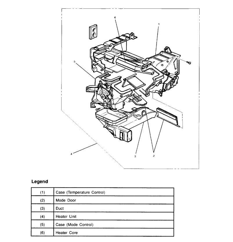

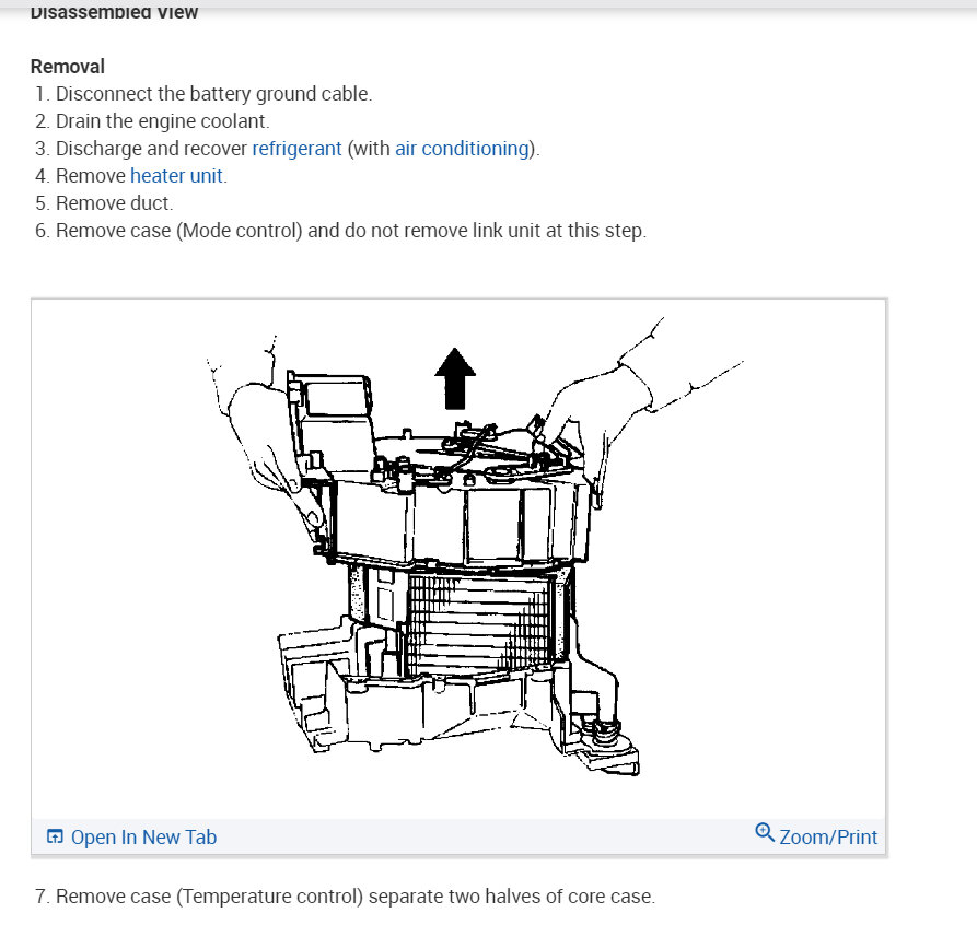

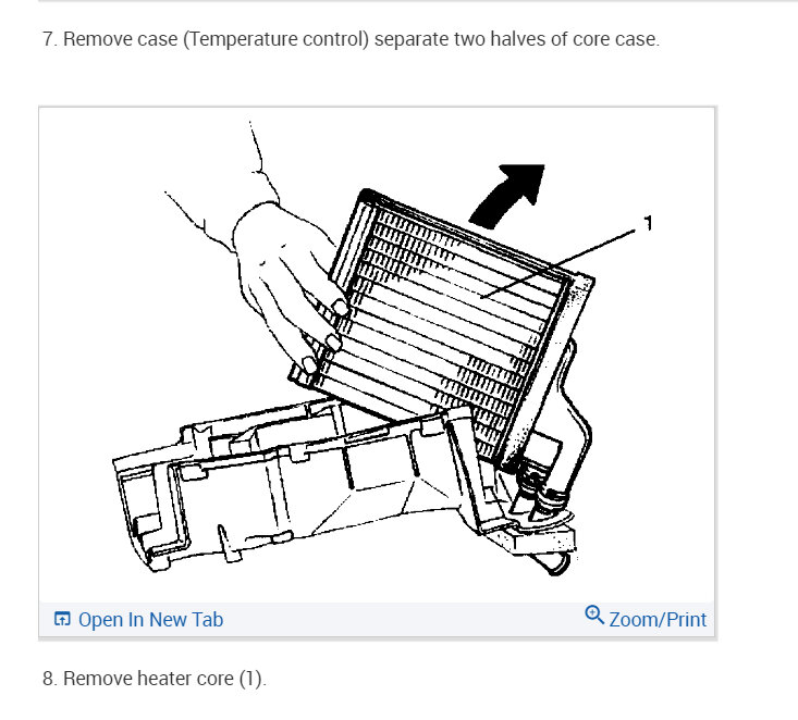

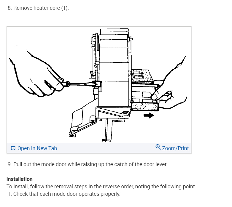

i have a 1996 isuzu trooper with 3.2lt. sohc engine. i bought a heater core to replace the leaking one on the truck. ther is no visible way to easily remove the old one. can some one show me an exploded veiw of this thing? also any tricks or tips to keep from removing the entire dash. and the screws that mount the coolant lines appear to come from the engine side of the firewall. any help would be greatly appreciated. thanks david sims
Jan 16, 2007 at 11:06 PM
CARUNDELL
  • 602 POSTS
Here is a generic guide on how to replace the heater core start by disconnecting the battery and draining the coolant. I have included instructions in the images below for your car.
https://www.2carpros.com/articles/replace-heater-core
Check out the images (Below). Let us know what happens and please upload pictures or videos of the problem.
Jan 17, 2007 at 12:26 AM
Suggested Repair
Disconnect the battery and drain the coolant, then replace the heater core using the included vehicle instructions, images, and heater-core replacement guide.
