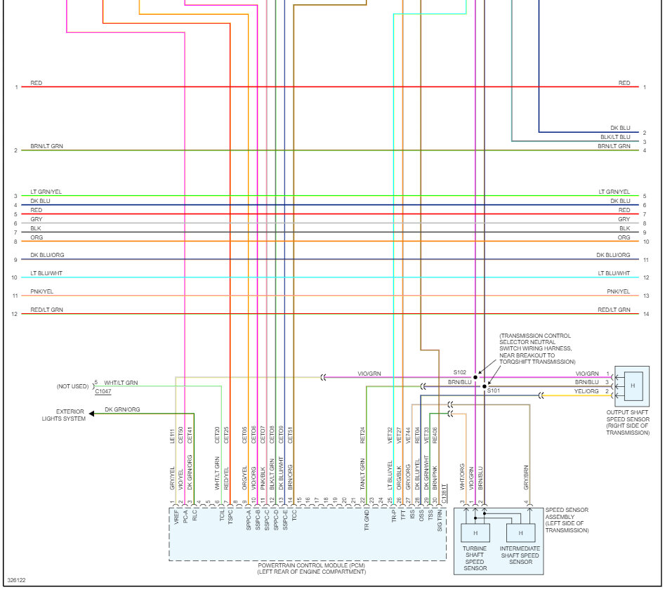

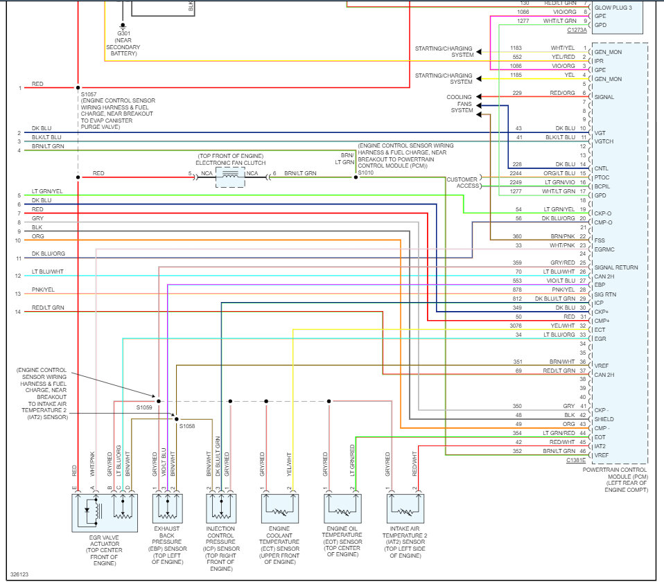

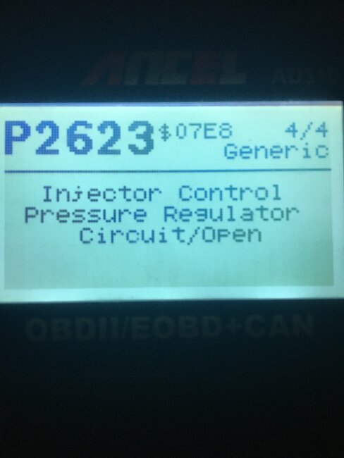

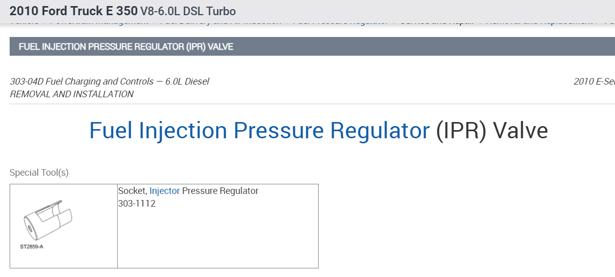

Hi again Joe, sorry to bother. l have lost your website I found your last reply so I used it to seek help if I may. I have a problem with IPR I cranked no start I take the IPR pigtail out and put it in again car start up right away with no problem next day morning I do the same procedure and bought new original IPR the same problem l scan with my scanner I got always this code p2623 is it harness problem and how can I check the harness and if kindly there's diagram leading me the car PCM which wires should I check.

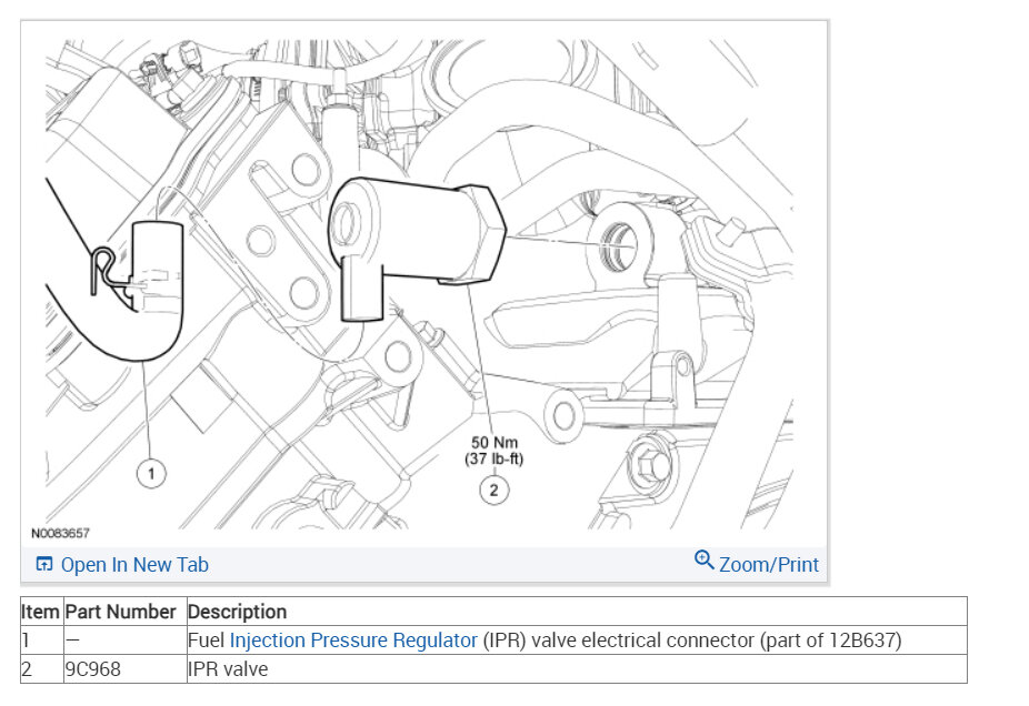

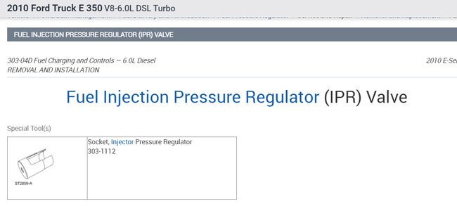

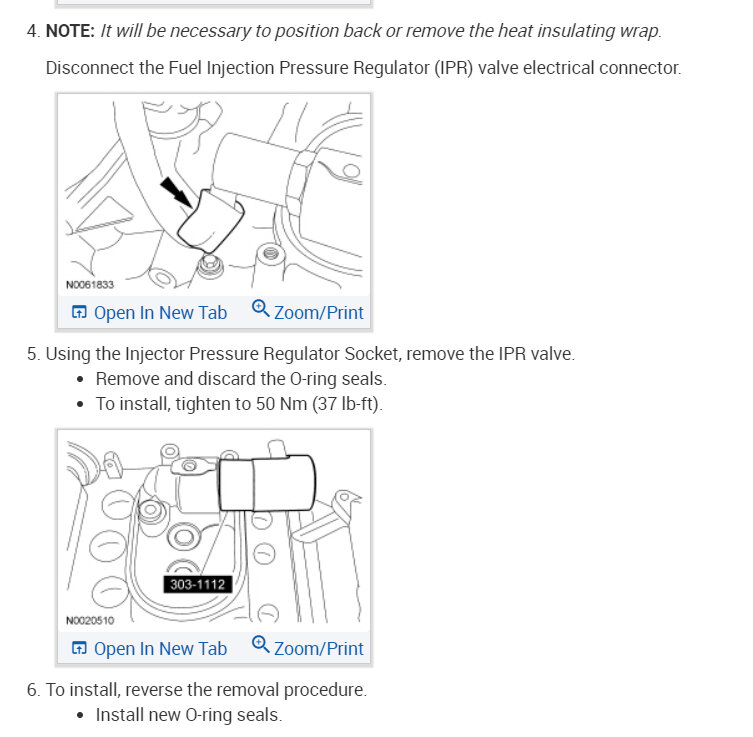

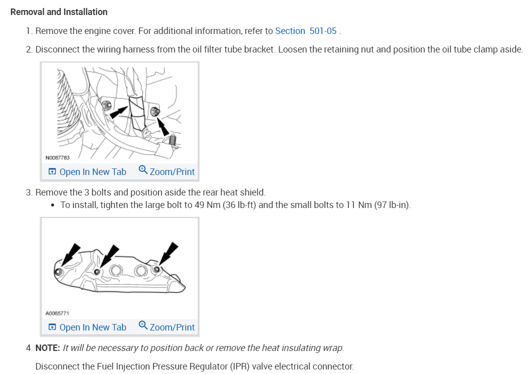

It sounds like the valve has gone bad. Please check this video which shows the problem:
https://youtu.be/MYG3EWh0mbg?si=GKqBk6CHY69eMa6W
Here are the instructions on how to replace the IPR valve. Check out the images (below). Please let us know if you need anything else to get the problem fixed.

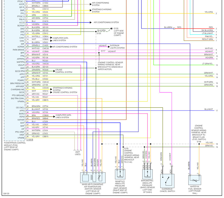

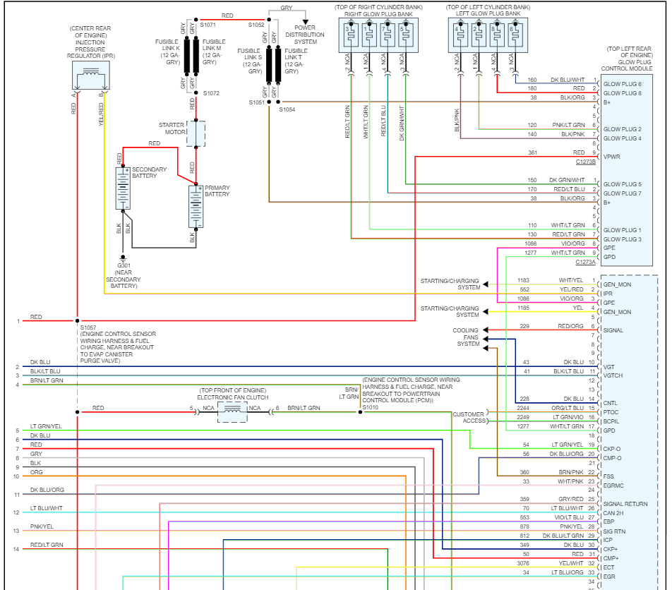

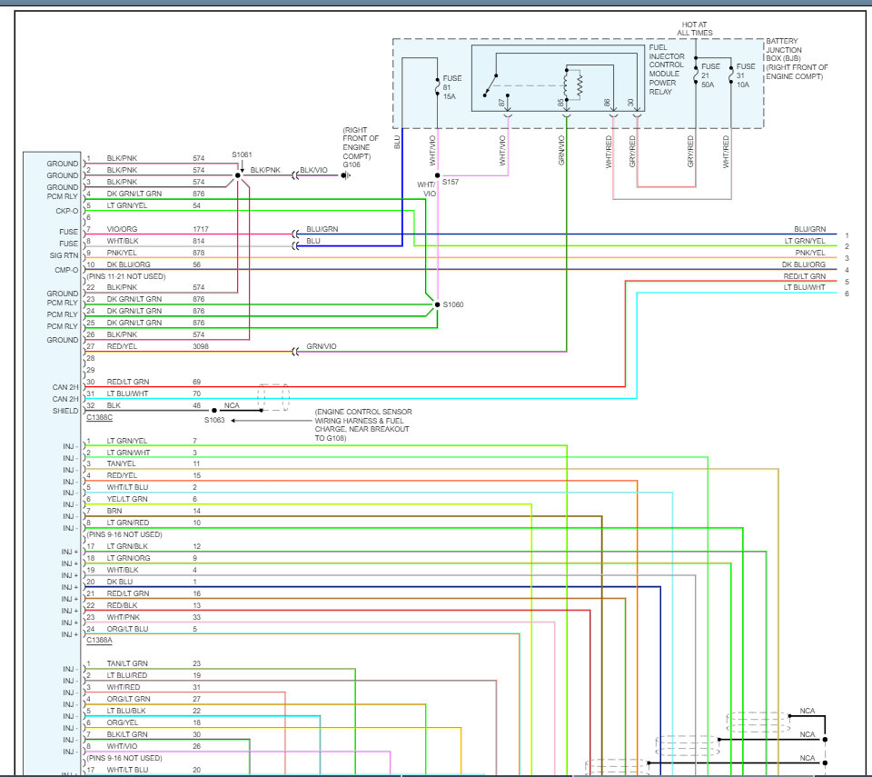

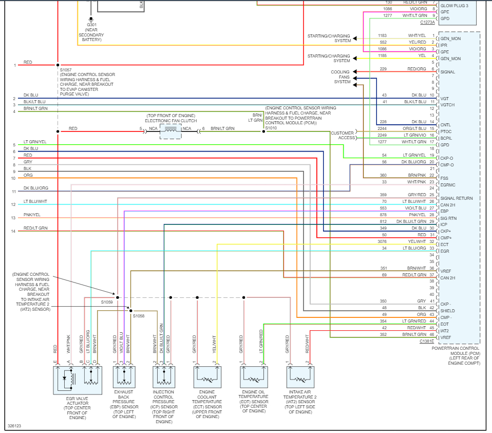

Thanks Ken. the IPR and also ICP are new original on but i still get this code in my scan tool p2623 some i take IPR pigtails out and connected again start right away with no problem I suspect may be wiring issue from IPR to FICM am wondering if there is wire diagram I'm just guessing maybe i am wrong your advice will be helpful
Thanks, a lot.
Sep 18, 2023 at 10:26 AM
  • 55,224 POSTS

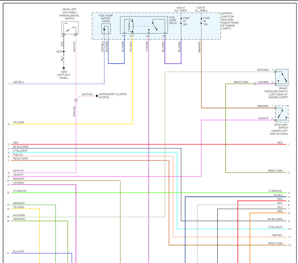

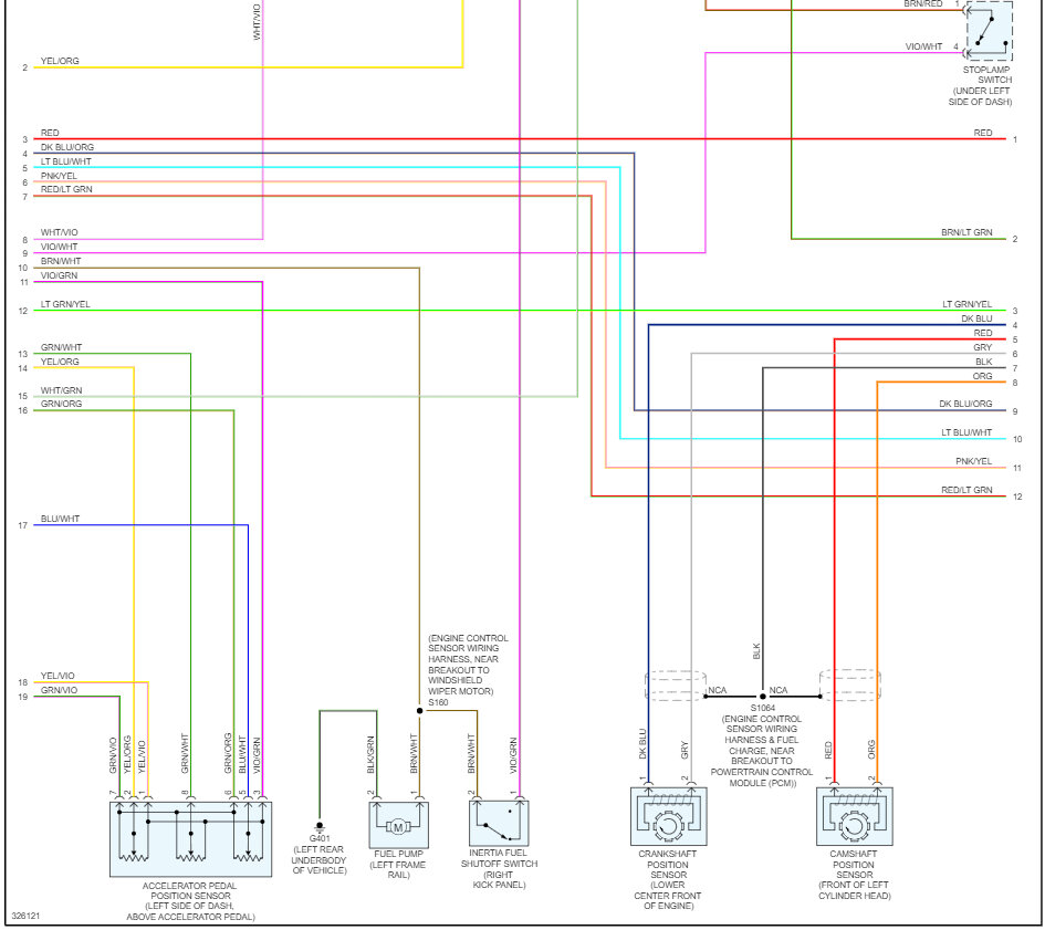

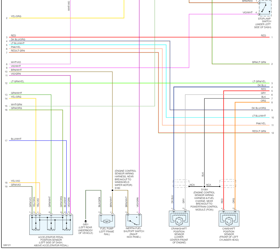

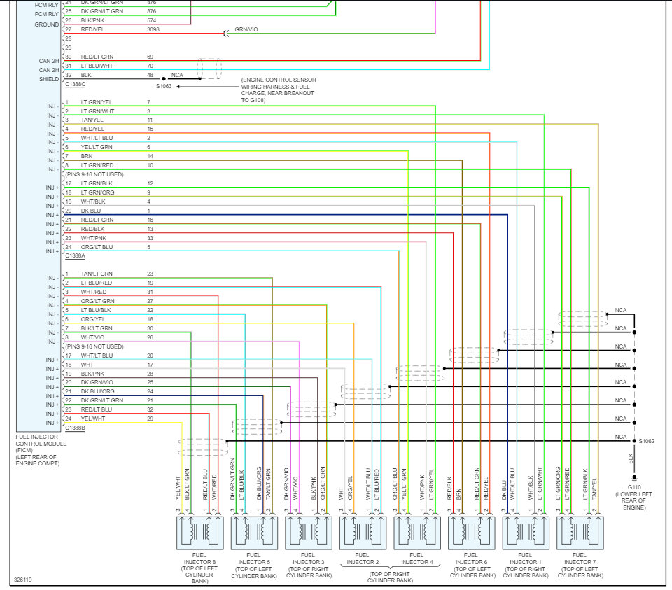

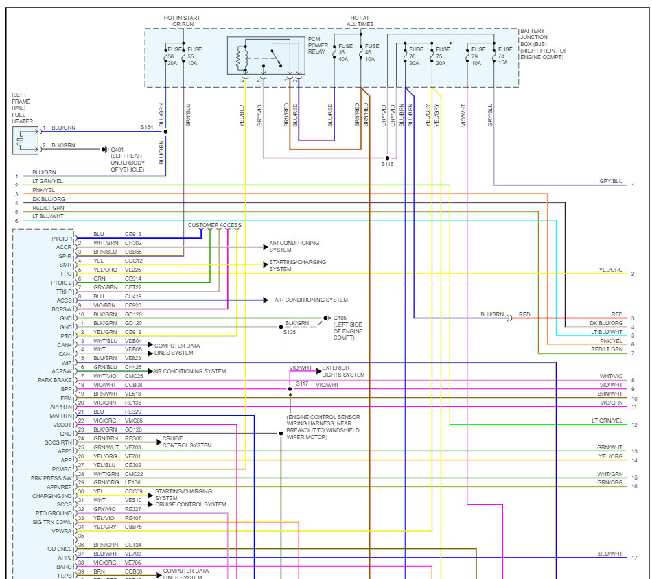

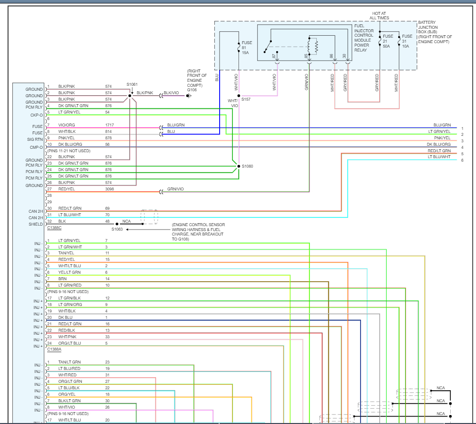

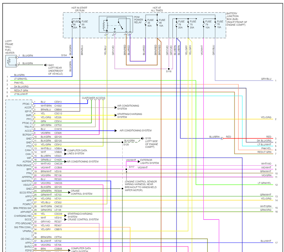

new original? Does this mean you replaced them with new OEM unit, or they look new and or original? Here are the wiring diagrams and a guide for the IPR and engine.
Check out the images (below). Please let us know how it goes.
Sep 20, 2023 at 9:47 AM

Since my knowledge in cars are poor am trying to learn from YouTube and people like you it's difficult for me to understand this diagram hopefully i can found help.
If i may ask is ipr wires connect in the harness to ficm directly.
is there fuse or relay related to ipr
Is oil pump or bad o rings make ipr failed how can i till

code p2623 is a circuit error so no on the bad oil pump or bad or rings to cause the issue. This will be the valve, wiring or PCM. Please double check the wiring using the diagrams and guide above.
