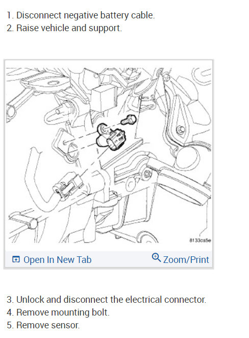

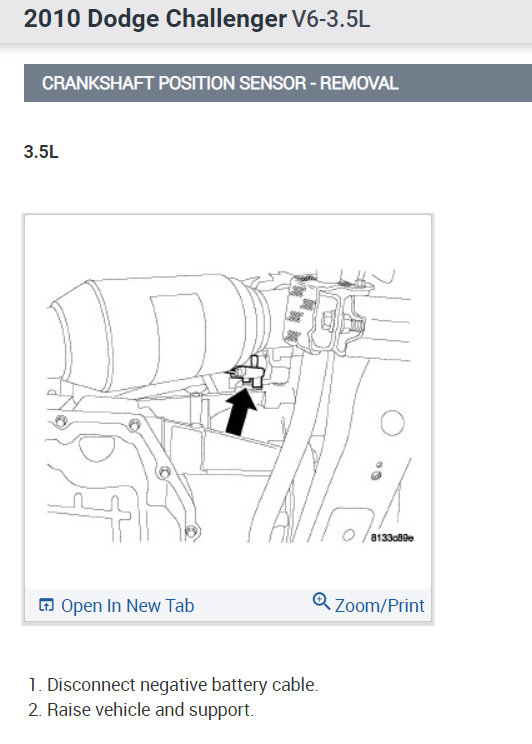

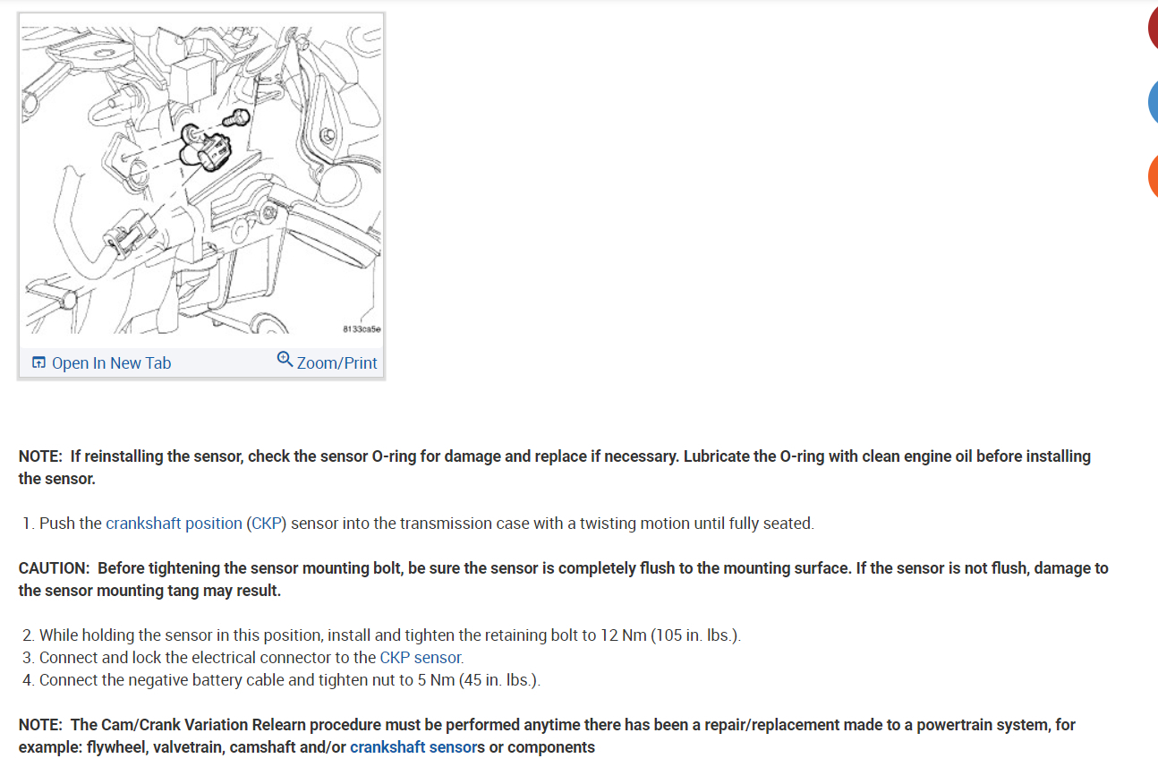

This sounds like the crankshaft angle sensor or the fuel pump has gone out. when you turn the key to the on position without cranking the engine over can you hear the fuel pump run in the tank for 5 seconds?
and
https://www.2carpros.com/articles/engine-stalls
Neither will throw a code, lets try the crankshaft sensor first. here are the instructions on doing so. Check out the diagrams (below). Let us know what happens and please upload pictures or videos of the problem.

I read through this thread and noticed we haven't heard from you for a couple of days. Has any progress been made? We are very interested in knowing.
As far as the problem, as Ken mentioned, it could be the pump or crankshaft position sensor. Does the vehicle restart immediately after it stalls?
Take a look through this link and let us know if it seems to mirror what you experience.

All that said, I haven't stalled out yet, it's been a few days, but my throttle response is pretty garbo, and after reading what Ken said about the crankshaft position sensor, I started reading into what it's fault conditions are, and it's dead on with what I'm seeing. I'd check to see what it's reporting to the ECU, but like I said, the laptop has been a pain. So I ordered one from RockAuto, and should have it next week.
All things considered, I think Ken is dead on, at least with what I'm seeing right now. I still find it funny that unplugging the MAP sensor somehow bypasses sensor input for the crankshaft sensor (Since, whenever the vehicle stalls, It's almost impossible to get it to start back up without unplugging the MAP sensor). I guess maybe the ECU goes into a 'last known configuration' type of safe mode, where it doesn't rely on sensor input to do it's on the fly tuning, and just goes on straight programming.

Terribly sorry about the super late reply, I got the CPS sensor done a few days ago, and I had done the relearn procedure, along with a few other relearn procedures in Witech. The car runs great, except for one thing that has bugged me ever since this all started, and It's only just dawned on me what it might be.

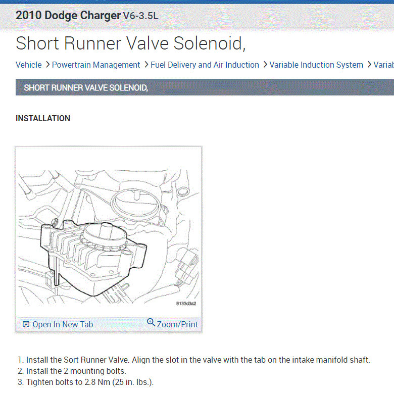

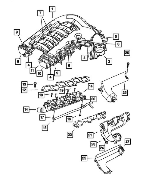

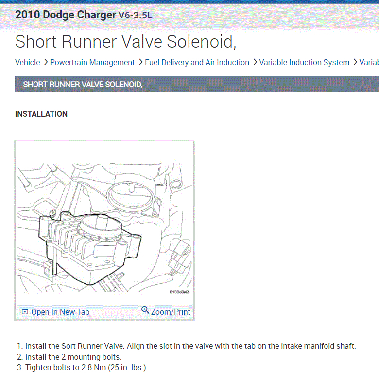

But this all brought into my mind something I was testing in Witech, I forget what it's called but it's the motor attached to the plenum, that opens these dampers for the EGR system, and lets exhaust gas in through the top end of the intake. When I actuate that motor, and send it to full open, the car immediately stalls, which I had just assumed I was flooding it with exhaust gas, and it wasn't getting any oxygen. I'm wondering if the car is supposed to run with that full open.
Some context; when I was screwing around and cleaning everything back in January, I had removed that motor, and cleaned the plenum with soap and water, and let it dry for a few days. I'm wondering if I had misaligned that motor, or those dampers when I put it back together.
In the attached image, I'm talking about part #10, it moves these air dampers inside the plenum, and I'm wondering if them being misaligned somehow can cause my stall condition. After all, it would make sense that I've created my own problem, and have been chasing phantoms the whole time. Either way, the car has been running pretty decent lately, I just haven't taken it on the highway, I've been too busy to get to have some fun with it.

So, a next day update. I did play around with that motors alignment, and have made conditions worse. The throttle response, and hesitation seems like the car is choking whenever it runs in eco mode. Driving in autostick, which disables eco mode makes everything go back to normal operation, save for the car running a little bit more rich.
So, is there an alignment procedure for this little guy? Cause the only thing I can think of is taking the plenum off, and pressing the vent/dampers to a full closed position, and somehow lining the motor up to that.

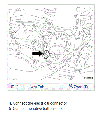

Number 10 is the short runner valve actuator. If you take a look at the pics below, they describe the installation process. Let me know if that is the part you are referring to.
see pics below

Yep that looks like it. Is there a way to incorrectly install it? Since it feels like it only goes in one way, but then again maybe I'm doing it incorrectly.
I was thinking about telling the computer to close the valves (with the solenoid unmounted), and installing it that way. Since it feels like it's spring loaded, and I can't seem to get it to line up correctly with the notch in the plenum. I can get it installed, but I think the valves are slightly open once I have it in there.
Mar 25, 2021 at 11:26 AM
  • 110,240 POSTS
There is a slot in the actuator that needs to be aligned with the shaft in the intake. Did you do that? That is the only part that gets aligned.

Yeah, I have it aligned, it's keyed in such a way that it can only be installed one way. Maybe I had messed up something with the shaft, or the plenum. I'm going to have to take it apart again to see.
Mar 26, 2021 at 4:14 AM
  • 110,240 POSTS
To the best of my knowledge, that is the only alignment point. Let me know what you find.

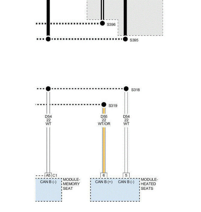

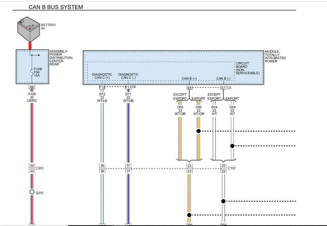

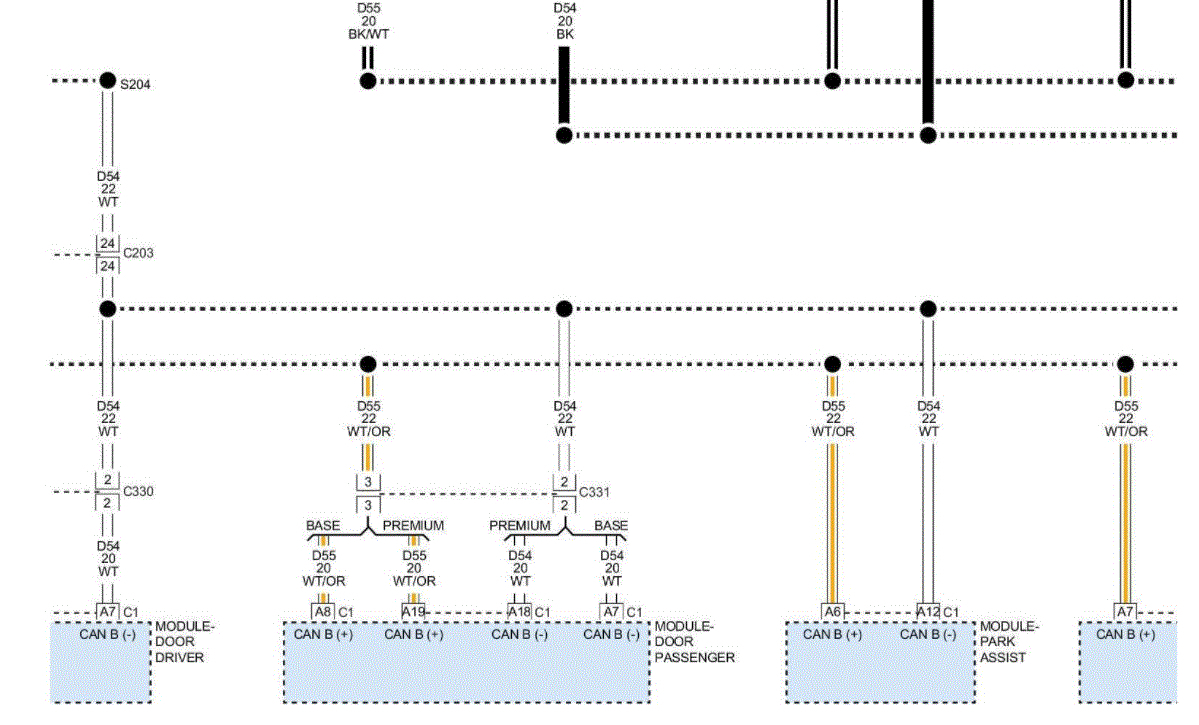

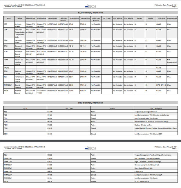

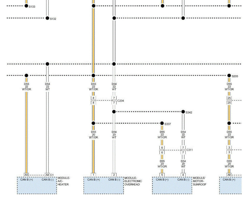

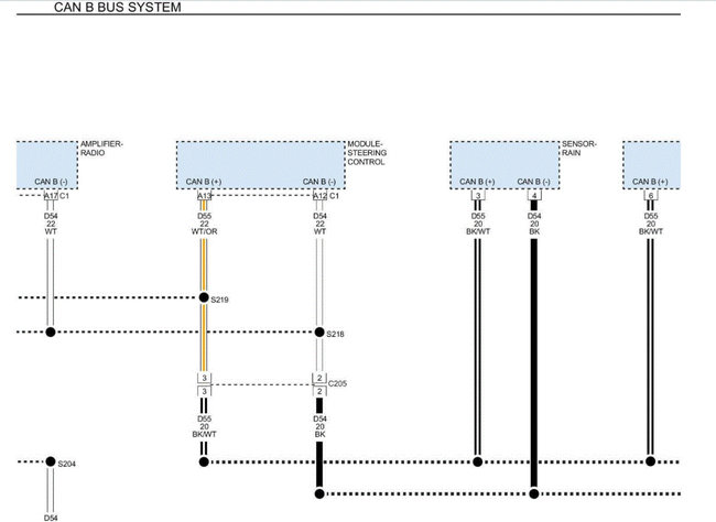

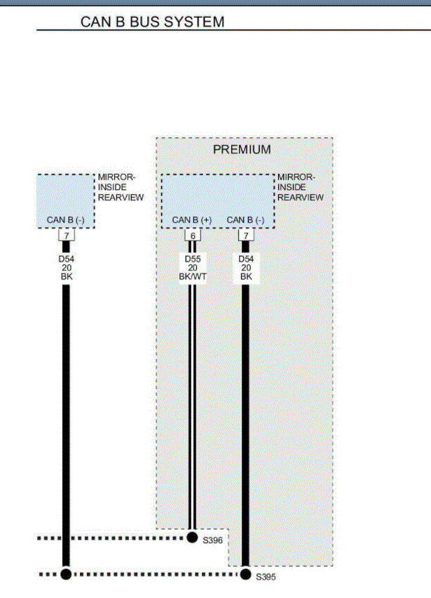

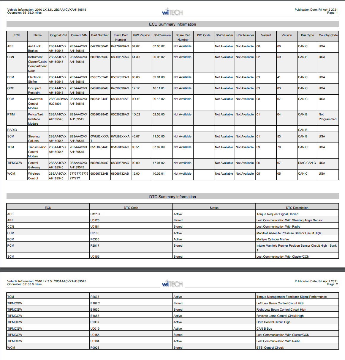

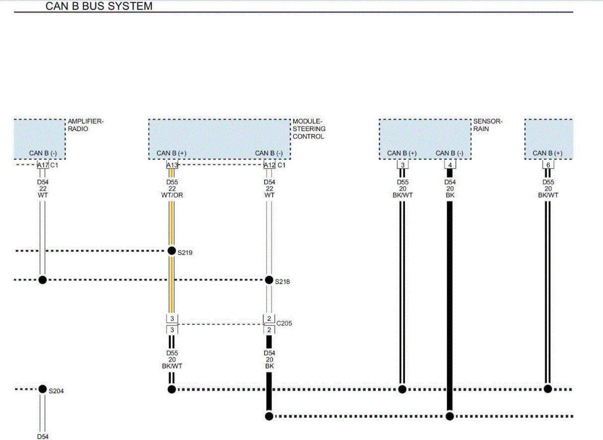

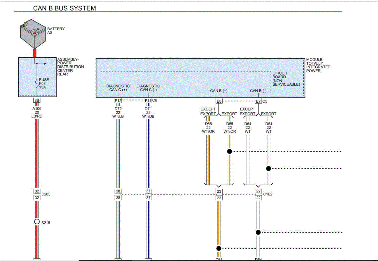

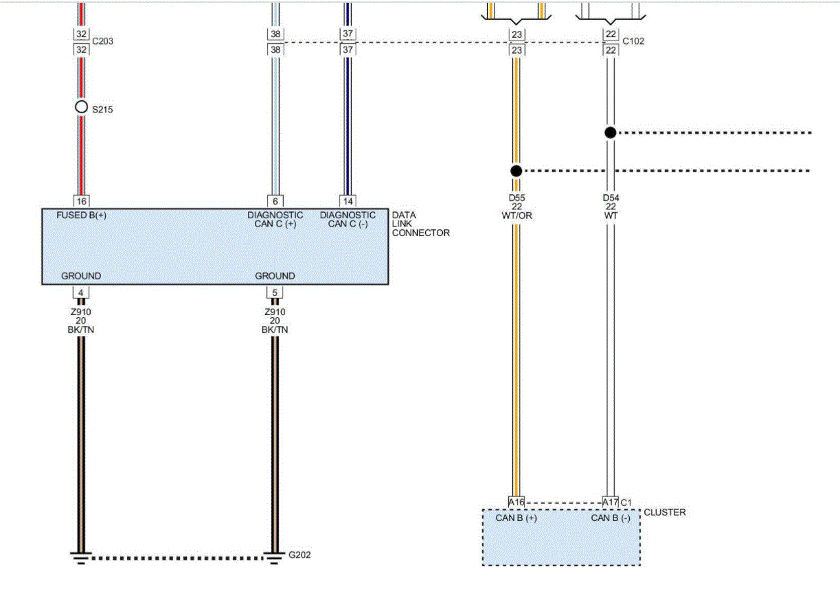

So, a small update: I'm going to shift towards troubleshooting a CAN bus issue. Since I have multiple comm faults reported in Witech when I did a data dump the other night. Additionally the WCM doesn't know what it's VIN is. Most of the comm faults are on CAN B, but I do have one on CAN C.
Either way, not sure where the P0300 came from, the engine absolutely isn't misfiring. But if anyone knows how to get the Witech Micropod 2 to show oscilloscope data, it would be greatly appreciated, since it has access to the CAN high, and low pins. I just don't have a scope.
Also, yes I've replaced the MAP twice.
Apr 2, 2021 at 3:06 PM
  • 110,240 POSTS
I'm not familiar with Witech. Sorry about that.

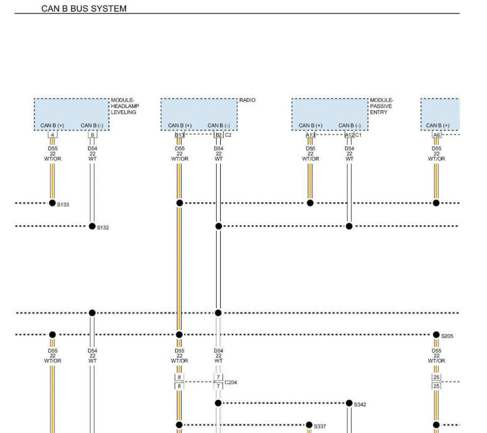

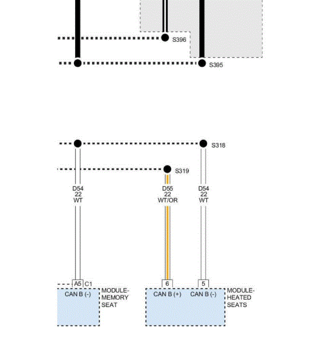

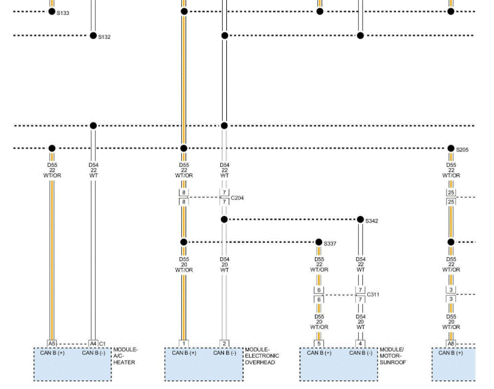

If you look at the pics below, I included the wiring schematic for CAN B. I cut the pics in half to make them readable. I overlapped them so you can follow them easier.
I don't know if you need them, but I figured I would add them for you.

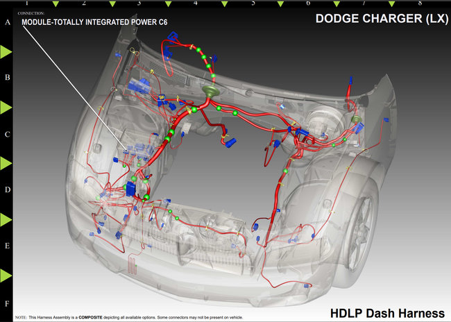

Is it possible that the turn signal lights (they're switchback white amber LEDs, with a resistor pack inline) are causing my car to stall out somehow? For the last week I've been driving without them, and the car has worked fine, no issues.
Some more things I'd like to bring up, as I've read about this issue in Buicks, and Chevrolets that it could be related to a switch, or relay in the ignition, or some other power draw. I've attached the HDLP harness which is what I was using to troubleshoot what's connected to the TIPM, as that's where my troubleshooting continued to. It's also what lead me to disconnect the turn signal lamps.
The reason I bring this harness up is because although the Dash cluster is not on the CAN C topology, it is still connected to the HDLP harness. Additionally, I have the issue described by this guy https://www.youtube.com/watch?v=uGlqG_HJpwI but have not gone through repairing
replacing the dash cluster. I never figured it was a big deal. But that said, basically the only thing that works in my dash is the odometer, and some of the lights (check engine, ABS, ESP, and parking brake light).
Could the dash be causing interference in the electrical loop? I mean as for right now the car works fine, I got a whole week without any issues, but I don't have turn signal lamps, and I'm just wondering if that's just a symptom of another issue hidden underneath.

  • 110,240 POSTS
It could be anything including the cluster. What I need you to do is start a new thread specific to the instrument panel. We try to keep the links specific to one topic so it helps others. I hope you understand.
Let me know when you've done it and I'll look for it.
