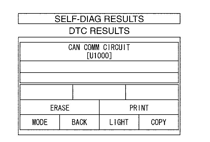

I don't know what kind of scan tool you have but I'm going to provide the diagnostics for both of the U codes you have. The U1000 is the one I can break into the transmission related issue. I will provide that first. The attached pics correlate with the directions.

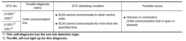

Vehicle ALL Diagnostic Trouble Codes ( DTC ) Testing and Inspection U Code Charts U1000 Transmission Control System
TRANSMISSION CONTROL SYSTEM
DTC U1000 CAN COMMUNICATION LINE
Description
Controller Area Network (CAN) is a serial communication line for real time application. It is an on-vehicle multiplex communication line with high data communication speed and excellent malfunction detection ability. Many electronic control units are equipped onto a vehicle, and each control unit shares information and links with other control units during operation (not independent). In CAN communication, control units are connected with 2 communication lines (CAN H line, CAN L line) allowing a high rate of information transmission with less wiring. Each control unit transmits/receives data but selectively reads required data only.
On Board Diagnosis Logic
- This is an OBD-II self-diagnostic item.
- Diagnostic trouble code "CAN COMM CIRCUIT" with CONSULT-II or U1000 without CONSULT-II is detected when TCM cannot communicate to other control units.
Possible Cause
Harness or connectors (CAN communication line is open or shorted.)
DTC Confirmation Procedure
NOTE: If "DTC Confirmation Procedure". As been previously conducted, always turn ignition switch "OFF" and wait at least 10 seconds before conducting the next test.
After the repair, perform the following procedure to confirm the malfunction is eliminated.

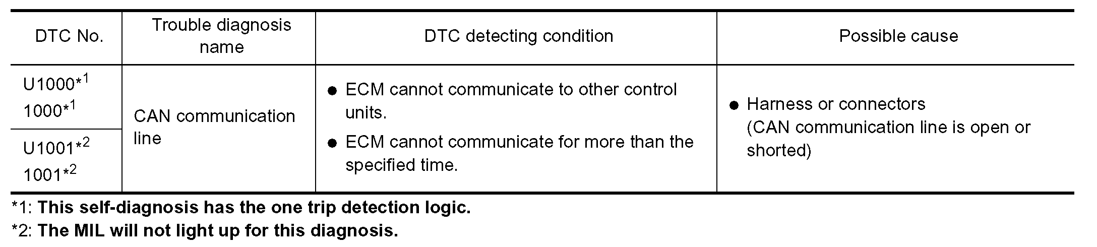

Diagnostic Procedure
1. CHECK CAN COMMUNICATION CIRCUIT
With CONSULT-II
1. Turn ignition switch "ON" and start engine.
2. Select "DATA MONITOR" mode for "A/T" with CONSULT-II.
Pic 2
3. The "CAN COMM CIRCUIT" is detected.
Yes or No?
Yes >> Print out CONSULT-II screen, GO TO 2.
No >> INSPECTION END

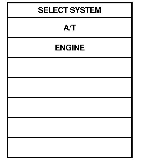

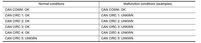

2. CHECK CAN COMMUNICATION SIGNALS
With CONSULT-II
2. Select "CAN COMM SIGNALS" in "DATA MONITOR" mode for "A/T" with CONSULT-II.
>> Print out CONSULT-II screen, go to "Precautions When Using CONSULT-II".

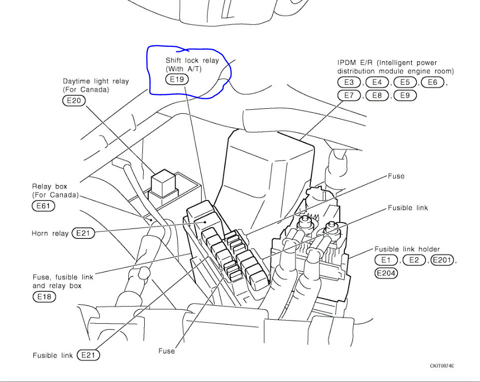

Vehicle ALL Diagnostic Trouble Codes ( DTC ) Testing and Inspection U Code Charts U1001 CAN Communication
CAN COMMUNICATION
DTC U1001 CAN Communication Line
Description
CAN (Controller Area Network) is a serial communication line for real time application. It is an on-vehicle multiplex communication line with high data communication speed and excellent error detection ability. Many electronic control units are equipped onto a vehicle, and each control unit shares information and links with other control units during operation (not independent). In CAN communication, control units are connected with 2 communication lines (CAN H line, CAN L line) allowing a high rate of information transmission with less wiring. Each control unit transmits/receives data but selectively reads required data only.
pic 4
1. Turn ignition switch ON and wait at least 3 seconds.
2. Select "DATA MONITOR "mode with CONSULT-II.
3. If 1st trip DTC is detected, go to "Diagnostic Procedure" below.

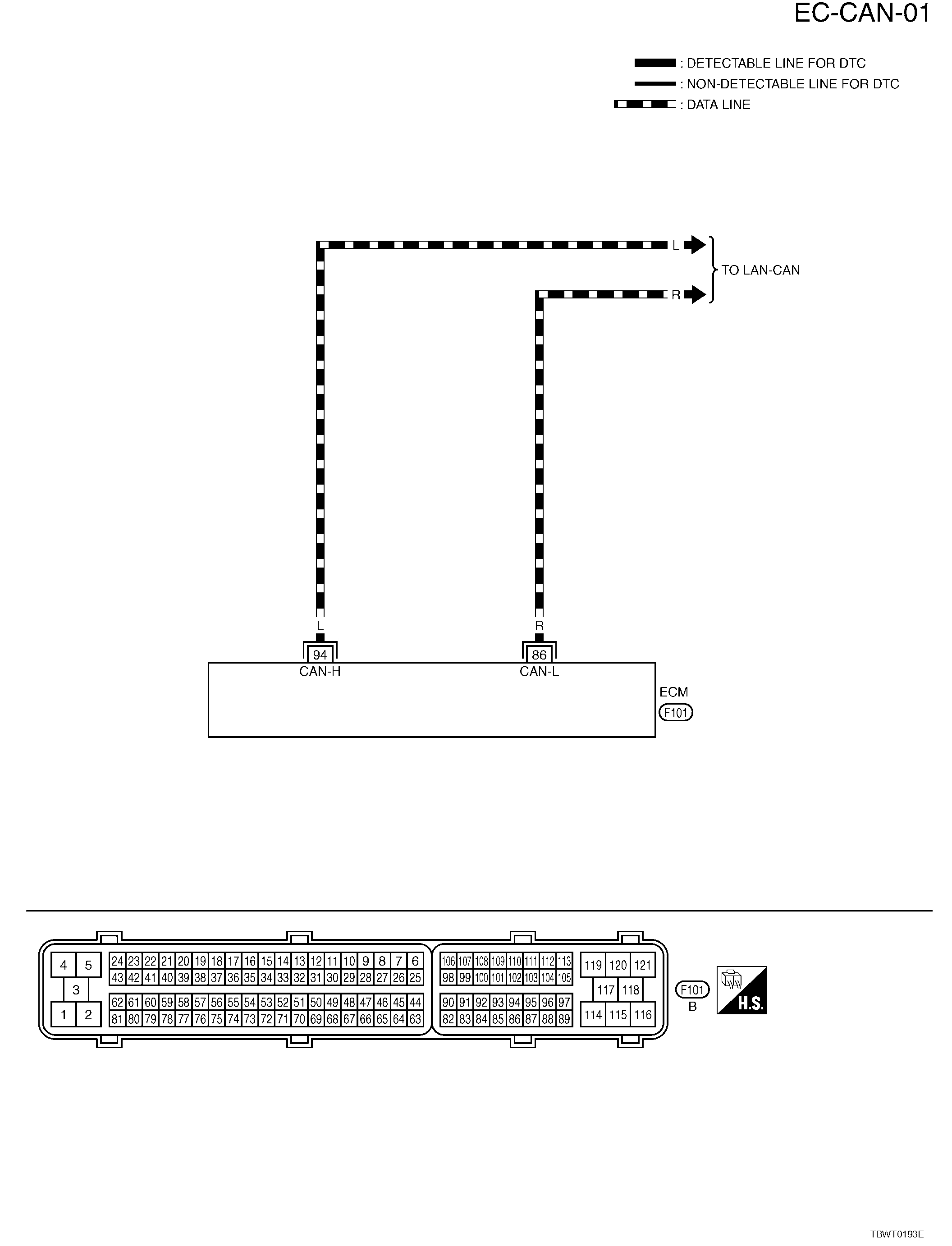

Wiring Diagram

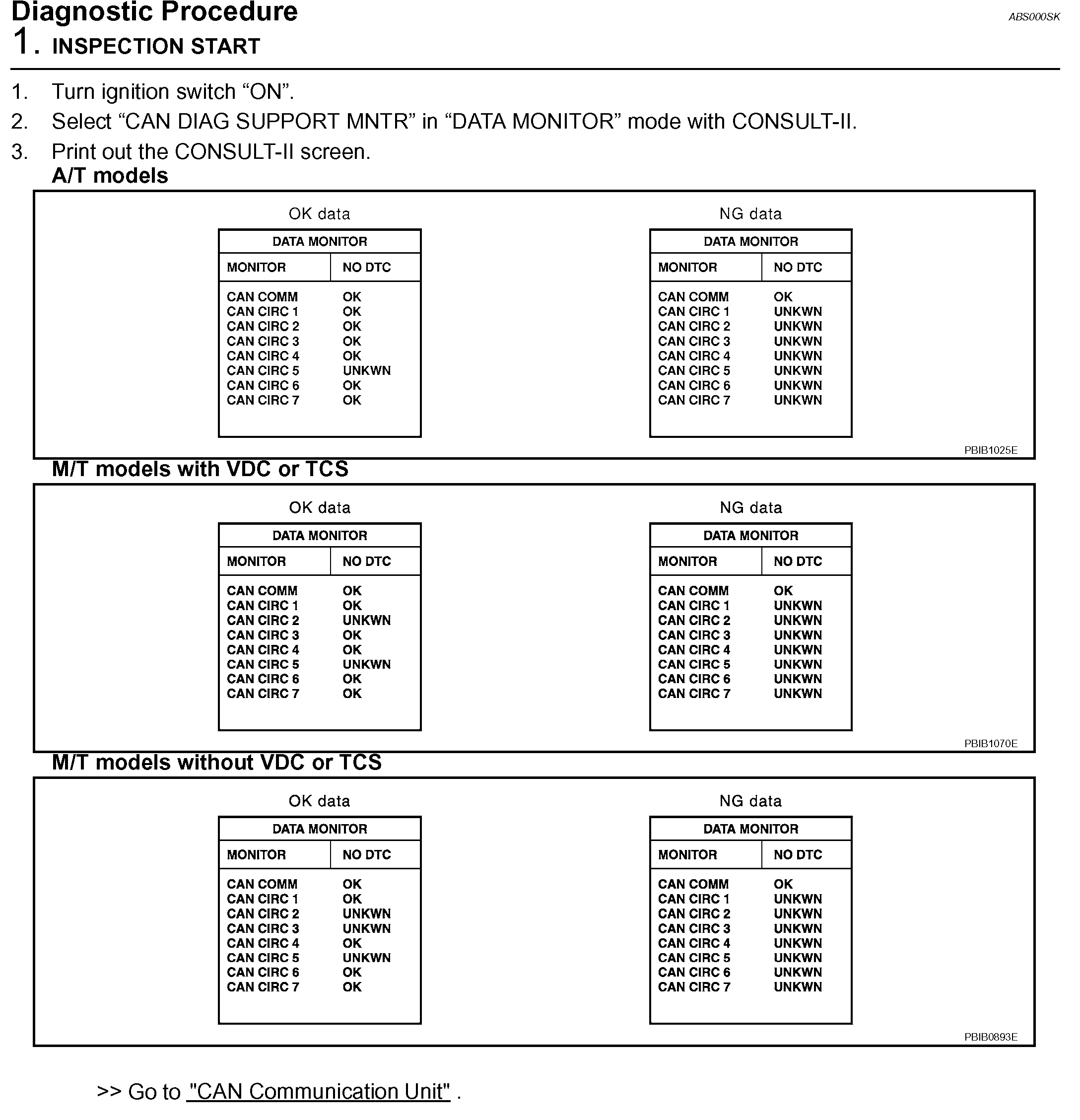

Diagnostic Procedure Step 1
pic 6

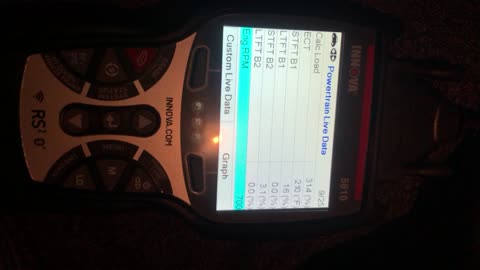

Okay, I think I found the fuel trim list as STFT and LTFT. These numbers are at idle and do move within 1% +/-:
STFT B1 12.5%
LTFT B1 0.0%
STFT B2 11.7%
LTFT B2 0.0%
Monday, August 17th, 2020 AT 7:48 PM

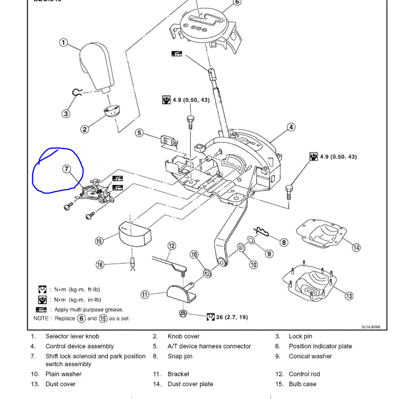

Where are you hearing the clicking while the shift indicator is flashing? Take a look at the attached pic. The item I circled is the park position switch and the park interlock switch. Could the sound be coming from that area?
By the way, the fuel trims look good.

Do me a favor. Check to see if it is the shift lock relay. You should be able to feel it by placing your fingers on the relay. I attached a pic below.
If that is the relay, switch it with a different one having the same part number. Or here is a link that explains how to test one:

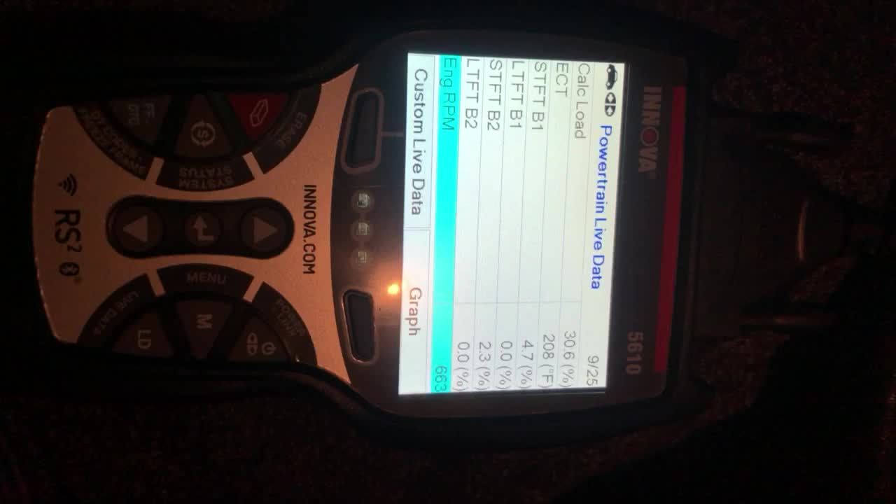

I drove around for awhile and stopped to turn off and on and worked every time. However I am still getting the stuttering when accelerating from a stop. There are no codes for that either. In fact there are no codes present right now.
I have a video of my scan tool when I rev and the stuttering happens. You Can see the fuel trims and rpm's. You can hear in the video where the motor cuts out as I rev as well.

It is possible that by removing and reinstalling the relay it is not making a good connection. See if that changes. As far as the fuel trims, they look good. For some reason I have no column to hear what is happening and I can't quite see the RPM's on the scan tool.

I only just removed it today after you mentioned it and reinstalled it. I made sure it got a firm connection when reinstalling. Yeah the upload really ruined the quality. If you can see when the camera jerks around really bad that’s when it is stuttering. It’s so abrupt it moves the whole car. I have no clue where to begin looking without any codes, lol.

Did the RPM's skip on the scan tool or anything when you felt the misfire? Without codes, it is going to be tough. I have a feeling the relay had a bad connection with the start issue. Lets hope that is resolved.
For the misfire, you have checked the basics such as fuel pressure, for vacuum leaks, and also have you checked wiring to the crankshaft position sensor? Also, you did scan the entire can bus system, correct?
One other question, what RPM does that seem to happen?
Tuesday, August 18th, 2020 AT 8:49 PM
JIM JACKSON2
  • 21 POSTS
The RPM did skip on the scan toll. I’m not sure if that’s just because of a delay in processing or something. The tachometer would come down and it would take a moment for the scan tool to catch up sometimes.

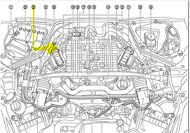

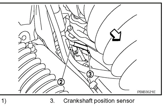

The reason I asked about the RPM's is because if the crank sensor stops sending a signal, you will lose spark. Also, the RPM signal would be lost. Check the wiring to it. The sensor itself may be going bad. Take a look through this link:

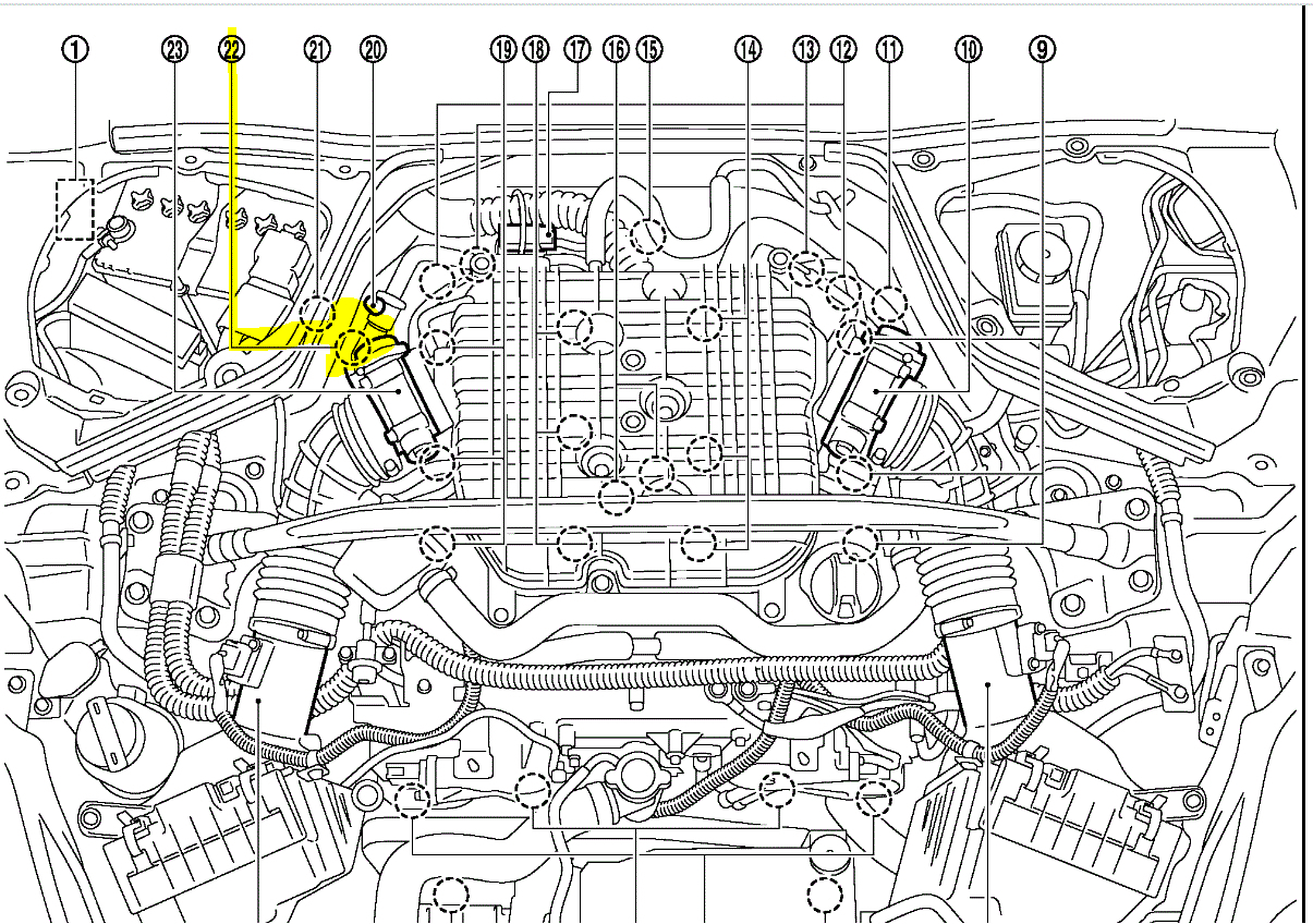

Interestingly, a faulty sensor may not set a code. I attached a pic below of the sensor location. It is a bit vague. LOL Let me know if it helps.

That pic is vague haha. I’ll find it though. This does make sense because it is after the car is up to temperature when it starts cutting out. And that’s really what it feels like is that the engine completely shuts off and turns back on. I don't know if I mentioned though if I accelerate hard it will not do it or at least not noticeable. I will check out the sensor tomorrow when I have daylight though.
Tuesday, August 18th, 2020 AT 9:09 PM
  • 109,885 POSTS
It's below the bank 1 throttle control actuator. Here is another pic that may be more helpful.
Per Alldata:
"The crankshaft position sensor (POS) is located on the oil pan facing the gear teeth (cogs) of the signal plate."
