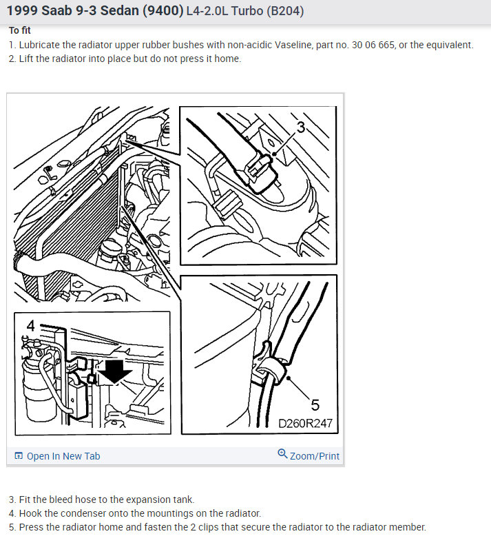

Hi. My car expels coolant, apparently it needs a new radiator. While I have the part on order if I drive 4-5 miles and switch the engine off is that okay before it reaches the red zone (hot), will that cause any damage?
I see a great DIY on replacing the radiator here that I intend to follow. In the meantime I need to find a job.
Sep 17, 2021 at 1:36 AM
SQM
  • 6,383 POSTS

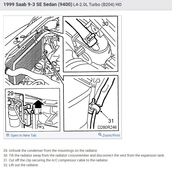

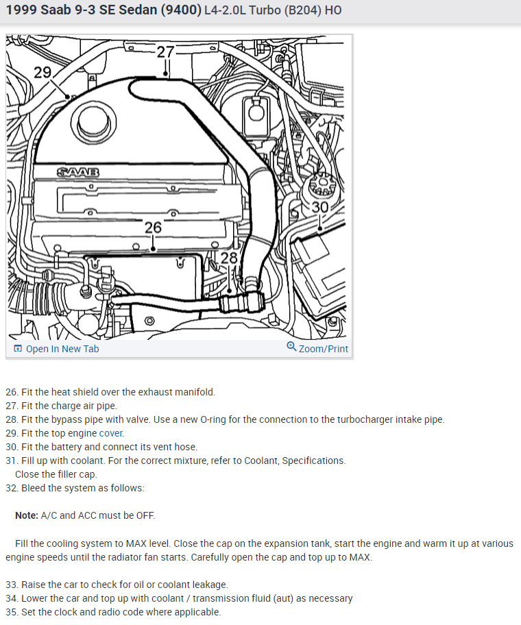

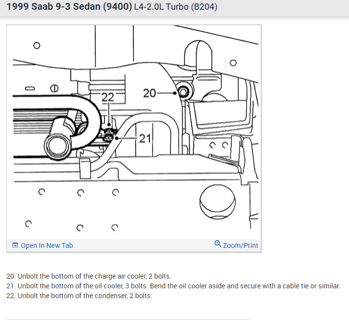

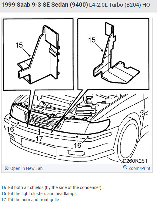

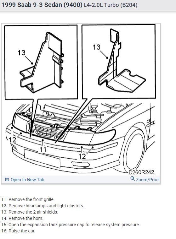

It all depends on how fast the coolant leaks out of the radiator.
One thing you have to keep in mind that if there is low/no coolant in the engine or has a large air pocket, it can create hot spots inside the engine. That can permanently damage the engine.
So it depends on your exact situation. You always run a risk of doing internal damage if the engine overheats. As the engine can overheat very fast if there is not enough coolant.

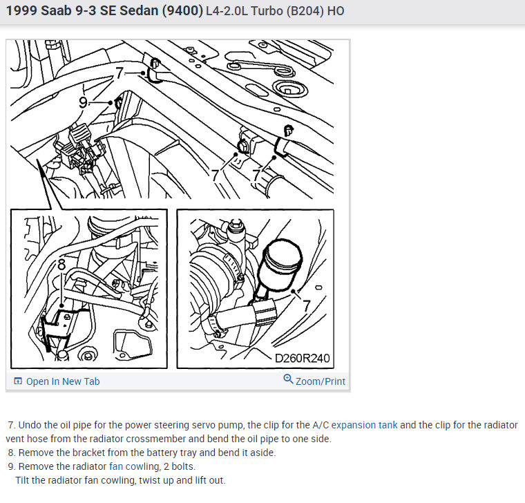

https://www.2carpros.com/articles/how-to-replace-a-car-radiator
https://www.2carpros.com/articles/coolant-leak-symptoms
I have attached the replacement procedure for your reference.
Please let know of any questions.

Got it. Can you see where it is leaking coolant?
Coolant can leak from any of the components, like the radiator, coolant hoses, water pump or thermostat housing etc.
If the radiator is leaking then you will have to replace it.
But first step to fix the leak then see if you still have a over heating issue. If it was only overheating for being low on coolant then that issue will be fixed.
Sometimes doing a pressure test can help.
https://youtu.be/W8kra65m15c
Sep 20, 2021 at 1:24 AM
TEEOHDOUBLED
  • 60 POSTS
Pressure test was done at local shop. It's the radiator, and I will order a replacement. We can close this thread. Thank you!

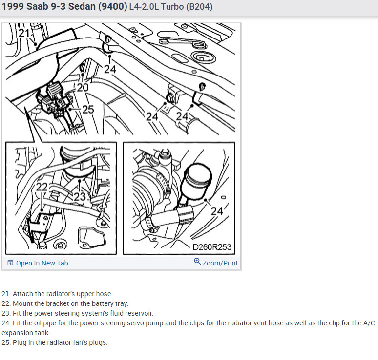

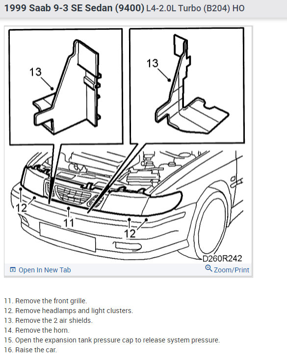

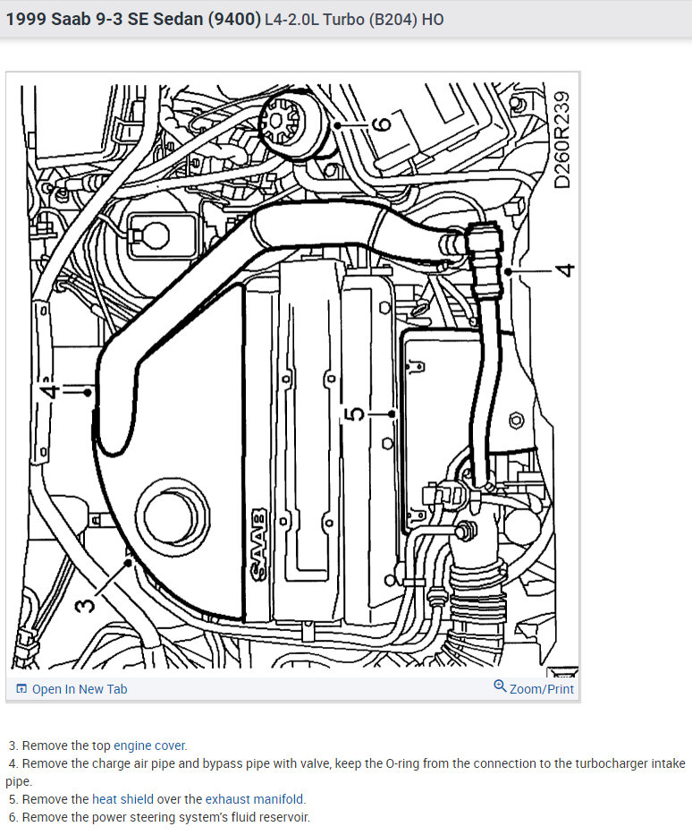

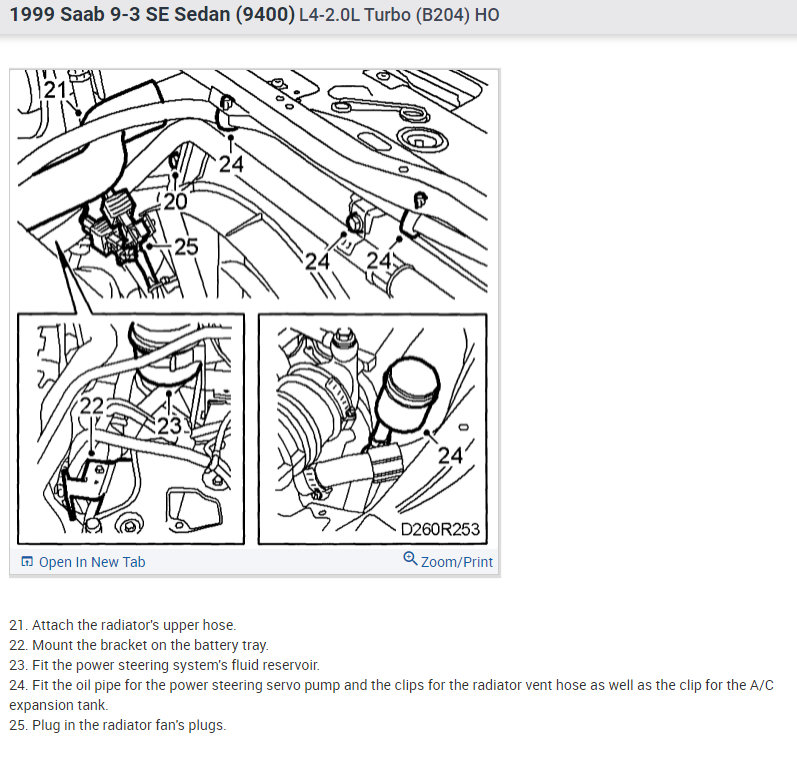

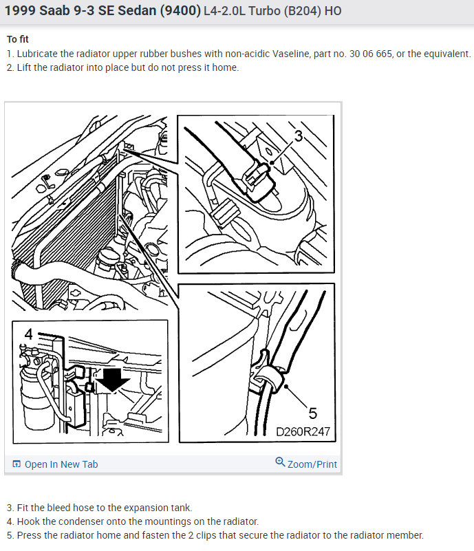

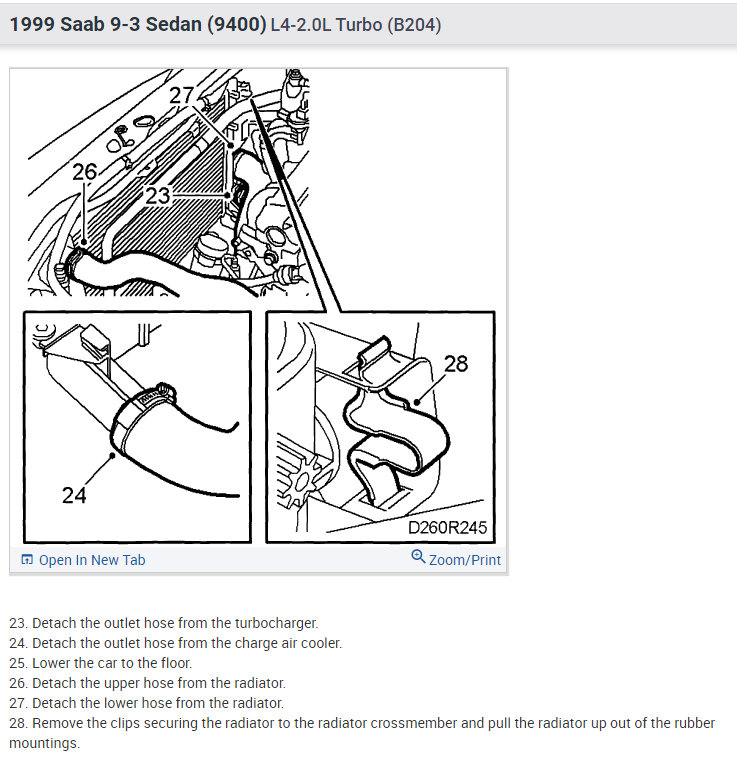

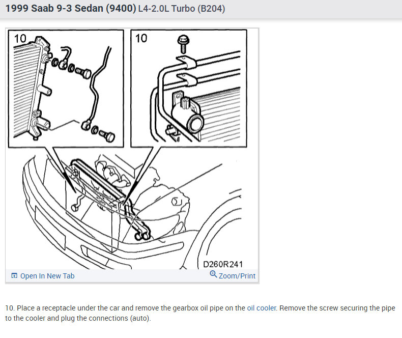

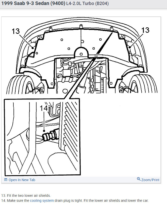

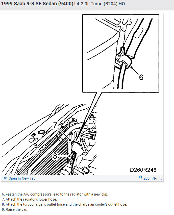

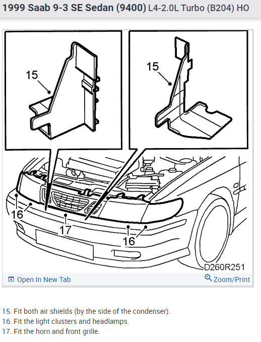

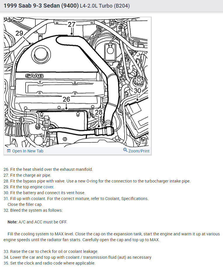

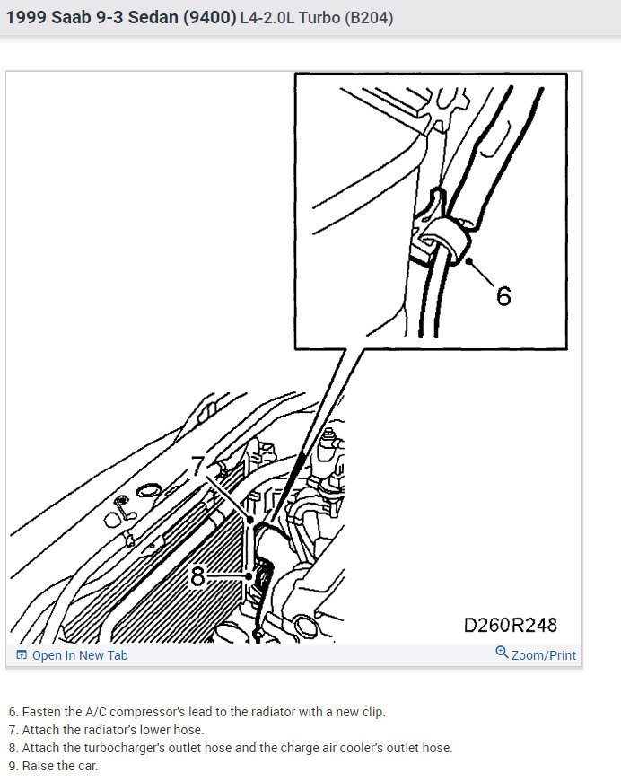

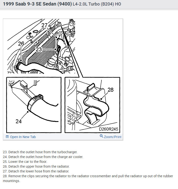

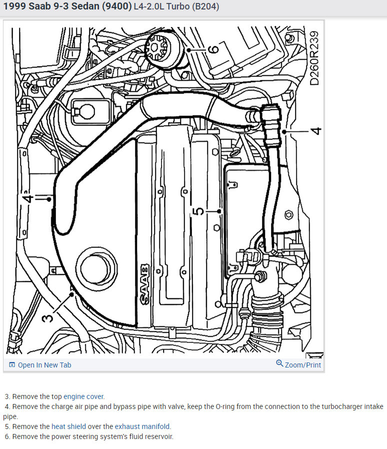

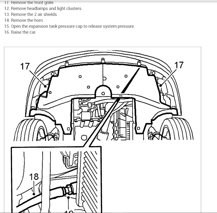

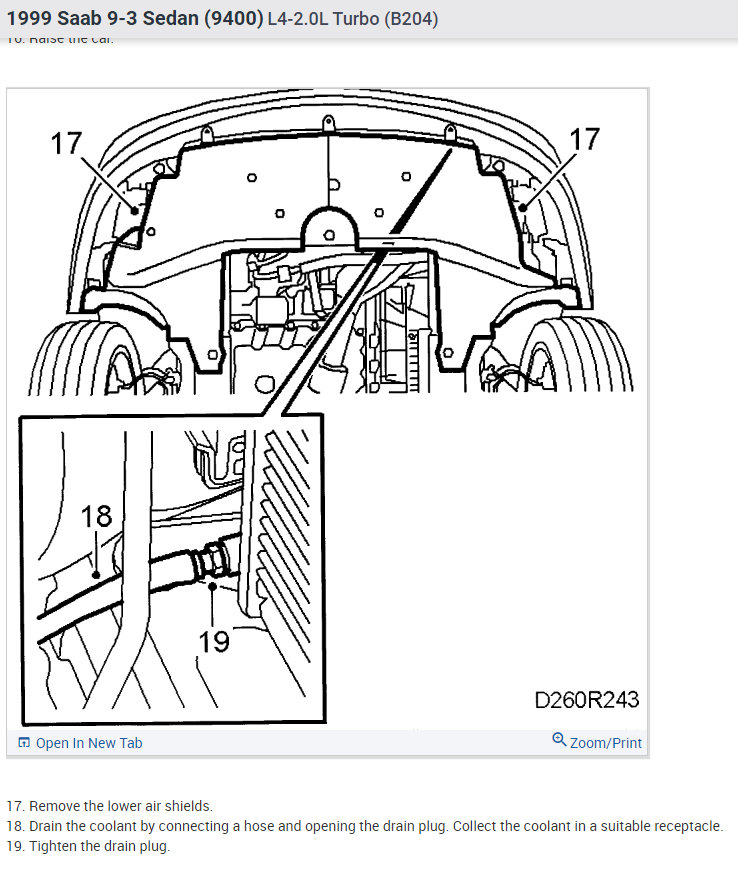

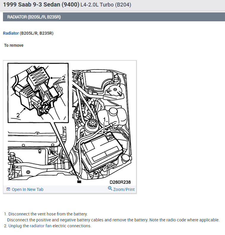

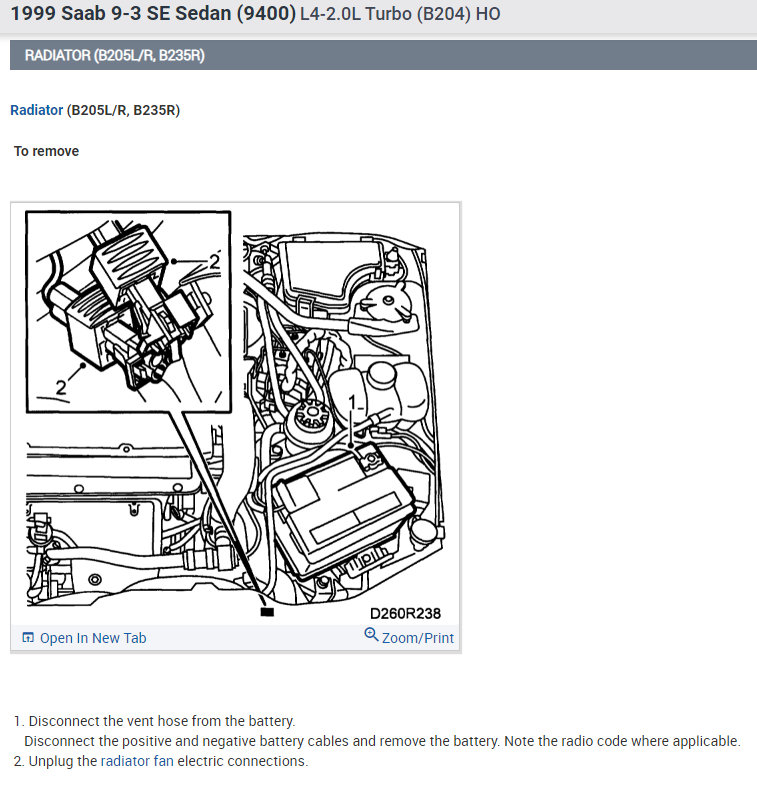

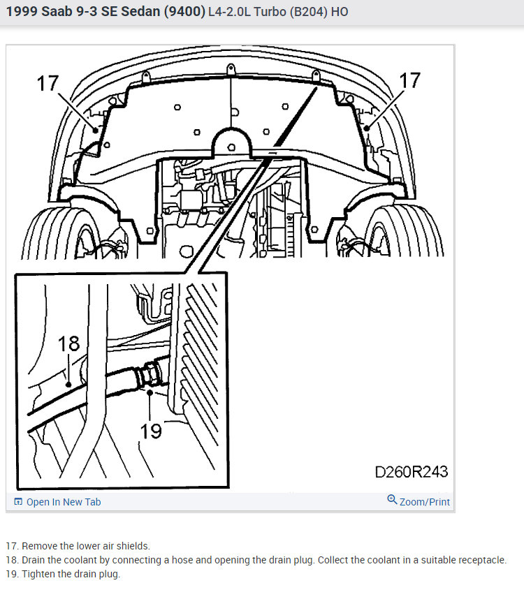

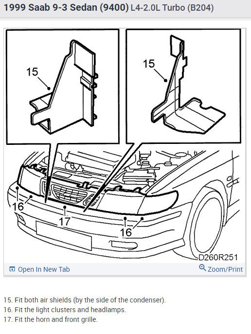

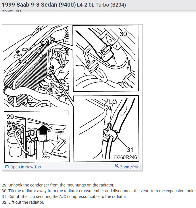

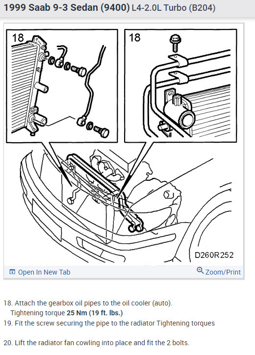

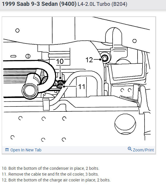

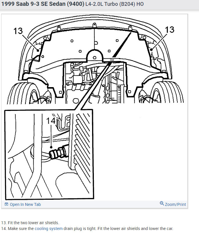

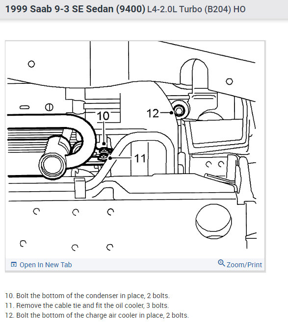

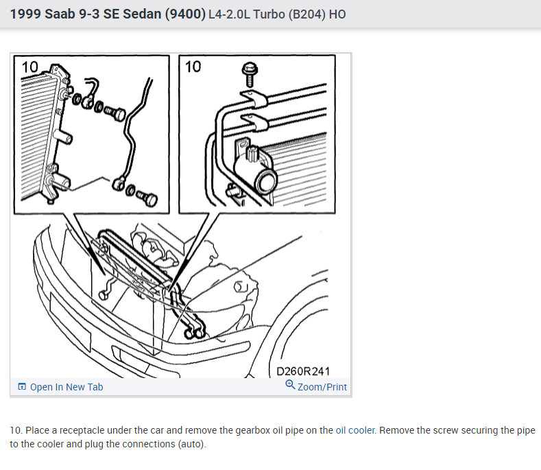

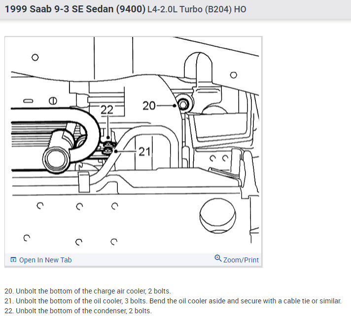

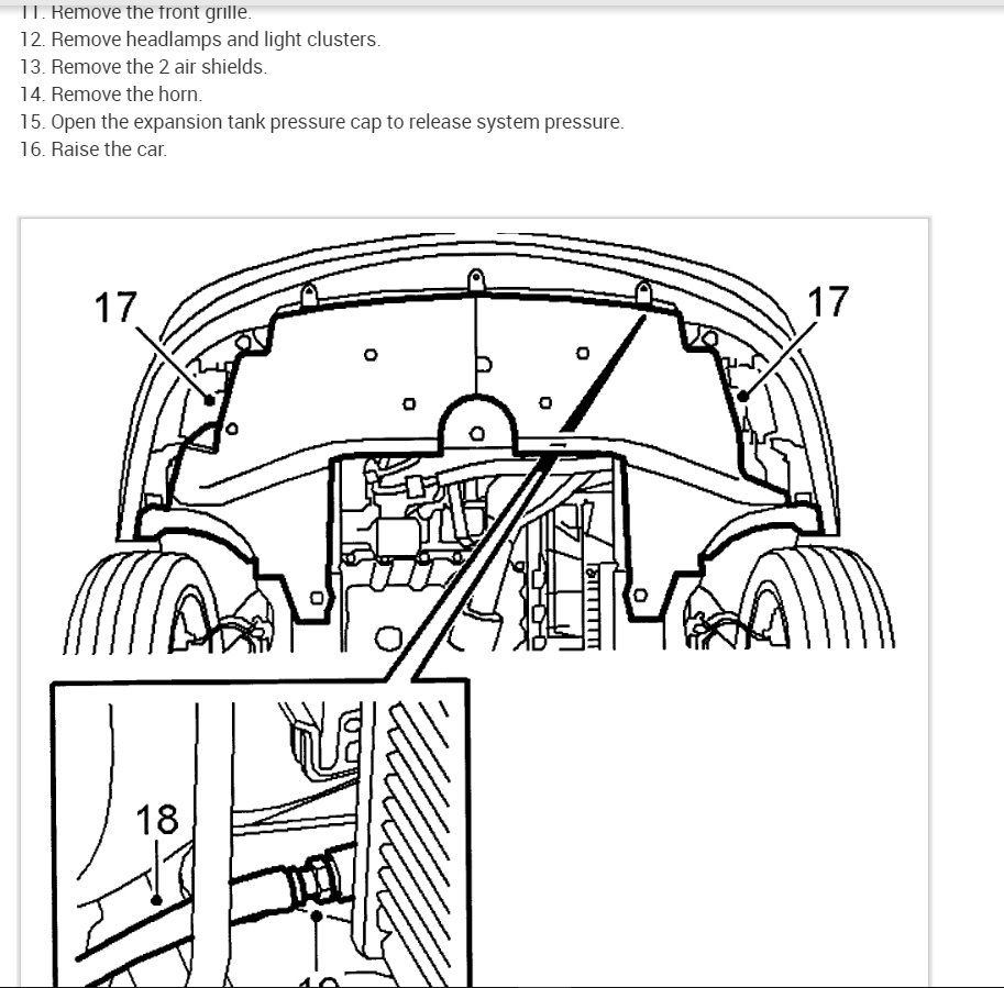

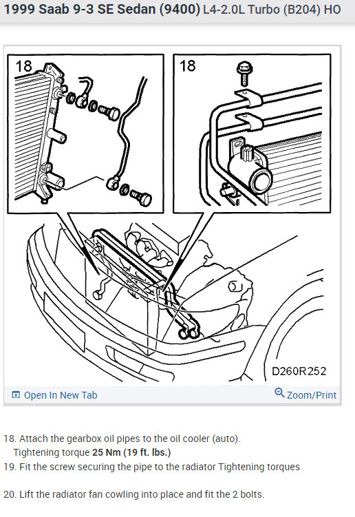

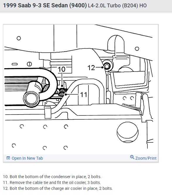

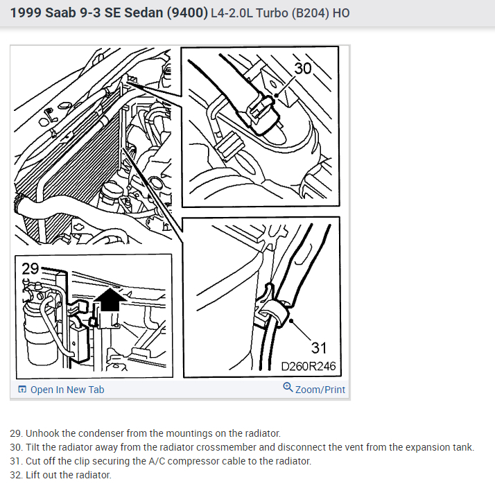

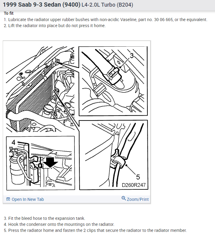

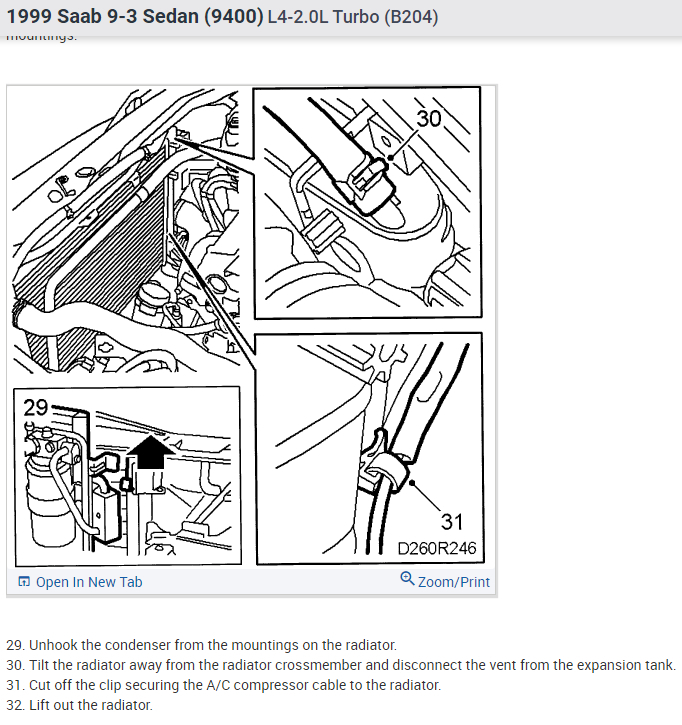

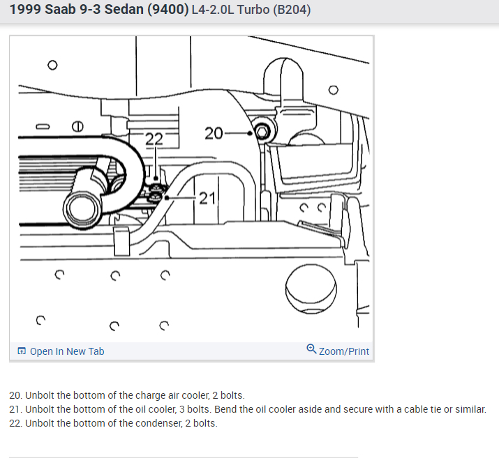

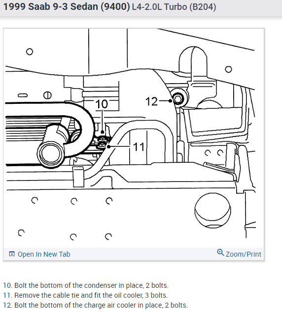

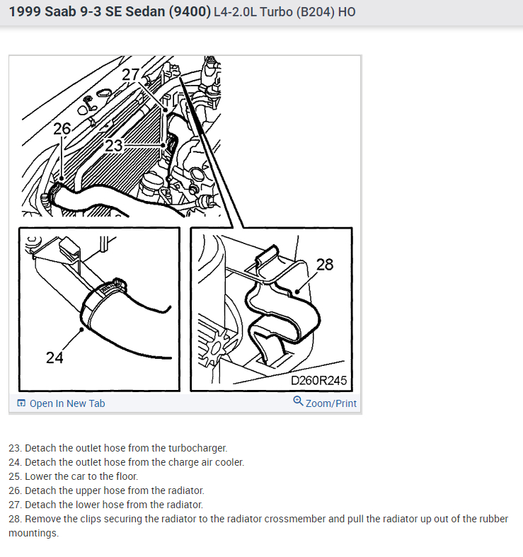

Hi. Please be sure not to cut off the diagrams you provide. I have to do this all by myself and need to rely on you for clear images and instructions. Some of your attachments are skipping numbered steps or have been enlarged cutting off vital information.
Oct 4, 2021 at 12:38 PM
SQM
  • 6,383 POSTS
These were direct copy from All Data. Can you tell me which diagram you have issues with?
Oct 4, 2021 at 2:01 PM
TEEOHDOUBLED
  • 60 POSTS
I can't attach too many examples. This is re-work for me and it's very slow to upload.
Oct 5, 2021 at 12:31 AM
SQM
  • 6,383 POSTS
I was unable to see what was missing from the original instructions. So, I just went ahead and freshly uploaded the complete instructions for the radiator replacement procedure. Let me know if you have any questions.
Oct 5, 2021 at 3:26 AM
TEEOHDOUBLED
  • 60 POSTS
Thanks for that, but you really don’t see in my example how the bottom is cut off and the numbered instructions don’t match the parts illustrated? It’s not a network issue here either, I have very good signal strength/high-speed internet.
Oct 5, 2021 at 3:49 AM
SQM
  • 6,383 POSTS
Not sure why you are having this issue.
As the instructions that I have uploaded is the complete radiator replacement instructions for that Saab.
If you want, I can perhaps just upload the numbered instructions? As you say you can see the diagrams, right?
Oct 5, 2021 at 4:13 AM
TEEOHDOUBLED
  • 60 POSTS
You’re good though with the last upload you gave me. That set is perfect. I was referencing what came through previously. Thanks again!

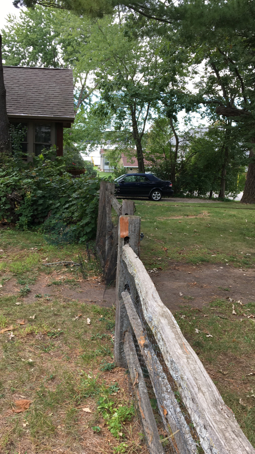

I thought I would throw this last question in with some pics. I’d just like any suggestions you may have on creating a safe and efficient workspace. I’m on a lot of dirt and rocks. I have to do as much of my own work as I can here. Is there anything to make a more solid foundation?
Oct 5, 2021 at 10:33 AM
SQM
  • 6,383 POSTS
Ideally you want to make sure that the surface is flat and stable.
When you jack up the vehicle you want to make sure that the jack will not sink into the ground. Keep in mind that small rocks under a jack / stand can make it unstable as those rocks can move easily.
If you can put down brick in a stable and uniform manner it can help. It's all about having a solid foundation that will not sink or move while the vehicle is lifted.

I owe you guys an apology. I referenced an old write-up and set of instructions that I had come across that are slightly different than what you provided me. Those are the ones that got me confused and didn't show numbers matching the photos: https://www.2carpros.com/questions/saab-9-3-1999-saab-9-3-1999-saab-9-3-removal-radiator
