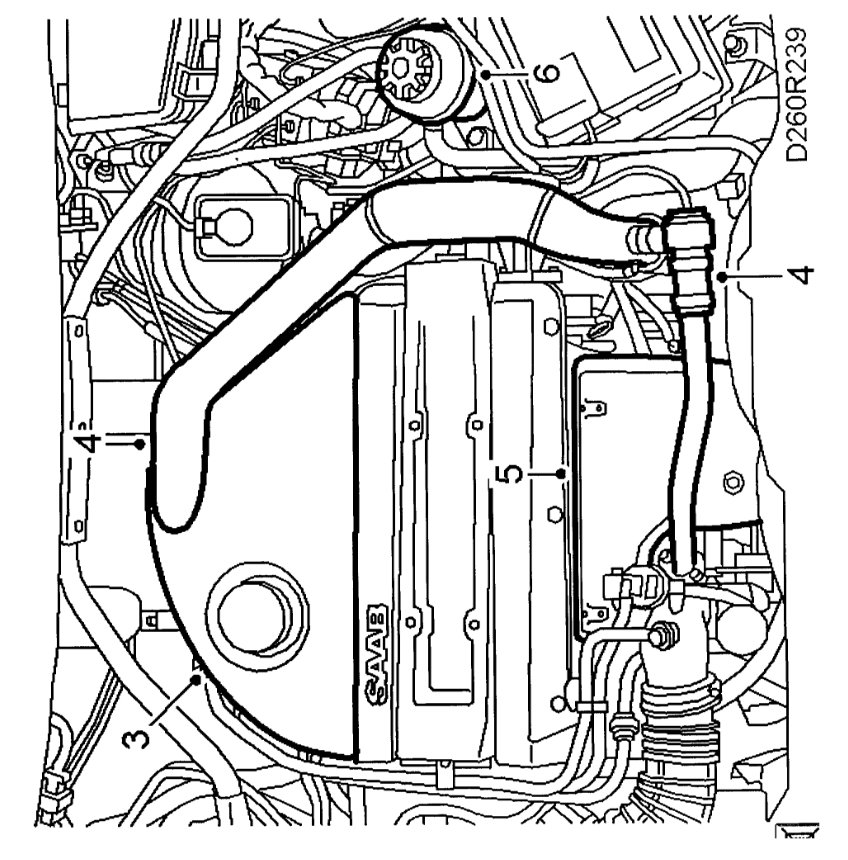

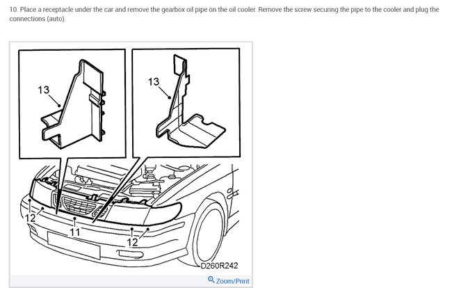

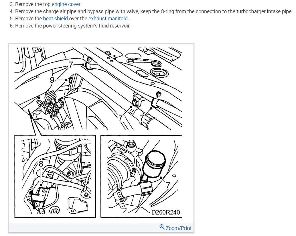

I can not figure out how to get Radiator out of the car?
Nov 3, 2010 at 7:58 AM
BLUELIGHTNIN6
  • 16,542 POSTS

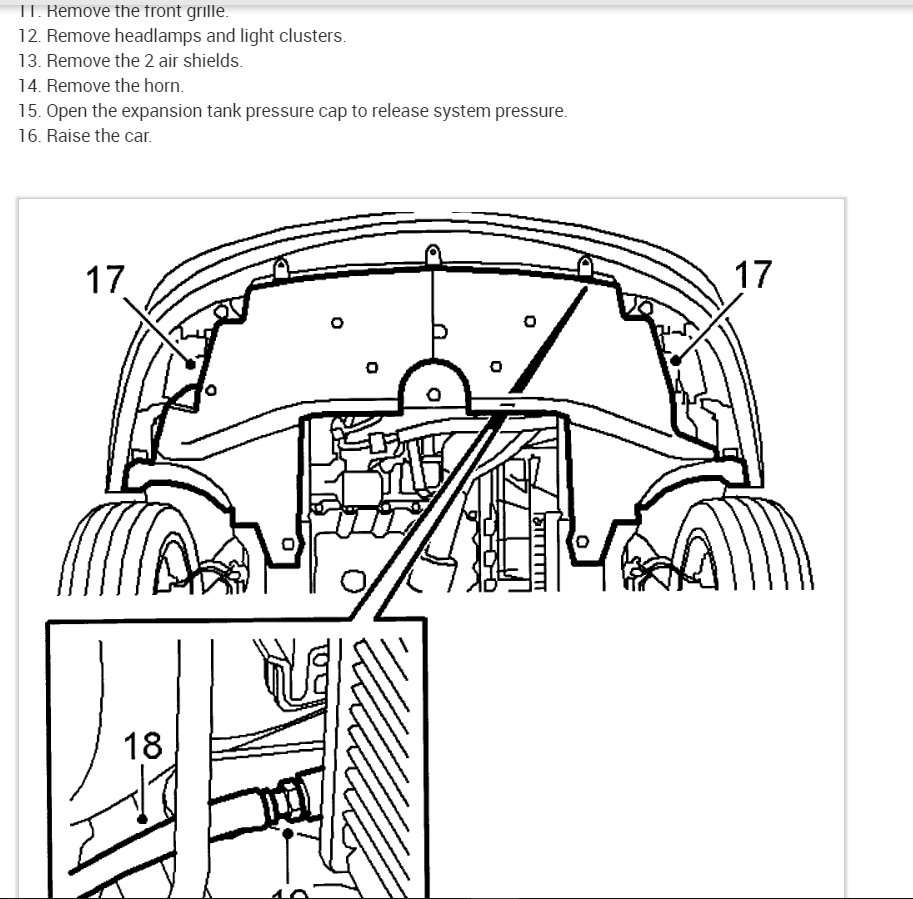

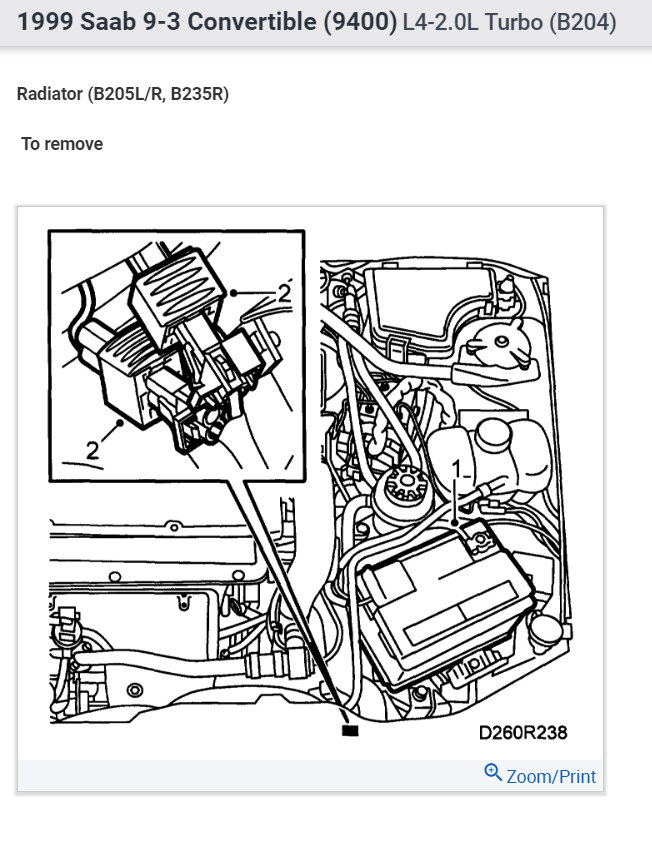

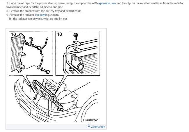

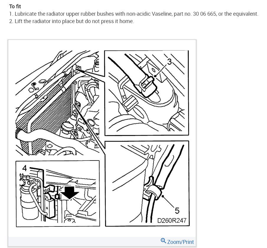

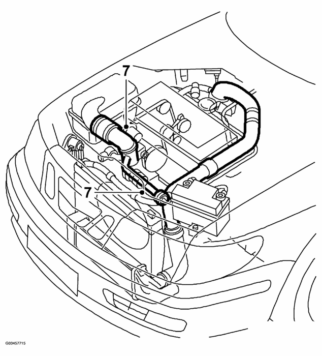

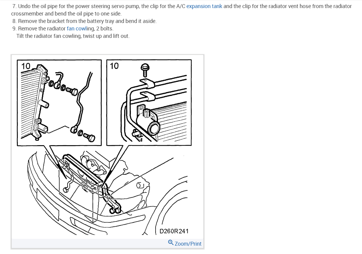

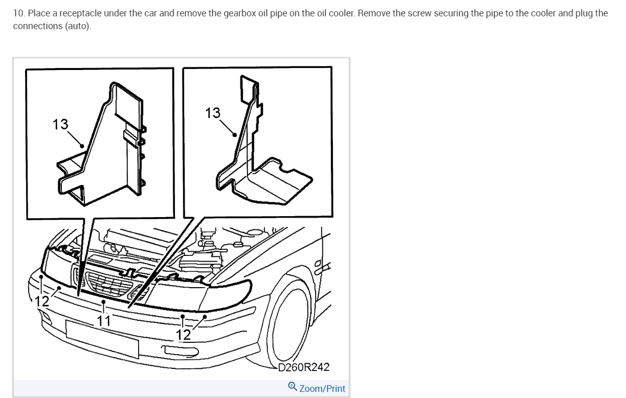

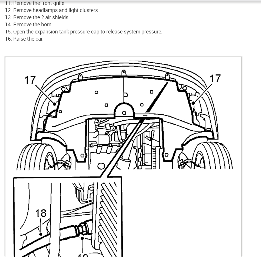

Here is a guide to show you step by step how to replace the radiator and the diagrams below to help you see what it will be like on your car.
https://www.2carpros.com/articles/how-to-replace-a-car-radiator
Cheers
Nov 3, 2010 at 11:57 AM
FBILDER
That you so much I did it but it took all day ;) cost me $147.00 for the radiator.

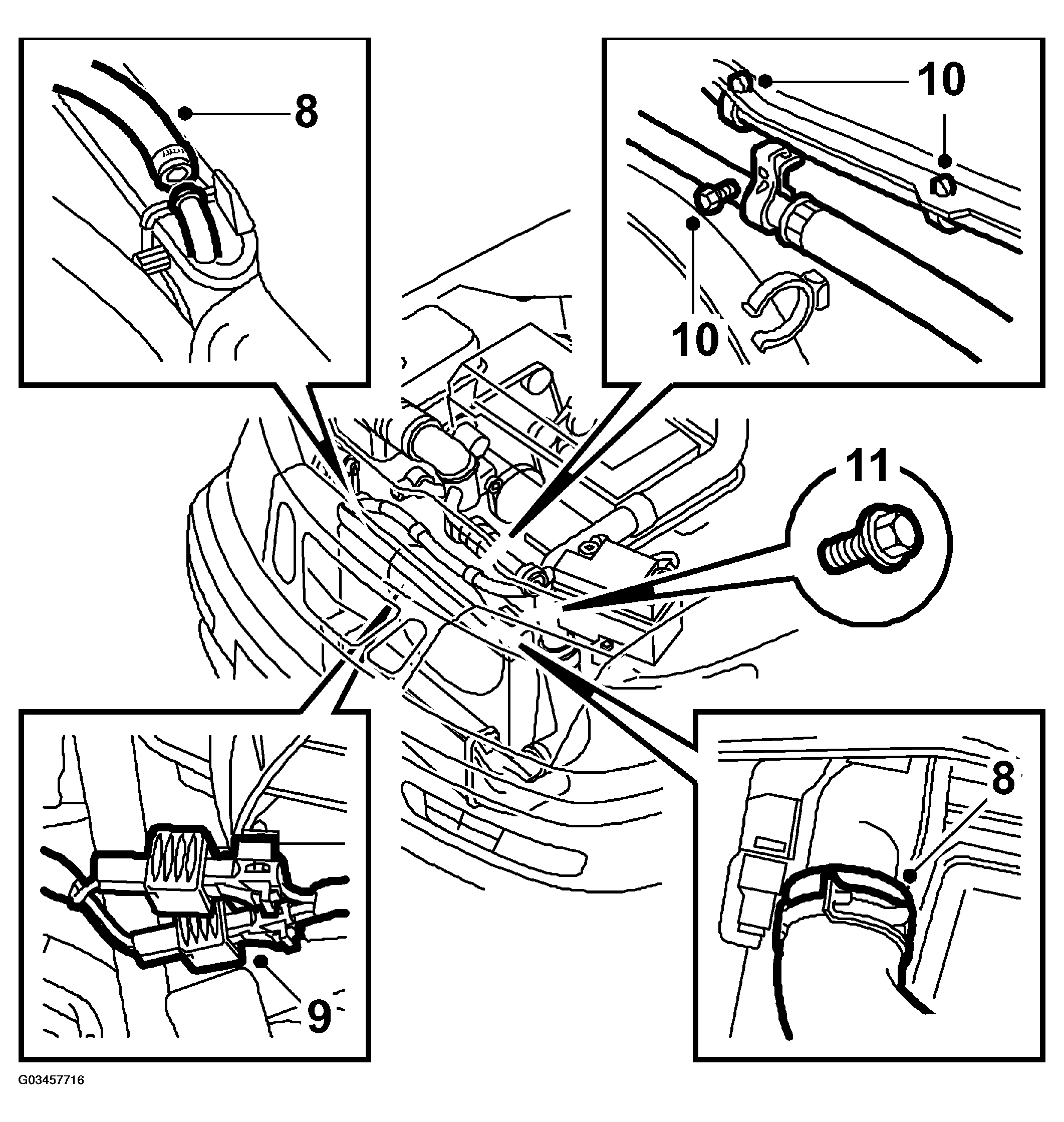

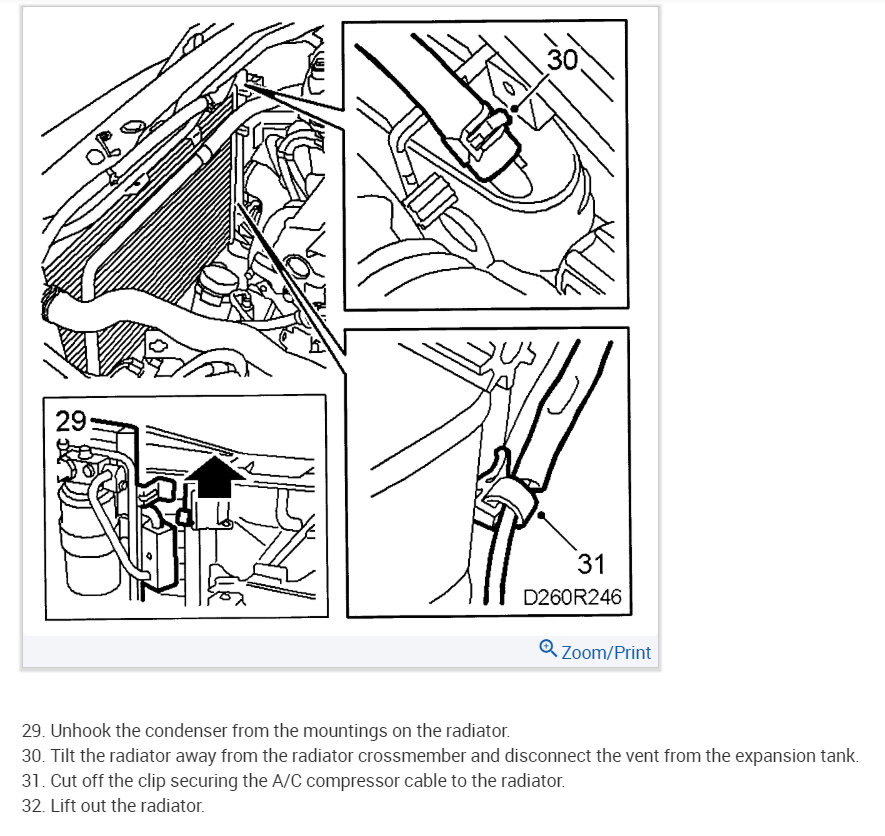

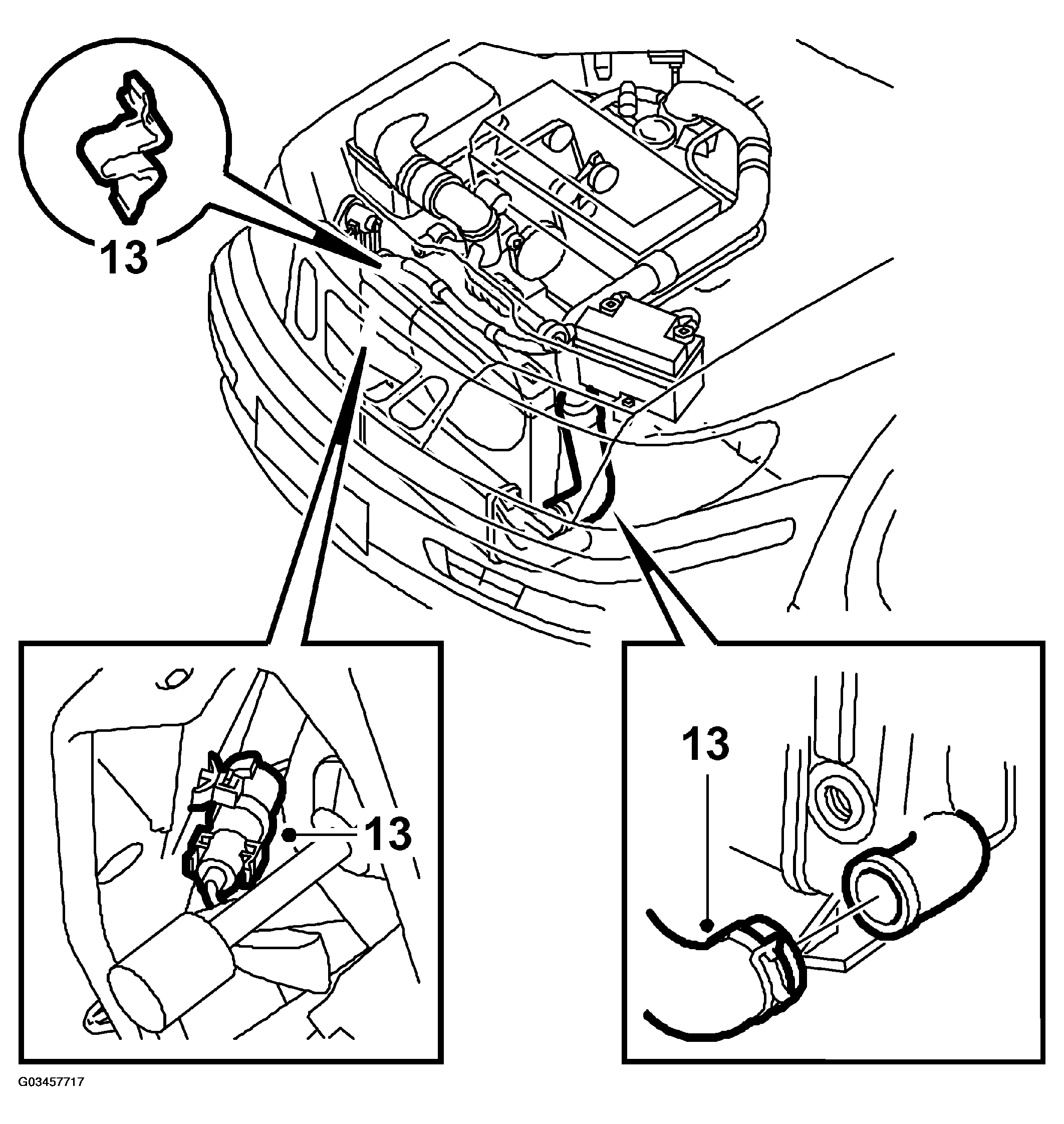

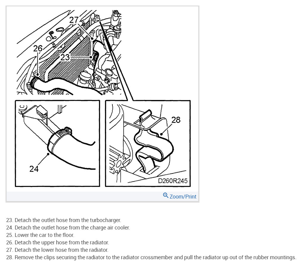

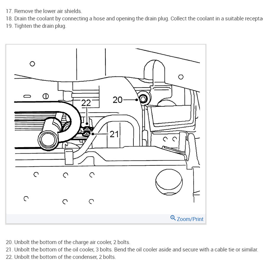

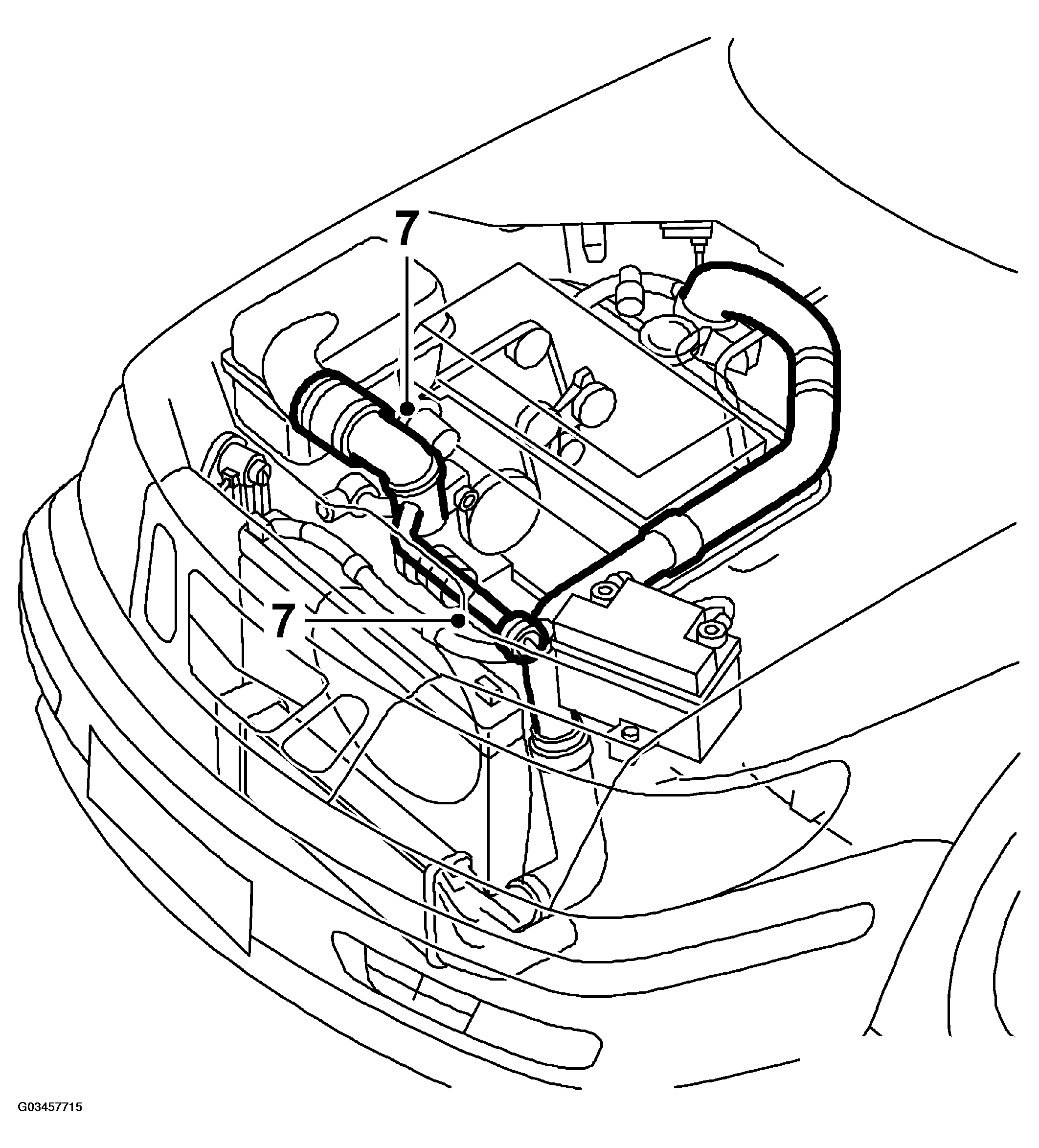

I have a the car listed above it is a turbo, automatic. i read the solution here and well here is how it went. I took off the air filter hose, the radiator fan and shroud (did it in one try they are both connected) unbolted the two bolts for the oil and the radiator hoses, took off the two clips, and when i tried to take the radiator off it just will not do it. moves but cannot take it off where the rubber mounts are secured by the two clips.
if there are any pictures of a step by step that would be great.
Aug 25, 2018 at 11:46 AM (Merged)
DOCFIXIT
  • 18,828 POSTS
You should drain the radiator before you begin. Here is a guide that will help you get started and see what you are in for when doing the job:
Here are some diagrams of your car (below).
