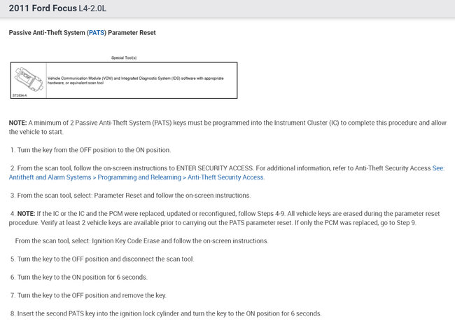

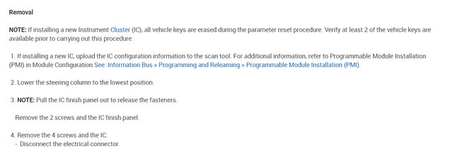

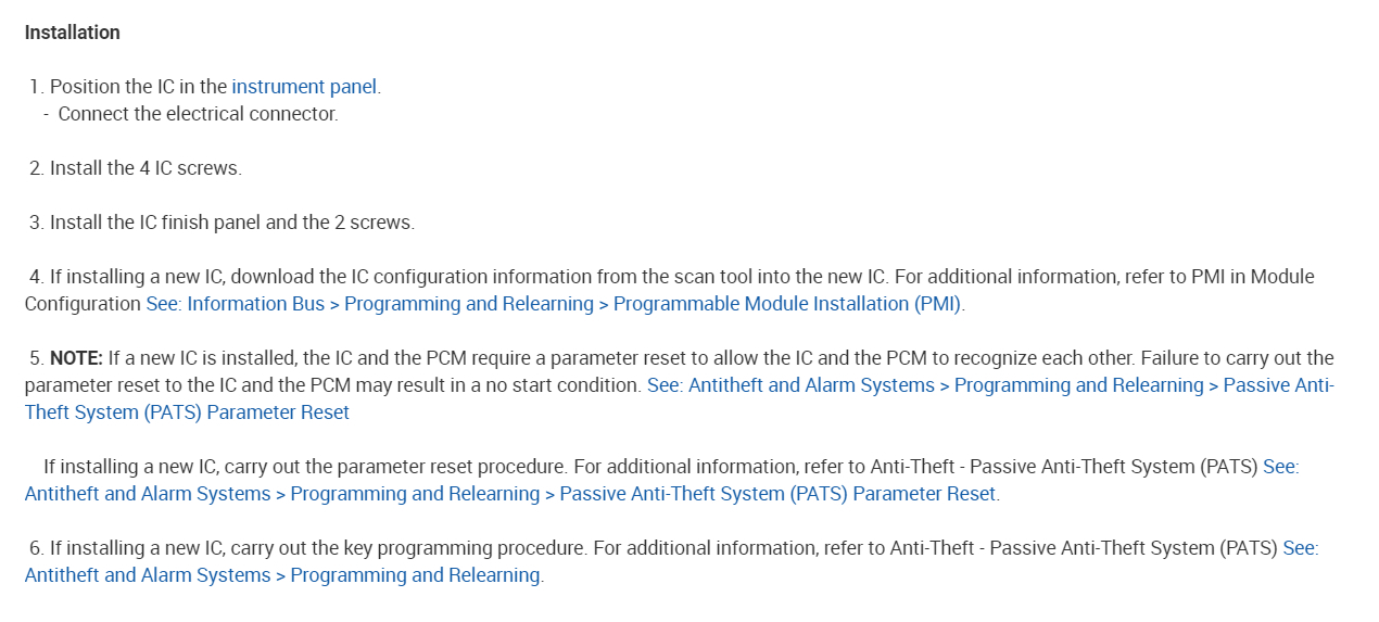

i switched my instrument cluster on my 2011 Ford Focus 4s now my car won't start, and my anti-theft light is blinking.
Feb 25, 2023 at 2:36 AM
  • 55,399 POSTS

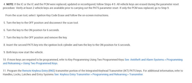

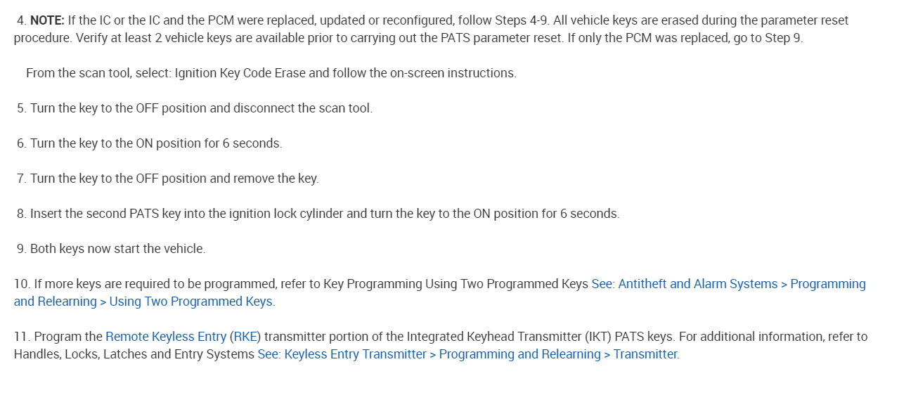

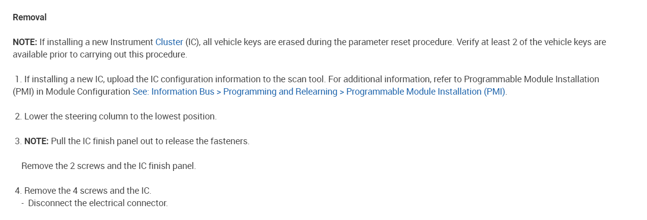

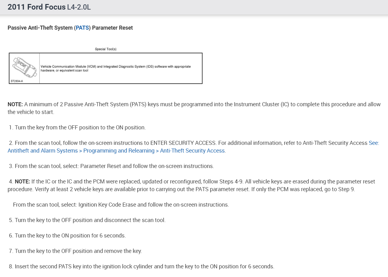

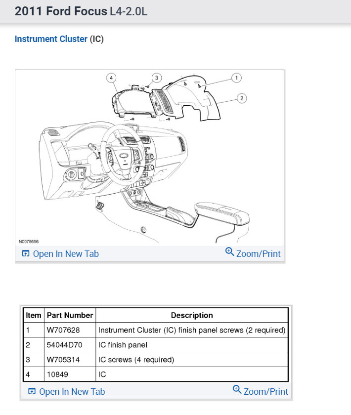

The IC needs to be programed to the car before installation FYI. Let's help confirm the problem by doing a CAN scan which is easy and the scanner is reasonable, here is a video and guide to help. You can get a CAN scanner (Controller Area Network) from Amazon, here is a video to show you how. You can get a preprogrammed cluster by searching google or eBay.
https://youtu.be/u-4syLc-ifQ
and

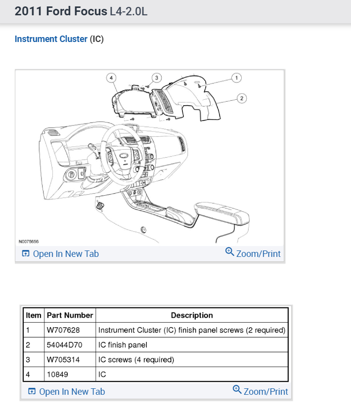

Here is information on the instrument cluster in the images below. Please let us know what happens.
