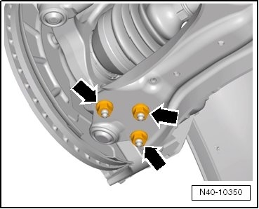

Have a bad popping when cut wheel deep and back out so on. So just bought ball joints and axles, even though there’s no slack. need instructions step by step on how to change both and size tools I need.

Here are the directions for removing the axle. The directions include removal of the lower ball joint. Tools needs are listed first. I will tell you that some of the axle nuts are a 32mm and others require an internal allen socket, which if I recall is 17mm. The nuts that hold the ball joint in place could be a 10mm or 13mm bolt. Truly, if they have ever been changed, different manufacturers supply new bolts and they come in different sized.
Here are the directions and the pictures attached correlate with the directions:

- Loosen the wheel bolts.
- Raise the vehicle.
- Remove the wheel.
- Remove the lower noise insulation.

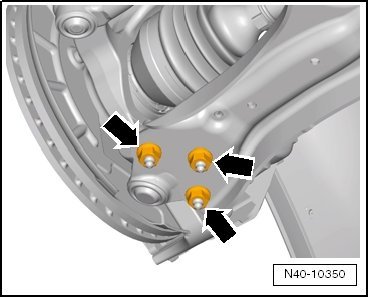

- Remove the nuts - arrows -.
picture 1
- Remove both the wheel bearing housing and ball joint from the control arm.
- Pull drive axle out from wheel hub and secure it to body.

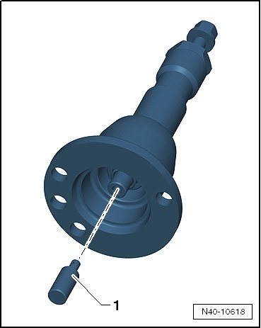

If the Drive Axle Cannot Be Pulled out of the Wheel Bearing, Then Drive Axle Can Be Pushed Out of the Wheel Bearing Using the Drive Shaft Remover (T10520).
Before using the Drive Shaft Remover (T10520) , make sure that the thrust piece - 1 - is installed.

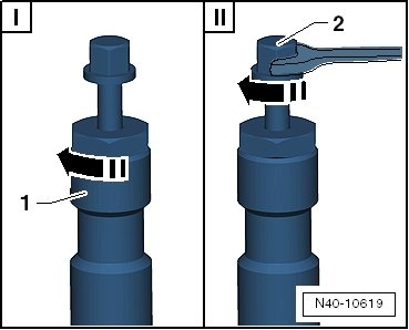

Using the Drive Shaft Remover (T10520) :
picture 3

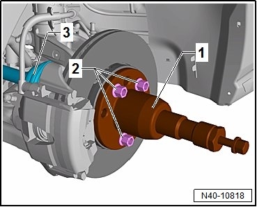

- Secure the Drive Shaft Remover (T10520) - 1 - with three wheel bolts - 2 - on the wheel hub, so that the drive axle - 3 - can be pressed out.
- Follow the specified sequence.
picture 4
I Tighten the knurled nut - 1 - hand-tight.
II Only turn the bolt - 2 - using a wrench and press out the drive axle using the Drive Shaft Remover (T10520).
At the end of the tasks or to set back, the spindles must be brought back into the original position so that the hydraulic operation can be used.

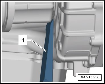

- Place the Drive Axle Wedge Tool (T10161) - 1 - between the transmission housing and the triple roller joint.
- Using a rubber hammer, hit the inner joint on the Drive Axle Wedge Tool (T10161) and remove it from the transmission.
- Remove the drive axle.

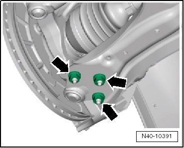

- Attach the ball joint to the control arm - arrows -.
picture 6
Make sure the ball joint boot is not damaged or twisted.

As far as the axle puller, you should be able to get it out without one. Don't strike the axle with a metal hammer. If the axle doesn't want to move, I have gently bumped the axle inward from the hub using an air impact hammer. If you just bump it a couple times with that, it should come out for you.
