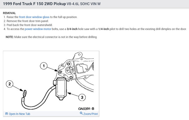

I have watched every video on installing the window motor and going through the speaker hole with the new motor in hand. Not on my 99', I can just squeeze the motor in through the speaker hole past the window frame but can't get my hand and the motor in far enough to set it in place. Do I have to take the window assembly out?
Sep 12, 2023 at 2:01 PM
  • 55,433 POSTS
No, the window can stay in the truck just tape it in the up position once disconnected from the regulator. To access the power window motor bolts, use a 3/4-inch hole saw with a 1/4-inch pilot to drill two holes at the existing drill dimples on the door. Check out the images (below). Let us know what happens and please upload pictures or videos of the problem so we can see what's going on.

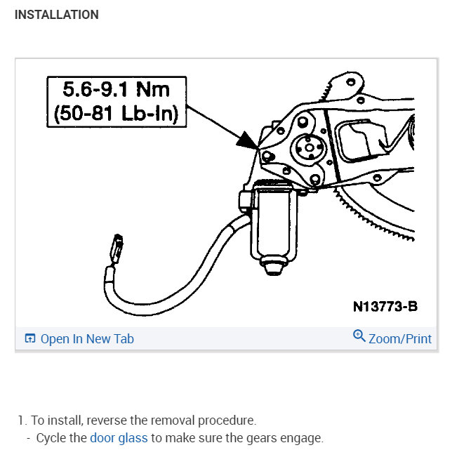

No I didn't remove the regulator at the same time, that's what I wanted to know, if I have to remove both and to do so, do I drill out the rivets to get it out?
Sep 15, 2023 at 10:17 AM
  • 55,433 POSTS
Yep, that is what needs to be done and be careful because the regulator is spring loaded.

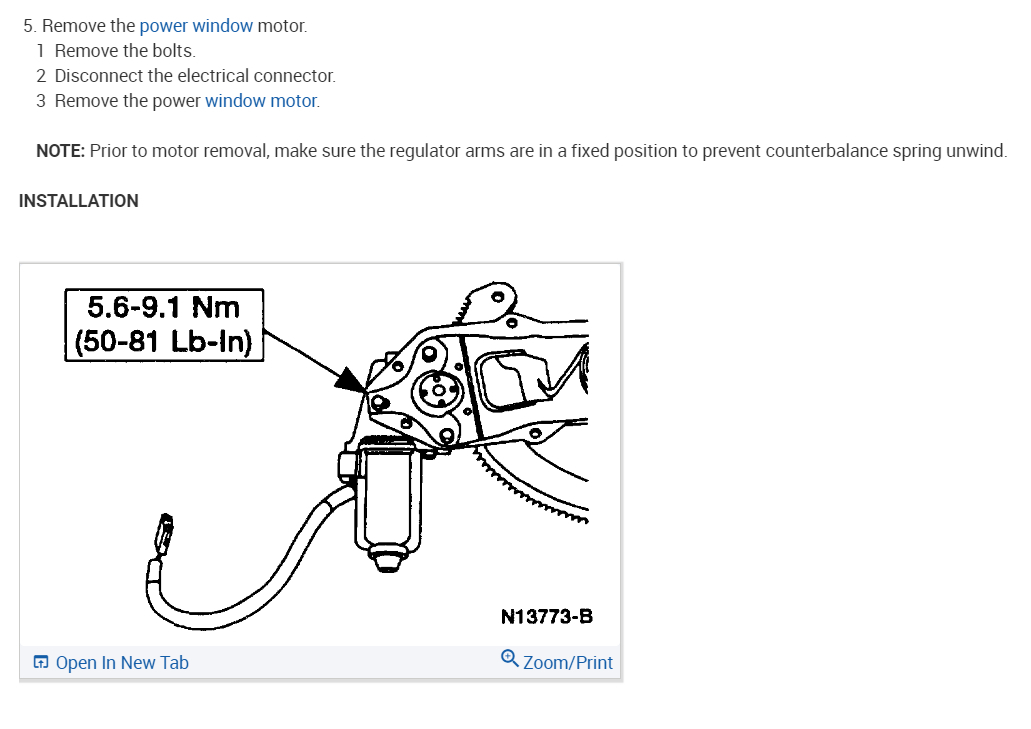

Thank you Ken, when you say be careful when removing the regulator do I need to keep the regulator spring from unloading or what do I need to do when removing it?
Sep 18, 2023 at 12:51 PM
  • 55,433 POSTS
Yes, you need to hold the regulator while taking the motor off because the spring will unload. You might need a helper or a pair of vise grips etc.
