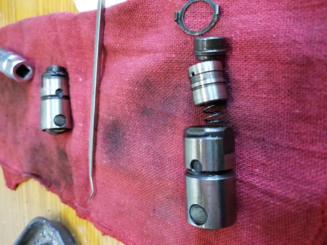

So this is one I took out of old head. How do I tell if they r working correctly?

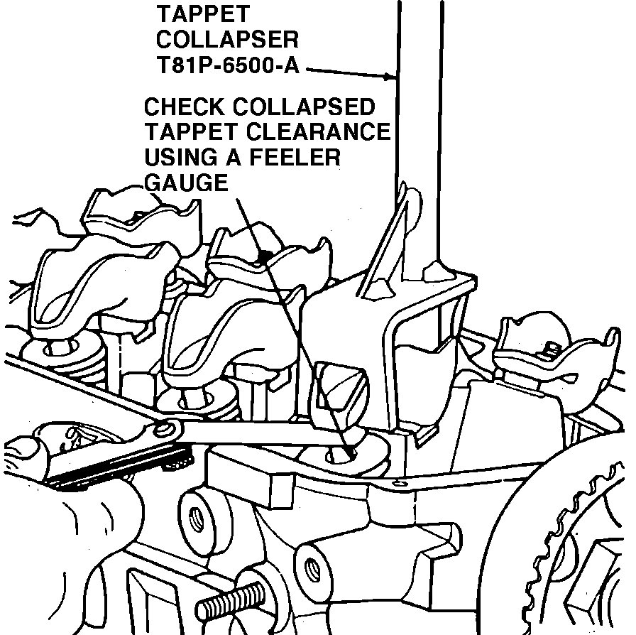

Oh and I can't seem to find a feeler gauge that goes up to 4.5mm , did you mean .045mm instead?
May 10, 2019 at 10:31 AM
STEVE W.
  • 15,295 POSTS
The clearance issue is to be sure that the oil hole is lined up with the passage in the head. You compress the lifter in the head which pushes the oil out of the lifter. It will take a couple seconds. Then you check the clearance. The clearance between the valve and rocker will tell you if the hole is lined up okay. 4.5mm of clearance means the hole is below the oil passage when it is on the base circle of the cam. 2.2mm should put it about in the middle. If the holes position is wrong it will not get oil and you will have valve clatter because the lifter will not be under the oil pressure when it starts to move the rocker.
May 10, 2019 at 1:42 PM
RANDY ARWOOD
  • 28 POSTS
To be clear, do I need to make sure every cylinder is at TDC when I check the valves for that corresponding cylinder?
May 10, 2019 at 2:43 PM
STEVE W.
  • 15,295 POSTS
2. Position Tappet Collapser T81P-6500-A on the rocker arm. Slowly apply pressure to bleed down the valve tappet until it is completely bottomed. Hold the valve tappet in this position and check the available clearance between the rocker arm and the valve stem tip with a feeler gauge.
The collapsed valve tappet gap, when the cylinder head is on base circle, should be as follows:
Minimum: 0mm (0.000inch)
Nominal: 2.2mm (0.087inch)
Maximum: 4.5mm (0.177inch)

3. With the No. 1 piston at the TDC end of the compression stroke (Position No. 1), check the following valves:
- No. 1 Intake Valve, No. 1 Exhaust valve.
- No. 2 Intake Valve.
4. Rotate the crankshaft to position No. 2 (cyl 3 at TDC)and check the following valves:
- No. 3 Intake Valve, No. 3 Exhaust valve.
5. Rotate the crankshaft another 180 degrees from position No. 2 back to TDC (cyl 4 at TDC) and check the following valves:
- No. 4 Intake Valve, No. 4 Exhaust Valve.
- No. 2 Exhaust Valve.
May 10, 2019 at 2:57 PM

I found all within tolerance, but cylinder 2. intake was very easy to leave down compared to the rest of them. it was as if there was no oil in it to compress out with the tool. Could this be my issue?
May 24, 2019 at 9:03 AM
STEVE W.
  • 15,295 POSTS
Yes. Without oil in it the lifter will collapse under the pressure of the valve spring. I'd remove it and open it up to see if some dirt/debris is blocking it. Worst case you could buy a new lifter to install if you find nothing.

Can I use old one from old head to test?
May 24, 2019 at 10:35 AM
STEVE W.
  • 15,295 POSTS
In theory yes, but I wouldn't because there is a chance the roller has an odd wear pattern and could hurt the cam in the new head.

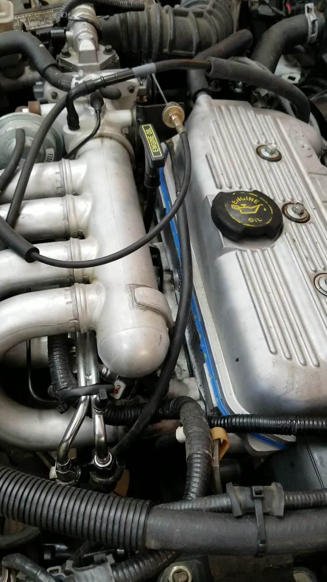

I called the company who rebuilt the head and they sending me four new tappets, couldn't get them to send eight. In the mean time I removed all the tappets, cleaned and reinstalled and still have same tick tick noise. I'm a try and upload video, tell me your thoughts.
May 28, 2019 at 6:51 AM
STEVE W.
  • 15,295 POSTS
Yeah that is some serious valve train noise.

I couldn't wait, I pulled all 8 tappets from the old head, disassembled,cleaned and used all to replace the ones that came in the new head. Started car and noise went away in about two minutes, after they pumped up with oil. So it is definitely a bad tappet or a few. How do I tell which one is failed or I guess I just write all 8 off and get all new ones?

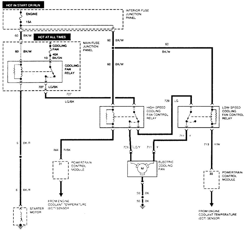

I have no more valve-train noise at this point. What I do have is a bad PCM not controlling the cooling fan as it should, I've checked both relays high and low fan and checked the fan, only thing left is the PCM. I am not getting signal to the relay to switch from the PCM. So I have a PCM on order. The low speed fan comes on when ac is turned on but will not actuate otherwise. Really confusing to explain but I believe I have narrowed it down. Thanks for all the help

So the PCM isn't grounding at pin 31 to turn on the high speed relay? That system is sort of common. The fan is a 2 speed unit. Apply 12 volts to the Yellow lead and it runs on low, remove that and apply 12 volts to the Light green/ yellow stripe and it should spin up on high. The PCM should show a ground at pin 35 and pin 31 when the coolant temp hits 230 F
That turns on both relays, the low speed switches to an open circuit while the high speed relay switches power to the other terminal of the fan for high speed.
Jun 2, 2019 at 11:17 AM
RANDY ARWOOD
  • 28 POSTS
Yes, I have jumped both high and low and both work. Pin 31 for high speed never becomes grounded. Even when AC is switched on. Pin 35 stays grounded all the time keeping the relay open and not allowing power to get to the yellow wire for low speed. When the AC is kicked on pin 35 drops ground and thus operating low speed fan. If I do nothing the car temperature gauge reaches way past middle range and surpasses the "A" in "normal" where as if I jump low speed fan the temperature stays right in the middle between r and m.

Did you check that the coolant temperature sensor is switching? That is what tells the PCM to change state.
Jun 3, 2019 at 11:59 AM
RANDY ARWOOD
  • 28 POSTS
So I replaced the temperature sending unit, the temperature sensor. The temperature sensor had a resistance of over 2k ohms while car was hot. As my Chilton sucks and tells me to go to the dealer to diagnose a bad temp sensor I assume it is good, partly because it's new and partly because the car idles down when the temperature gauge starts to indicate the car is warm, meaning the PCM is getting a signal from that sensor.

STEVE W.
  • 15,295 POSTS
In that case it could very well be the PCM. Do you have access to a scan tool that can activate the fans through the PCM? I'm guessing no. That would be the ideal method to verify the problem.
