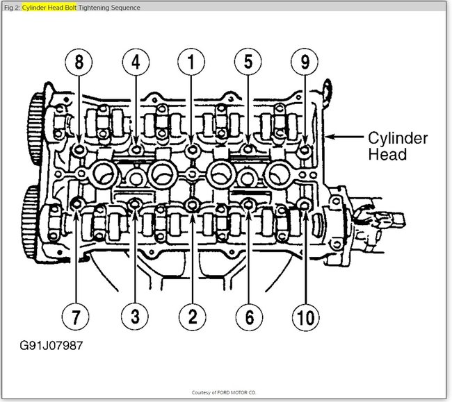

I assume this is a VIN 3 engine. I also assume you are referring to the cam bearing caps. Check out the diagrams (Below). Please let us know if you need anything else to get the problem fixed. https://www.2carpros.com/images/external/84779939.gif

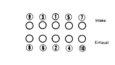

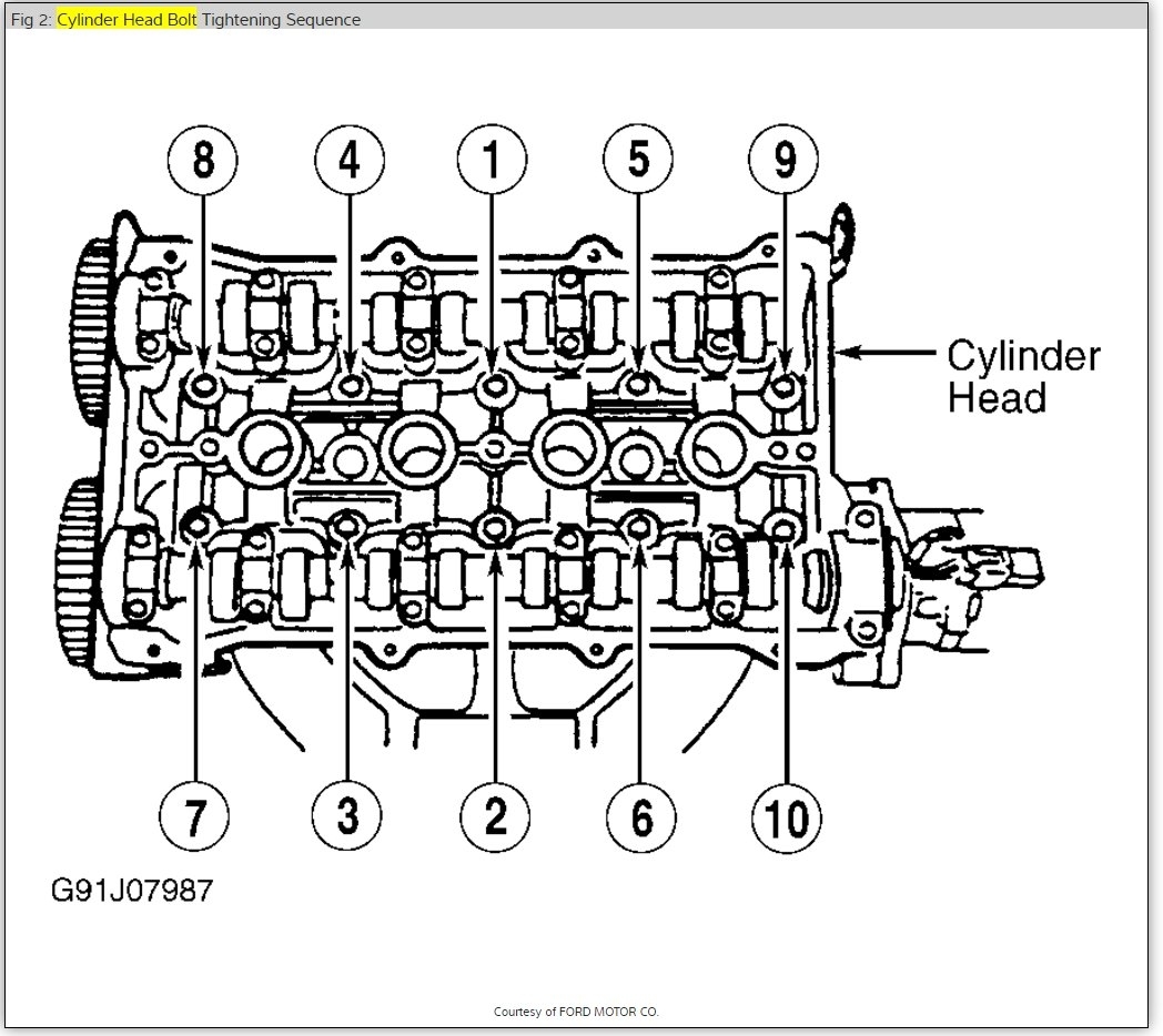

what is the tightening sequence and torque for the head on a 1994 escort engine?
Jan 28, 2021 at 1:51 AM (Merged)
  • 55,845 POSTS
Hey BIGGY25,
Here is the cylinder head bolt tightening sequence and the foot pound and newton meter specs.
Cylinder Head Bolt (1) 56-60 (76-81)
Please let us know if you need anything else.

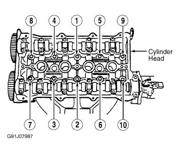

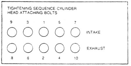

what are the spec for the torque on cylinder head
Jan 28, 2021 at 1:52 AM (Merged)
BLUELIGHTNIN6
  • 16,542 POSTS
1.9L engines.. Tighten the cylinder head bolts in sequence (refer to the illustration) to 44 ft. lbs. (60 Nm).
https://images.2carpros.com/forum/automotive_pictures/261618_0900c1528008da7a_1.jpg
1.8L engines.. Tighten the bolts in the proper sequence (refer to the accompanying illustration) in two or three steps to 56-60 ft. lbs. (76-81 Nm).

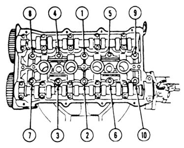

what are the head torque specs
BMRFIXIT
  • 19,053 POSTS
1.8 L 56-60ft-lb
https://images.2carpros.com/forum/automotive_pictures/99387_Graphic1_191.jpg
1.9L step 1 30-40ft-lb step 2 loosen all bolts 2 turns step 3 44ft-lb step 4 additional 90 degrees step 5 additional 9 degrees
https://images.2carpros.com/forum/automotive_pictures/99387_Graphic2_93.jpg
