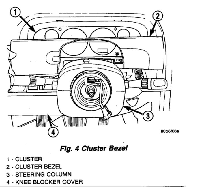

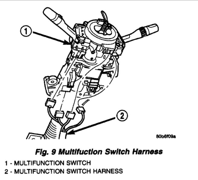

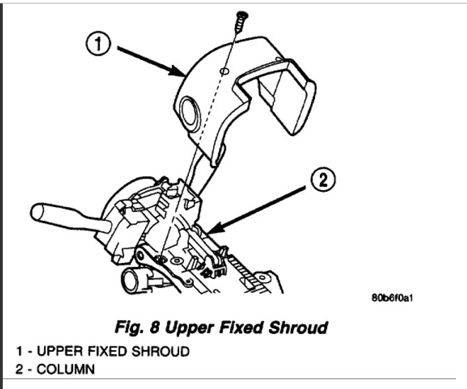

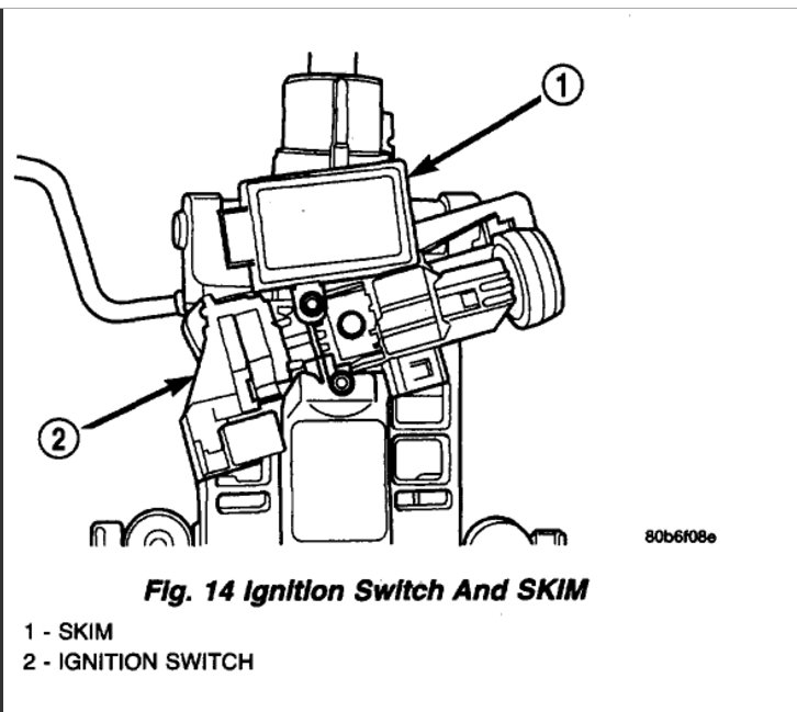

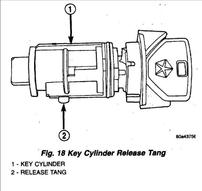

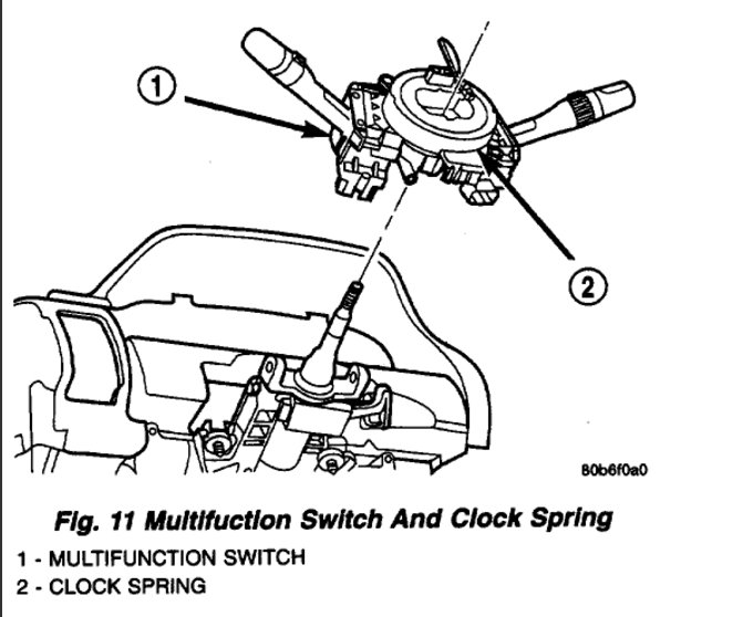

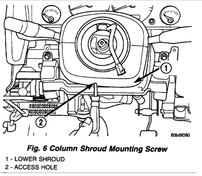

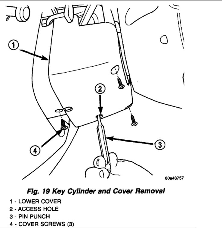

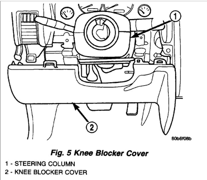

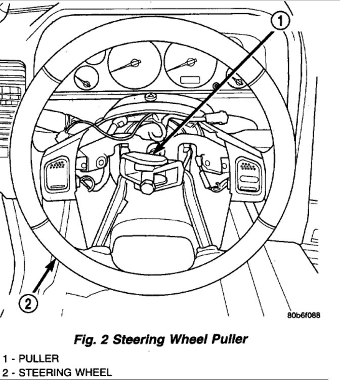

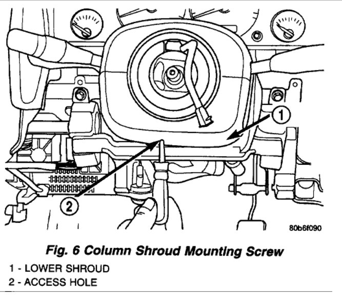

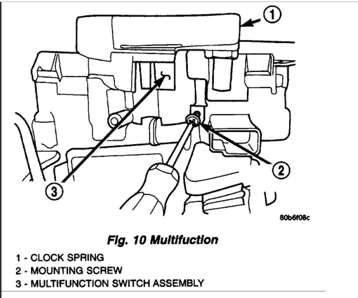

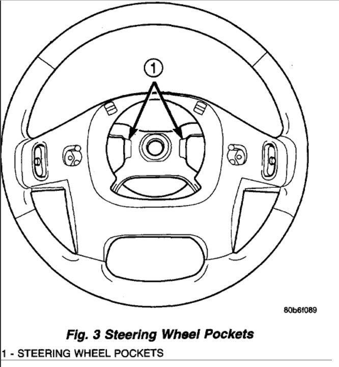

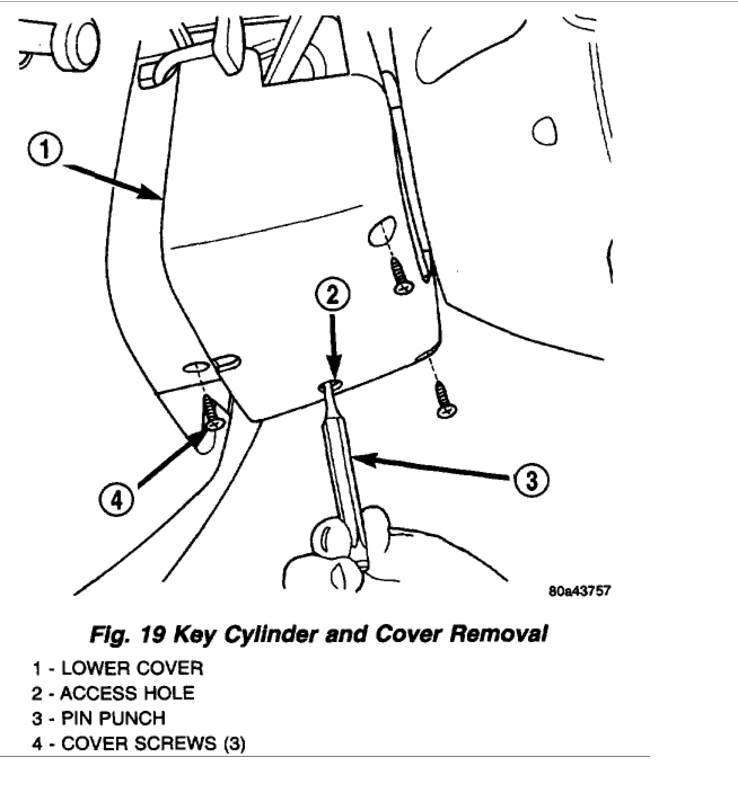

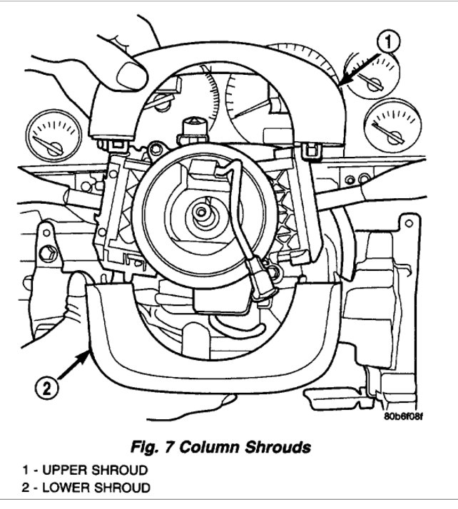

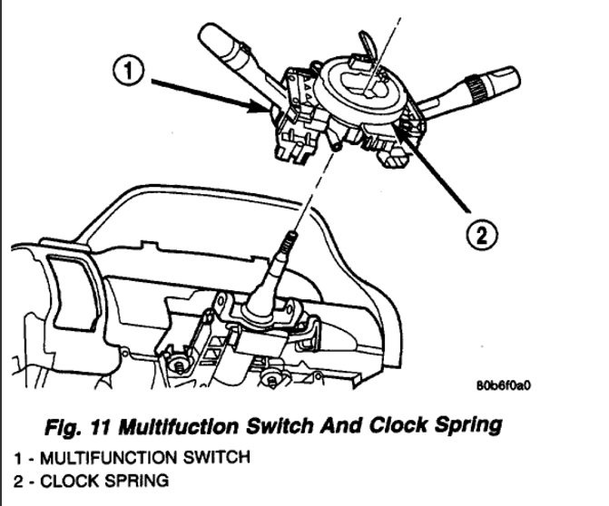

Key will not go all the way into ignition.
Wednesday, September 2nd, 2020 AT 12:14 PM (Merged)
KEN L
  • MASTER CERTIFIED MECHANIC
  • 48,363 POSTS
It sounds like something could be stuck in the lock. Use a flashlight to check for an obstruction if okay then use WD40 or equivalent to lube the lock. If that does not work then the tumbler will need to be replaced.
https://www.2carpros.com/articles/air-bag-removal-steering-wheel
and
https://www.2carpros.com/articles/steering-wheel-clock-spring-removal
and
https://www.2carpros.com/articles/steering-wheel-removal
Here are some diagrams to help you get the job done. your car will need a steering wheel puller which you can rent at the auto parts store for free.
