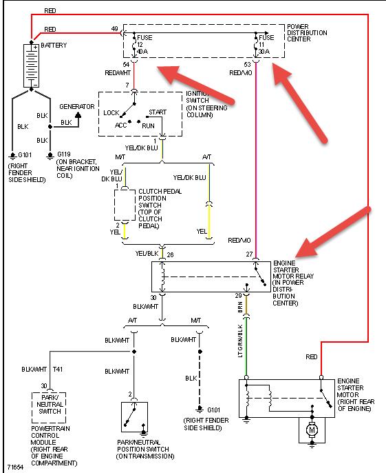

engine wont turn when i turn the key

So here is the deal when I get in my jeep and turn the key to run and go to start it wont turn bran new optima red top new connections at battery grounds are good all lights and goodies work when I turn the key the relays click and something in passenger side dash clicks don't know what's wrong please help!

check items in pic first make sure starter has same voltage as battery

bad starter top on it with a hammer a few times and turn the key and it starts right up figured it out shortly after posting lol cleaning out emails and found this lol
