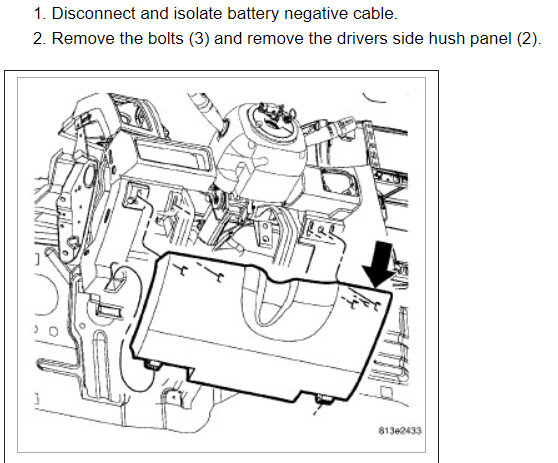

Almost every time I put my Jeep in park and turn the key to turn the engine off, it will not turn all the way so I can pull the key out for a minute or two. I thought maybe it was the key so I tried using my other key but it doesn't make any difference.
Jul 29, 2013 at 4:47 AM
  • 110,244 POSTS

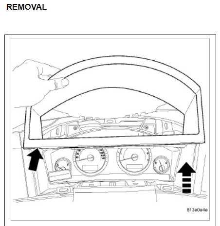

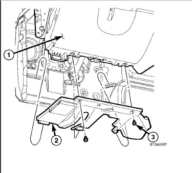

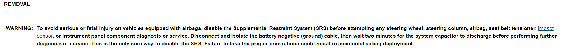

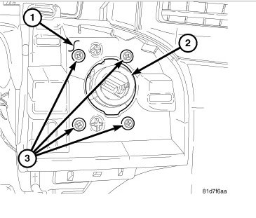

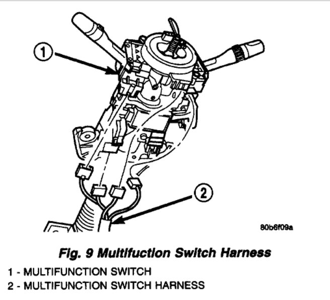

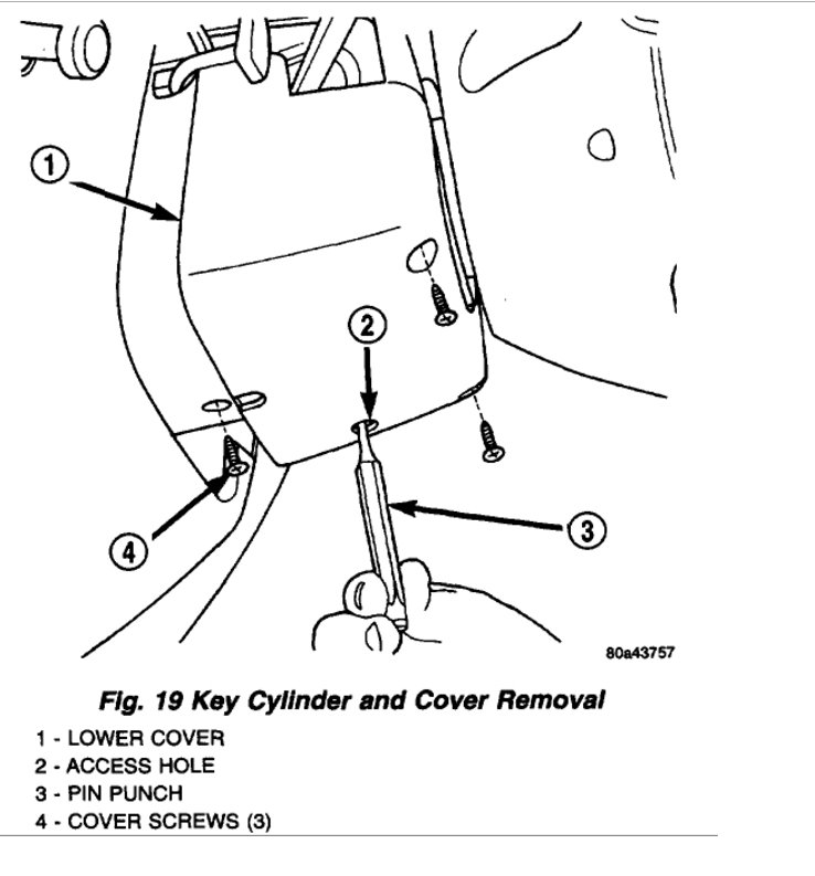

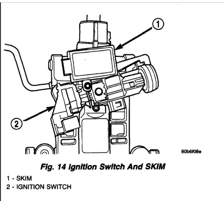

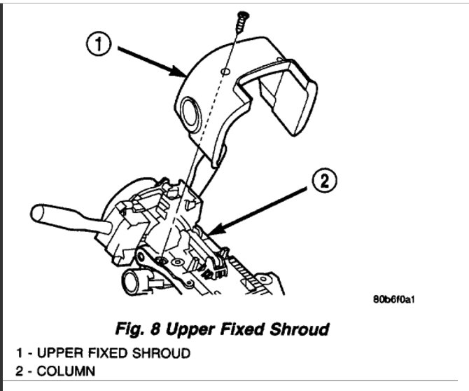

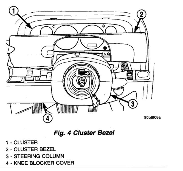

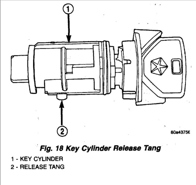

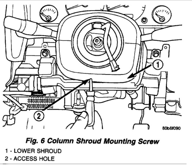

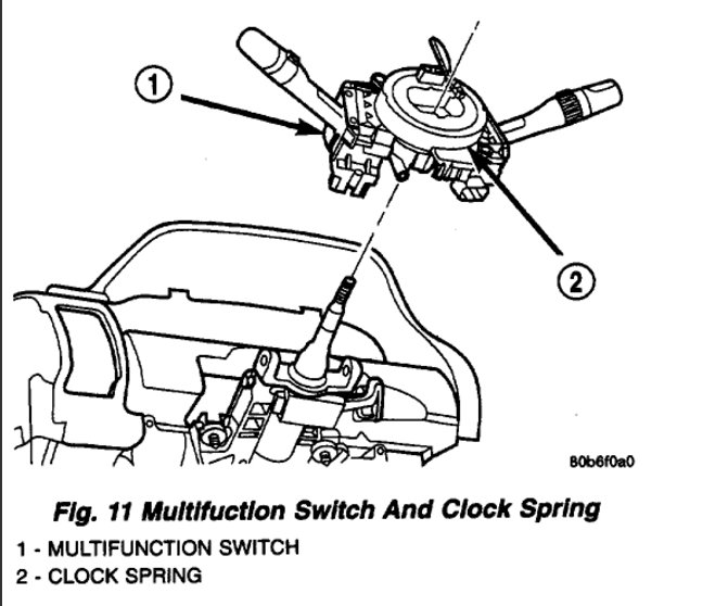

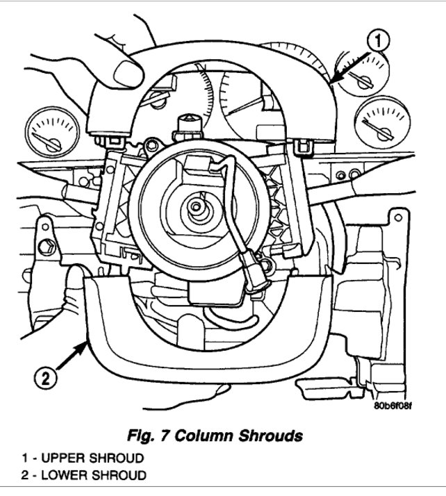

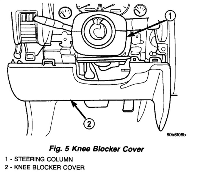

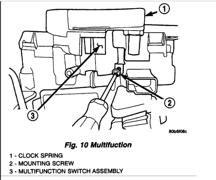

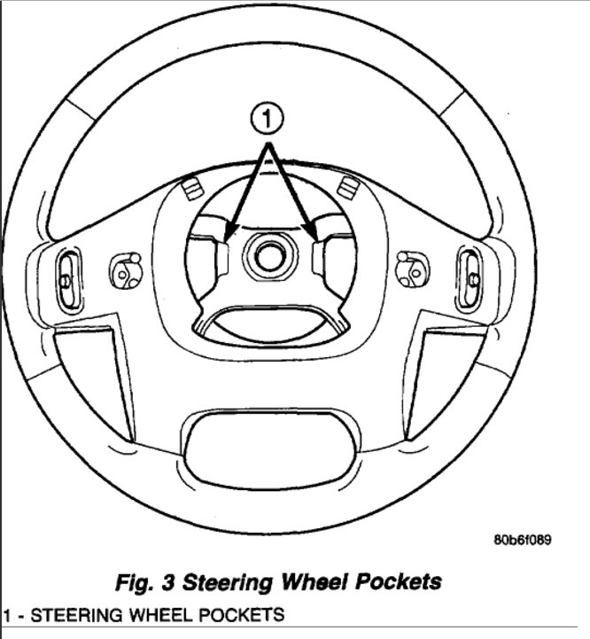

The only thing I can think of is either the tumbler or there is a lever that goes from the tumbler to the ignition switch. Try to lube the tumbler to see if that helps. They make a special graphite grease for key cylinders. Most parts stores will have it. Try that first if not here are instructions on how to replace the ignition key tumbler in the diagrams below. Check out the diagrams (Below). Please let us know what happens.

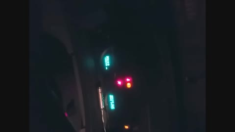

JEEPPROBLEMS101
  • 7 POSTS
Video.
Sep 2, 2020 at 5:09 AM (Merged)
  • 110,244 POSTS
Jeff, is that clicking inside or outside the vehicle? If it's outside, see if the newly installed axle is turning with the vehicle staying in place.

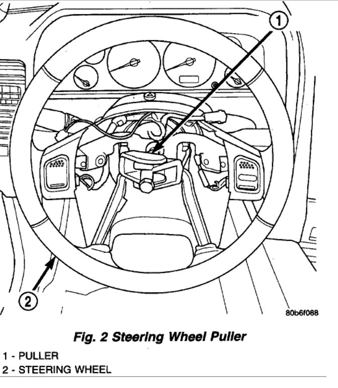

It sounds like something could be stuck in the lock. Use a flashlight to check for an obstruction if okay then use WD40 or equivalent to lube the lock. If that does not work then the tumbler will need to be replaced.
https://www.2carpros.com/articles/air-bag-removal-steering-wheel
and
https://www.2carpros.com/articles/steering-wheel-clock-spring-removal
and
https://www.2carpros.com/articles/steering-wheel-removal
Here are some diagrams to help you get the job done. your car will need a steering wheel puller which you can rent at the auto parts store for free.
