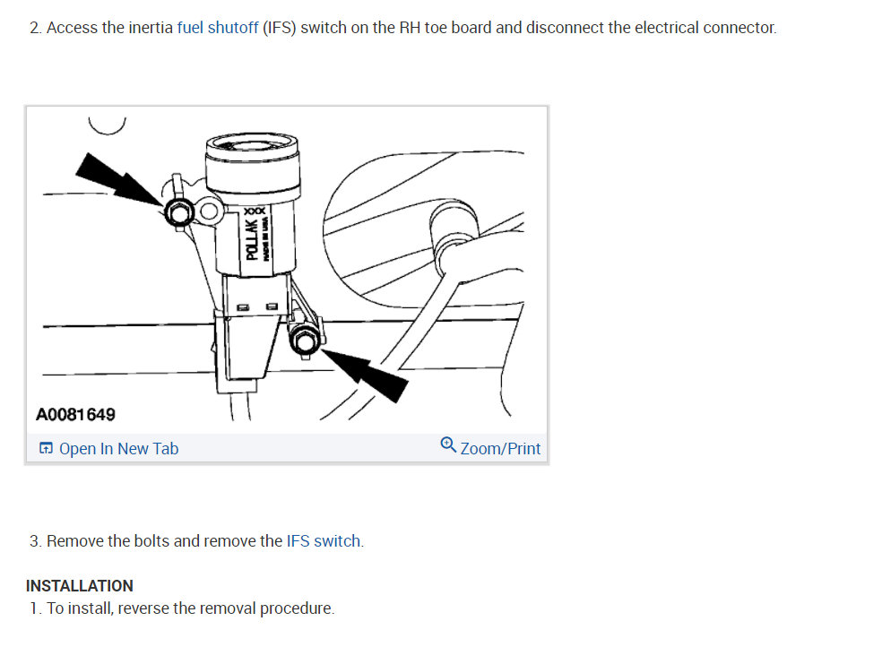

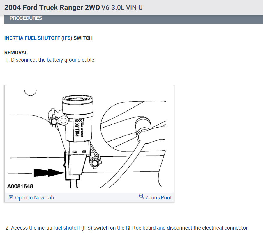

Hello again.

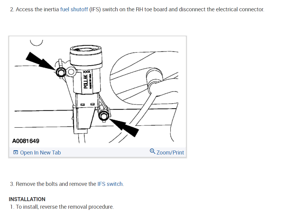

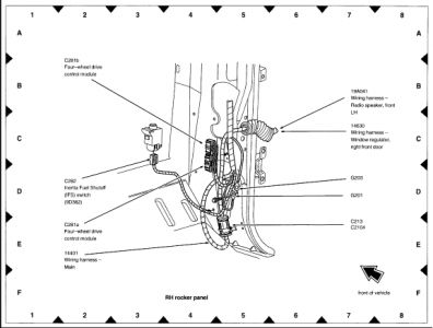

The 2 seconds is good but the voltage is too low. You have either a bad battery or the battery needs to be charged. You need 12.6 volts at the battery. When cranking it should go no lower than 10.8 volts. Here is the location of the inertia switch. Check out the diagrams (Below). Please let us know what happens.

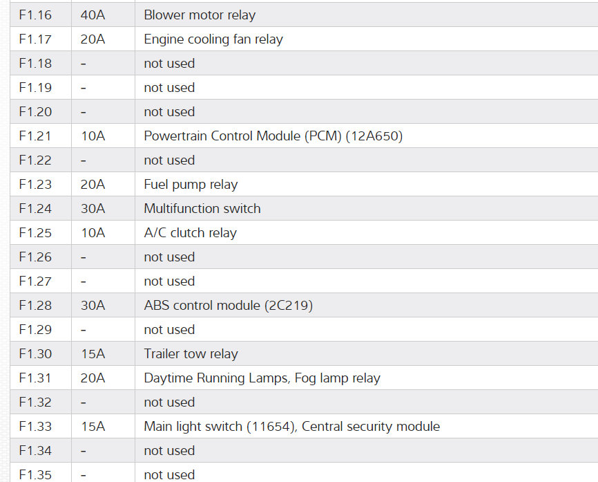

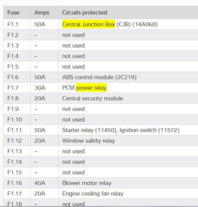

  • 55,443 POSTS

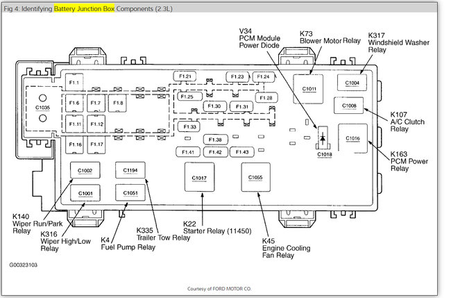

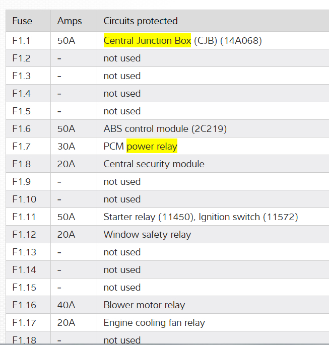

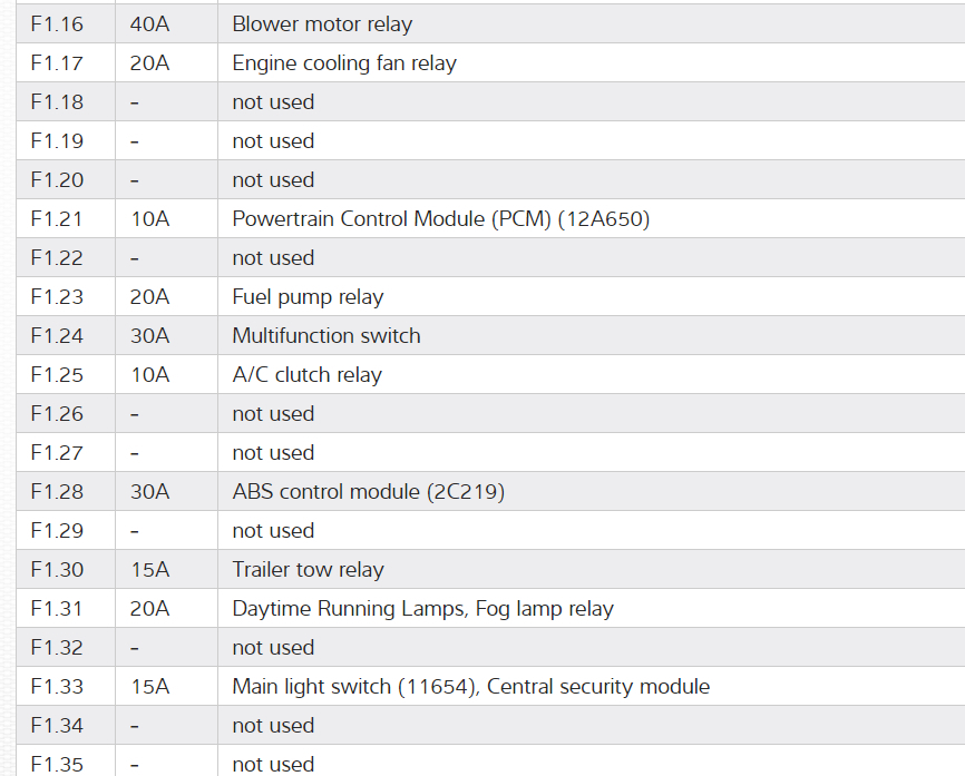

If I can jump in here. it sounds like the fuel pump relay is no good. here is a guide to help test it and the relay location as well below:
Check out the diagrams (below). Please run this test and get back to us.

Driving down the road my truck shuts off! (acts like lost of fuel). Tow to ford dealer $165.00 later no part install, $80.00 tow bill and told a reset set button was done! This has happen twice now Ford man states that only "Ford" can reset the button! So is the Fuel pump going bad or a reset button! I'm not going back to the Ford man. He got me twice!! No more!!
Oct 7, 2020 at 6:02 AM (Merged)

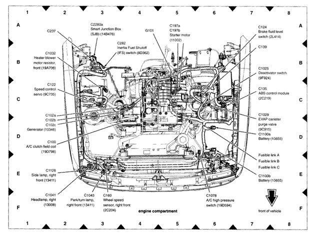

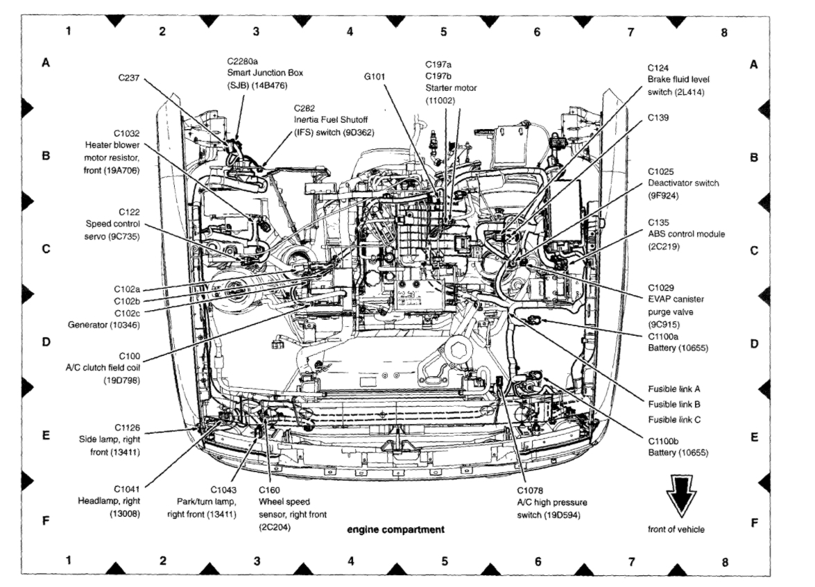

  • 75,992 POSTS
Ok Camper Chuck,sorry for all your troubles-to prevent you from getting a third strike locate the Inertia Fuel Shutoff Switch-see diagram below: Inertia Fuel Shutoff Switch View 151-30

Where is the fuel shut off switch on a 2000 Ford ranger? This is such an easy thing, seems so hard to find an asnswer. Course this wounld not be a problem if i had an owners manuel. The guys that the ford garage won't tell me.
98RANGERXLT
  • 301 POSTS
Your fuelm cut off switch is located on the passenger side floor board on fire wall.
