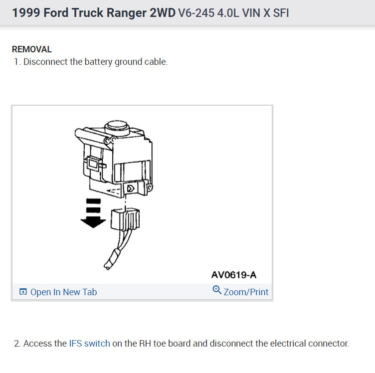

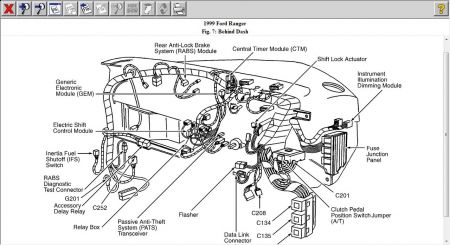

Where is the fuel cutoff switch located?
Apr 25, 2009 at 11:44 PM
  • 75,992 POSTS
The fuel switch is located on the passenger's side kick panel. Check out the diagrams (Below). Please let us know if you need anything else to get the problem fixed.

DAN_K
  • 213 POSTS
Also check for corrosion at the fuel-pump cutoff inertia switch. It is located on the passenger side floor, at the front of the carpeting/floor mat near the firewall. It has a red reset switch on it. The connectors on these switches, due to their location, are prone to corrosion.

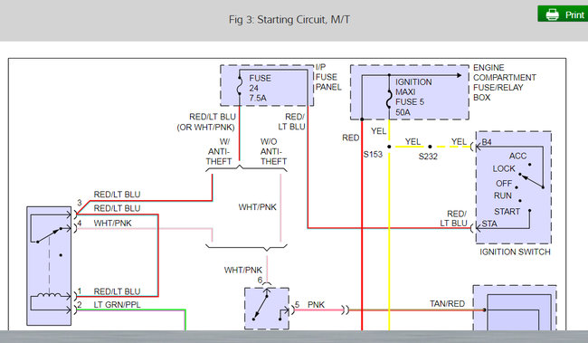

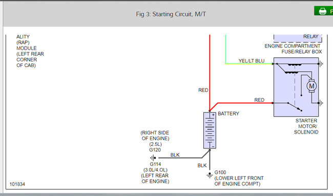

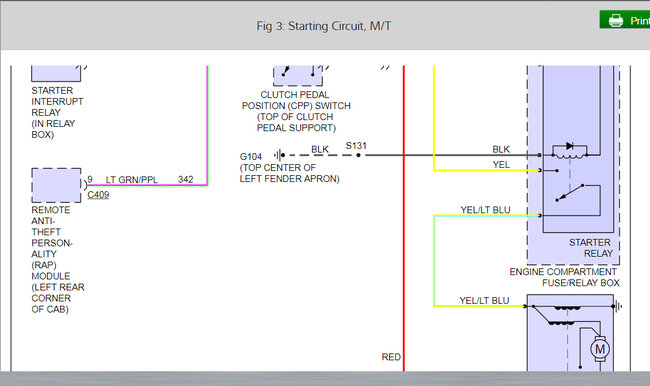

SCGRANTURISMO
  • 4,897 POSTS
Okay, just so we are on the same page I have included in the diagrams down below a wiring diagram of your vehicle's starting system. With an assistant cranking the ignition switch can you take a voltage reading for me of pin #87 of the Starter Relay in the Engine Compartment Fuse Relay Box. It should have a yellow wire with a light blue stripe on it going to the start motor. It will require you to use a multi-meter so I have included a link for you to go to below if you are unfamiliar with how to use one.
Please get this reading for us and let us know what you are able to find out. We will go from there.
Thanks,
Alex
2CarPros
