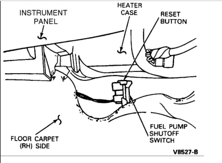

location of fuel pump reset switch?
1991 FORD RANGER
SKAY769
Please. where is the fuel pump reset switch located I am stranded. I love this site
Jun 25, 2009 at 6:09 PM
  • 54,861 POSTS
The inertia switch is located below the instrument panel, to the right of the transmission hump. Here is a diagram (below) You must pull the carpet back. Please let us know if you need anything else to get the problem fixed.

Truck no start , but turns over,, lack of gas ,, located collision shut off switch to fuel pump,, will not reset,, what next, have tried with key off and on,
have removed 2 wire clip and re installed,, switch is located at carpet level
passenger side below heater housing,, apparently the fuel pump is not engaging to pump mode, plastic button will not stay down,,
was working fine forever,, just would not start, so first choice fuel and shut off switch,, was not bumped to my awareness.

MEFORD11
ok, pressed down reset button on the fuel pump collision switch and clutch in and key start,, it started,, as soon as released the switch it quit running,
appears to be switch eh,, where to get new one,,

EMONEY1961
Engine Mechanical problem
1987 Ford Ranger 6 cyl Two Wheel Drive
there is a fuel shut off switch on pass floor board it has a button on top of switch its up and i cant get gas to flow can i by pass switch ? because i can not find switch at car parts store i dont want 2 spend a lot on truck until i get it running and check it out then i would buy switch from dealer so so expensive! can i just bypass to hear it run?
Oct 7, 2020 at 1:07 PM (Merged)
MERLIN2021
  • 17,250 POSTS
Well you can just cross the connector with a piece of wire, but try pressing the button down, that is the normal position...if the button is up, that kills the pump.

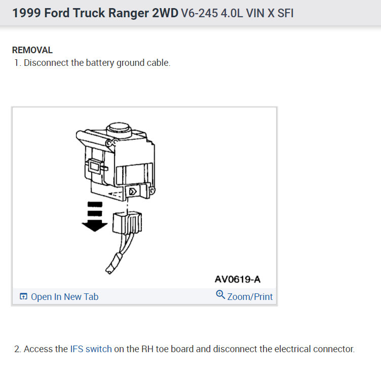

I am having problems with a new fuel pump not priming. I have located a problem with EEC relay and am replacing it but, I also want to check the inertia switch. I cannot locate it. Does this model have one? If so, where is it?
HMAC300
  • 48,601 POSTS
under right center of dashboard on firewall. Check out the diagrams (Below). Please let us know what happens.
