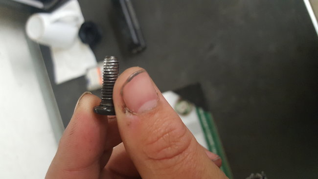

i was replacing my oil pan gasket and did not want to take apart the exhaust to get the pan to clear the studs on the driver side. so i took the studs out and found out they are self clinching studs and i cannot get a press tool in the tight space. what should i do to repair and get my pan back on? we only have one car and I have to repair this.

Could you possibly take a couple pictures or a video and upload it here? I think I know what you mean, but I cannot picture the parts and none of the references say anything other than "remove fasteners".

Of the spot it can out of or the stud it self. i cannot figure out how to put a picture on here.

The stud and where it went please. To add an image you save it wherever on a phone, tablet then click the add image or video link under the text box. Then find the image where you stored it and select "open" It should upload it. Then hit reply to post.

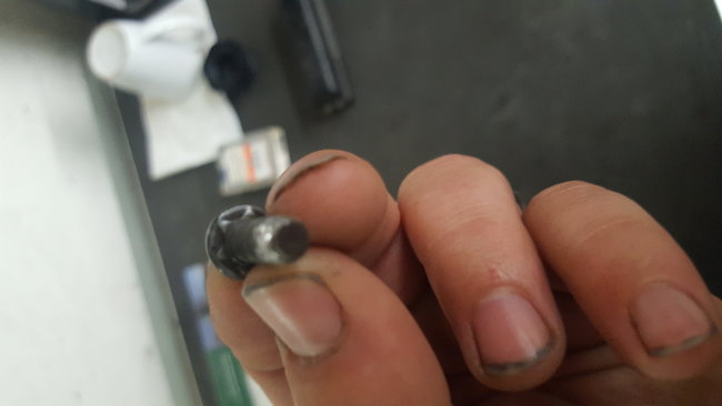

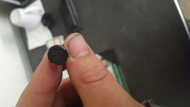

These are the bolts i cannot get to. where it sits at right now.

Those are the ones that go inside the lower rail and the pan bolts in place correct? They should be easy to reinstall. Take a large washer and socket and line up the star with the existing star inside the block. Set the stud in place with them lined up and use a well oiled nut and two to three washers to tighten the stud in place.
But those threads look like they are beat, you may want to get new ones before you pull them back in.
The process is the same you use to pull a wheel stud into place, except in this case they should line up and set into the star easily not needing to be forced into place.. A dab of Permatex on the threads to keep any oil from wicking down might be a good idea.

thank you very much still waiting on a replacement stud from Fastenal should get them tomorrow. i really appreciate the help.
