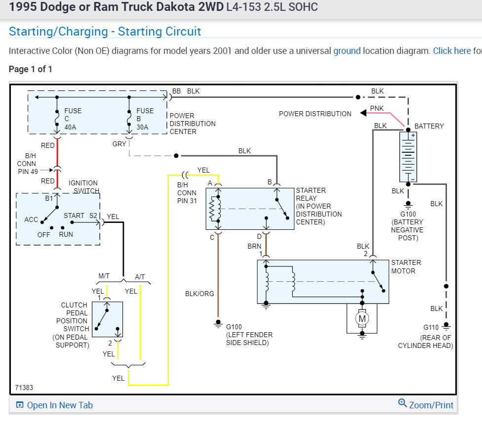

My truck will not turn over, but it will push start as it is a manual transmission and run well until I turn the key off. When turning the key to start it nothing happens. The headlights are bright as the battery is new. Thinking it had something to do with the clutch pedal neutral sensor switch I bypassed this by removing the mechanical portion of the switch and wired the leads together. Still it won’t turn over or make any sound or attempt to turn over. Is this a problem in the starter relay? Thank you for your help!

It does sound like the starter or starter relay. Here is a guide to help check out the problem and I have included the starter wiring diagrams so you can see how the system works:

Thank you, Ken! I appreciate your reply. There is another curious element to the problem. When the vehicle has sat overnight and is cold or has been off for several hours it will turn over and start fine, but after the engine has run for 20 minutes or longer, then the engine will not turn over or attempt to. I switched the starter relay switch with the AC relay as they are all the exact same relays, which didn’t change the no turn-over issue?

I have located the problem, it is a bad starting motor, Thank you for your help.
