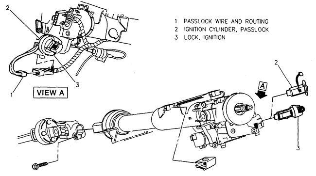

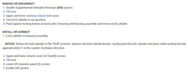

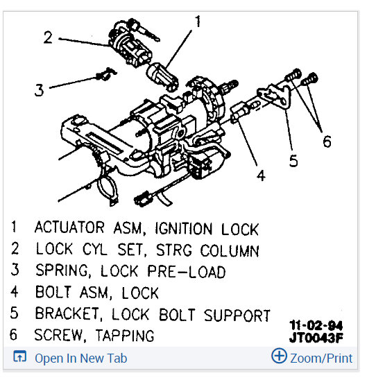

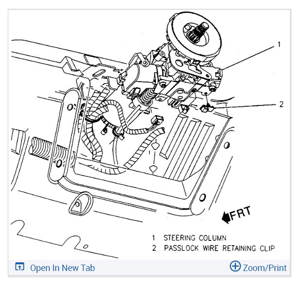

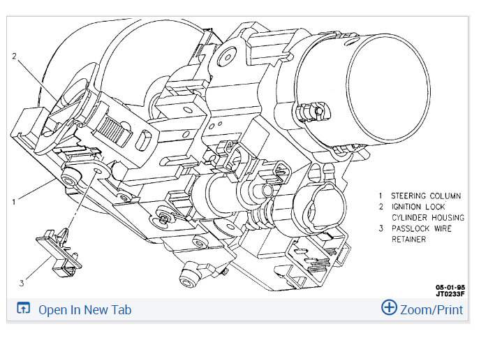

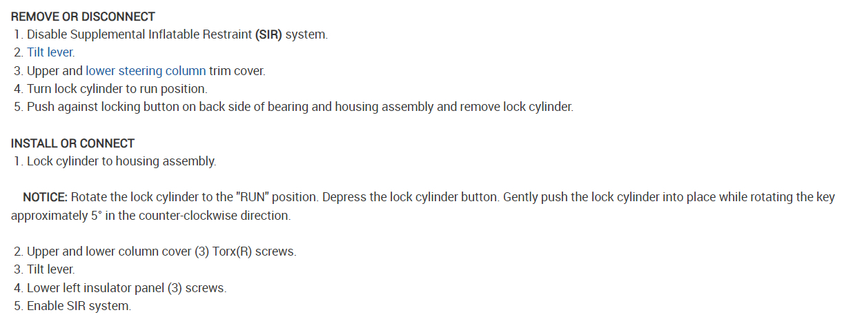

I am sorry to hear about your situation, but I can tell you the valet had nothing to do with the damage to your car, the problem you have described is typical of the GM ignition switch when they wear out (we had many in the shop for this).
First you need to disable the airbag system.
- DISABLING THE SIR SYSTEM
REMOVE OR DISCONNECT
^ Turn the steering wheel so that the vehicle's wheels are pointing straight ahead.
^ Turn ignition switch to "LOCK" and remove key.
1. "AIR BAG" fuse from I/P fuse block.
2. Connector Position Assurance (CPA) and yellow 2-way Supplemental Inflatable Restraint (SIR) harness connector at the base of the steering column, through "trap" door in LH sound insulator.
Important: With the "AIR BAG" fuse removed and ignition switch "ON", the "AIR BAG" warning lamp will be "ON". This is normal operation and does not indicate an SIR system malfunction.
Next remove the steering wheel cover. This will enable you to remove the ignition lock. I have heard of people taking the lock apart to fix it, but I have always just replaced it.
Here is the key and lock from Amazon for $15.00 in case you can fix the lock. Also, I have included instructions on how to change the lock out as well.
https://amzn.to/3UZ8F8S
Check out the images (below). Please upload pictures or videos in your response to the problem so we can see what's going on.
