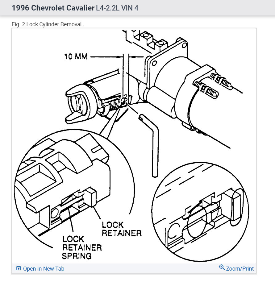

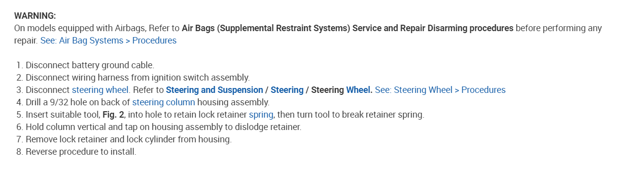

What would cause the key not to turn in the ignition?

This can be an easy fix here is a guide to help you fix it with instructions below to show you how to replace the tumbler if nothing easy works.
https://www.2carpros.com/articles/ignition-switch-wont-turn-stuck
Check out the diagrams (Below). Please let us know what you find. We are interested to see what it is.
