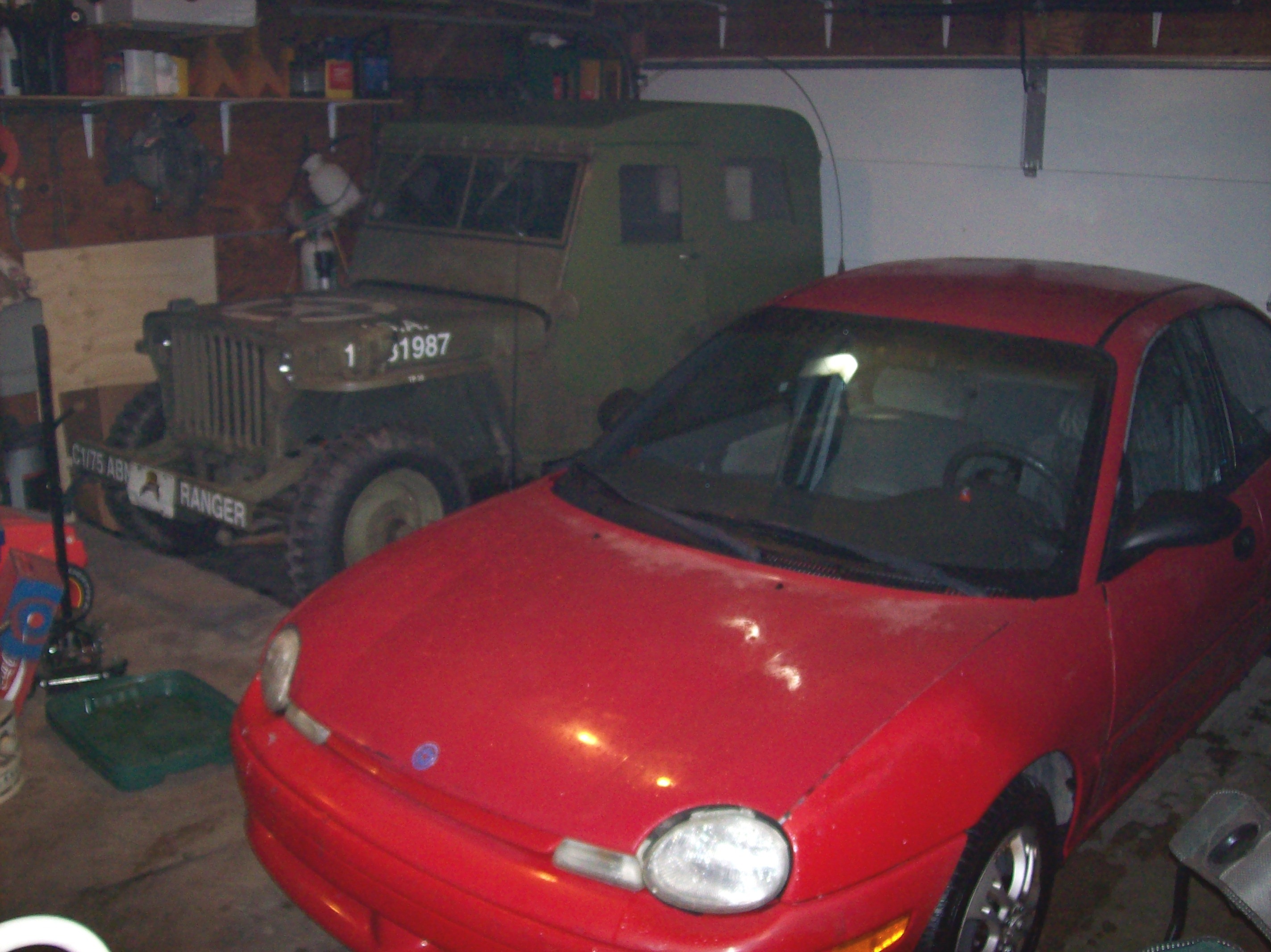

HE'S THE "SPARE CAR" I STOLE HIM FOR $250 10 YEARS AGO, W/ LESS THAN 60,000 MILES - THE 1ST OWNER WAS CONVINCED IT WAS RUINED. IT NEEDED A BATTERY! AFTER SITTING UNDER A TREE FOR YEARS! HE WAS NICE, AFTER A GOOD CLEANING, WHEN I 1ST GOT HIM.
STEP-DAUGHTER RUINED THE INTERIOR HAVING "BORROWED" HIM FOR 4 YEARS, ALONG WITH A MINOR FRONTAL CRASH WHILE "TEXTING". TILL SHE GOT ON HER FEET, WHICH REQUIRED GETTING OFF HER BUTT!
HE STILL GETS 30 MPG, A/C WORKS - REAR SHOCKS NEED REPLACING
I JUST CAN'T JUSTIFY SPENDING MONEY ON HIM EXCEPT FOR ROUTINE MAINTENANCE. I DRIVE HIM A COUPLE OF MILES WEEKLY TO KEEP HIM LUBED AND CHARGED. HE IS REALLY THERE ONLY IF ONE OF THE OTHERS GO DOWN. THAT IS SELDOM!
LONG AS HE WILL RUN - I BE HAPPY!
I FEEL I HAVEN'T QUITE GOT MY MONEYS WORTH YET!
