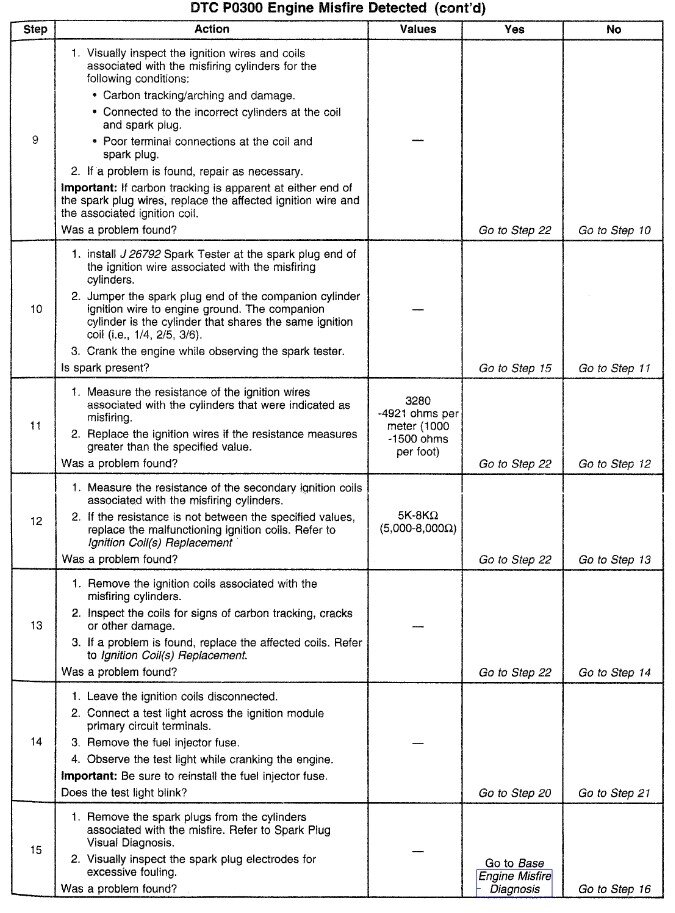

After having ordered and installed a new ignition coil module, bought in a clearance sale at a discounted price my P0304 code did not disappear, and the code analysis suggested I buy a new coil.
Although I can buy a second coil and see whether it sends another code when installed in the same position, it occurred to me to switch positions of a "known" good coil with the suspected bad coil. If I still get a P0304 or similar, that means my problem is probably not the clearance sale coil I bought, but a spark plug or plug wire.
And if I get a P030x code for the new cylinder location of the discount sale coil, that means the coil is faulty.
Is this analysis practical?

Yes, that is a practical option. Generally, what I suggest is to swap the coil to a different cylinder. Then swap the plug to another one as well. Then see where the code shows up next. So, if you start with a P0304, swap the coil to 3 the plug into 2 and now you have a P0302, it's likely the plug. Same with the coil. However, that car uses a single coil to fire two plugs at the same time in a waste spark system. If you get a misfire for one cylinder it should also show for its mate. In this case that would be cylinder 1. As such I would suggest it's not the coil. It can be the wire or plug, but it could also be something internal.

In your case I doubt it's the coil. Why? Because each of the 3 coils fires 2 spark plugs at a time. So, with a P0304 code you would also have a P0301 code if the coil was bad. The coils can be swapped around as long as the plug wires are kept correct. What I like to do to save aggravation is to mark them with white paint markers. On the engine the lowest coil should be cylinders one and four. The center coil is cylinder two and five and the top coil is three and six. The plug wires just need to go to the correct coil.

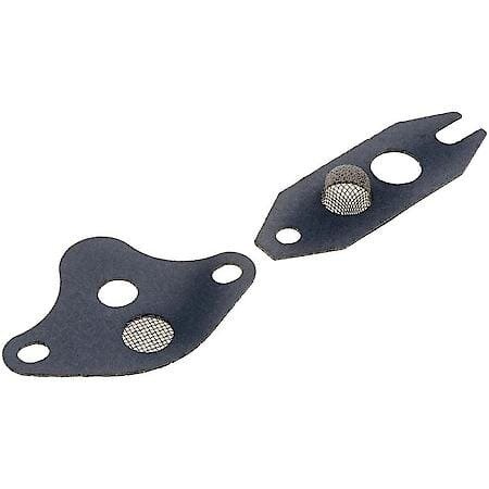

Just a few minutes ago, I ordered a Kleen Screen, as you recommended.

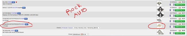

Steve, after getting a few notifications from resellers that the Kleen Screen (product number 47007) is not compatible with the Buick 98 LeSabre 3.8L, I called Dorman, and spoke to a senior technician named Peter, who said Dorman does not make a Kleen Screen for the Buick.
At that, I asked Peter what he would recommend, but he had no recommendations.
Good idea, though, and thanks!
May 23, 2024 at 5:47 AM
STEVE W.
  • 15,421 POSTS
Yeah, there were a number of different companies that made them, there are also screens that just pushed into the port like a freeze plug. They have sort of gone away because of design changes that deal with carbon better. These days just finding the correct parts can cost you hair! Finding a part that was only made for a specific use can be a real headache.
BUT if you look at the Standard Products VG214 you might be surprised, and if you look at the two in the image, I attached above you might also notice something, IE just because they say it "isn't right" doesn't mean it doesn't fit. GM only used a few EGR base designs.
You might like https://www.3800pro.com/ if you want some "light" reading..

Steve, one of the gaskets has exactly the right footprint for the original, so I'll call Standard Products now, and ask about their #VG214. And if they claim incompatibility, I'll ask why it will not work.
Thanks for the link to the 3800 forum-- these are very useful, which is why you use them.

Well, considering it is in their catalog and can be bought for the 3.8 in multiple parts stores. I don't know what they will say unless they stopped making them. But the Dorman one is the same base design.

Standard's technician said product VG214 will work with the pneumatic EGR valves, but not the electronic EGR valves. According to the tech representative, the wire screen "screws up the electronics".
