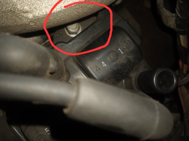

How do I access the top left bolt on the ignition coil? On the 3.5 it is easy but, on the 3.9 the pellhum is rounded in the back preventing access.
Please help. Thanks a lot.

Can you take some pictures of the problem you are taking about that way I can see what is going on? Upload them to the site here.

It looks like you can use a wrench to remove the bolt or a 1/4 drive socket. I am still having a hard time seeing the problem. Can you give me a link to the video you are talking about? there are several.

You cannot even use a small 1/4" drive socket to get it to the tight space.

Can you take a picture and upload it here so I can and make a suggestion?

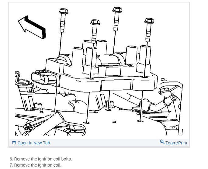

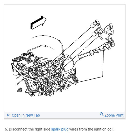

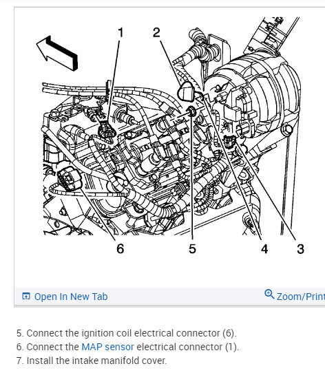

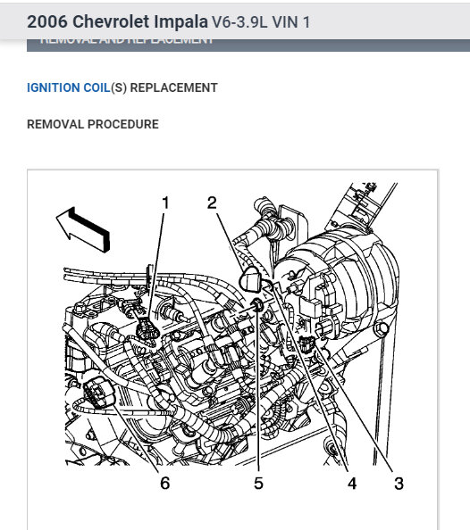

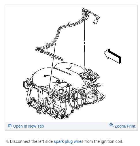

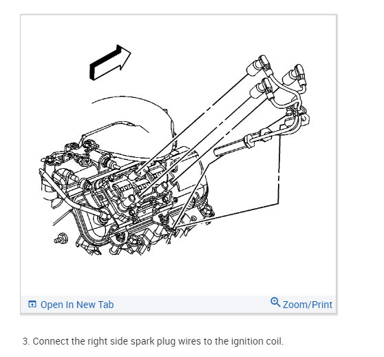

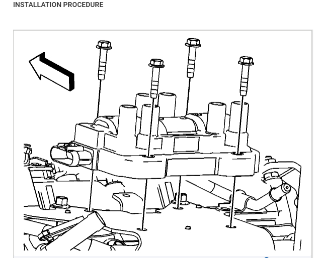

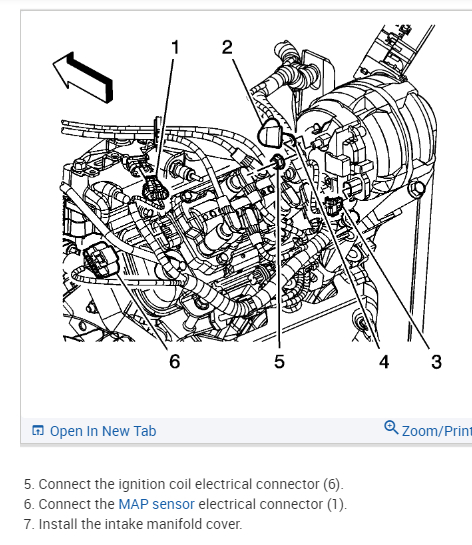

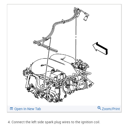

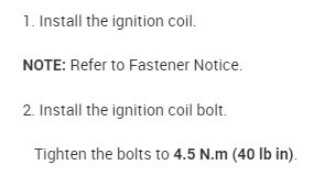

I looked at the directions and the only thing they indicated was to remove the intake cover. The alternator is also shown, but there are no directions related to it. Are you able to get an offset box end wrench in there if you remove a few things?
I attached the directions below from the manual. Take a look through them and let me know if they help in any way.
