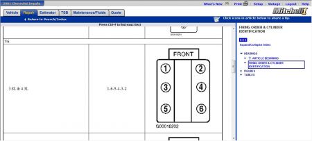

what is the spark plug wiring order for my 2001 chevy impala
May 29, 2010 at 8:47 AM
  • 75,992 POSTS
Is it an line 6 or V6 and also what is the engine liter??
May 29, 2010 at 8:52 AM
PHILIPE321
v6 and 3.8 liters
May 29, 2010 at 9:10 AM
  • 75,992 POSTS
https://images.2carpros.com/forum/automotive_pictures/12900_fo_124.jpg
