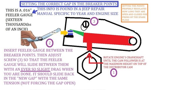

Review

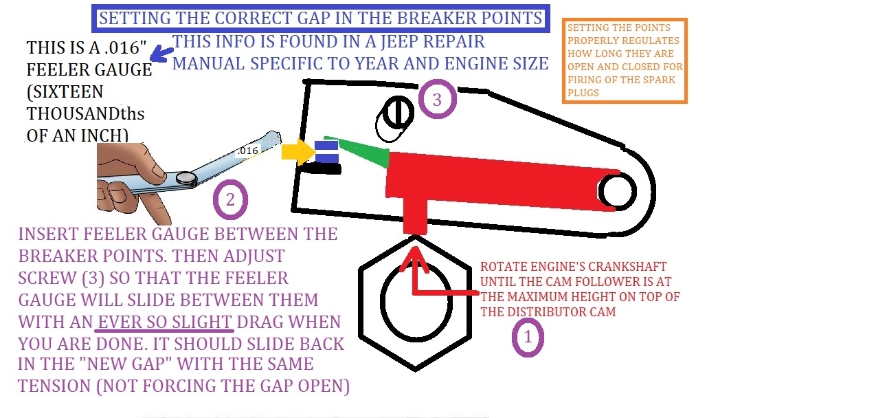

Points are now adjusted to.016" as per my last diagram?
Did you understand the diagram? I was hoping that would be self explanatory. Do I need to explain it better?

Yes I understood the diagram the points are at.016 they pop and spark. But from the distributor cap to the spark plug wires to the spark plug its self there is no spark.

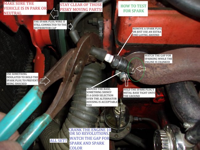

With everything assembled back together.
Cranking the engine with the starter does not spark at the plugs?
I have not addressed sparking.
Remove one plug (Easy one to get to)
Plug the spark plug wire back onto the removed plug.
Ground the fat hex part of the spark plug to a shiny metal part under the hood (the ear of the alternator would work)
While holding it tight to the ground have someone crank the starter, watch the gap of the plug for a spark.
Watch out for them evil moving parts!
Is this what you have been doing?

Okay,
I have been meaning to make this picture for years!
I can now use it a lot for other car questions.
This is so very important for me to know.
Is this how you are testing for spark?

More or less on the negative side of the battery. It is shiny.

I want you to go back to November 12 (My answer, setting the points).
Set/check your point gap with the cam follower on a high point of the cam.
Now it is set with correct gap.
Do not turn the adjustment screw anymore!
Lets do a check.
Rotate the crankshaft with a wrench again. Let's wind up on the next high point of the cam.
The points should be open again!
Check the gap again with your.016" feeler gauge. It should shove into the gap and have "ever so light" tension against the feeler gauge.
Good? I hope so!
