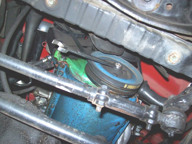

Nov 3, 2018 at 11:09 AM
It does not appear to have done anything nothing moved. What if I move it a lot what will happen?
Nov 5, 2018 at 8:29 AM

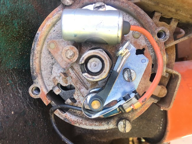

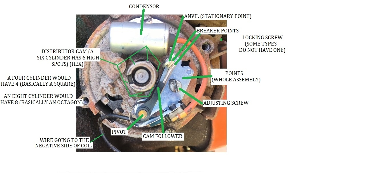

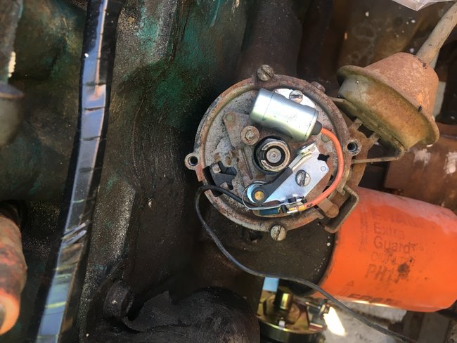

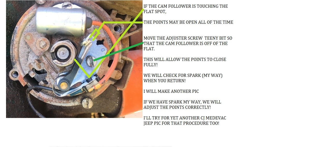

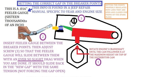

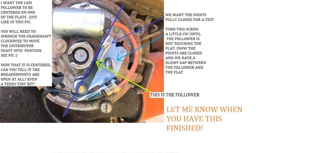

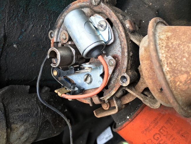

Okay.
Is the cam follower (plastic piece on the points that rides the hex) still in the flat spot of the hex as it was in your picture that I "painted" on?
If so, that is where we want it!
Now, turn the adjusting screw CW (clockwise) until you see the cam follower lift slightly off of the flat of the hex (the whole points assembly will move). This gap you make between the follower and the flat will insure the breaker points are actually closed (touching)
Let me know when you are there, then we will do a test!

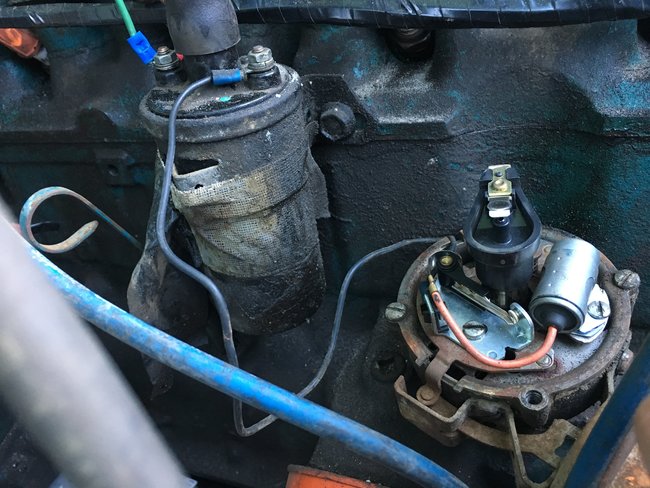

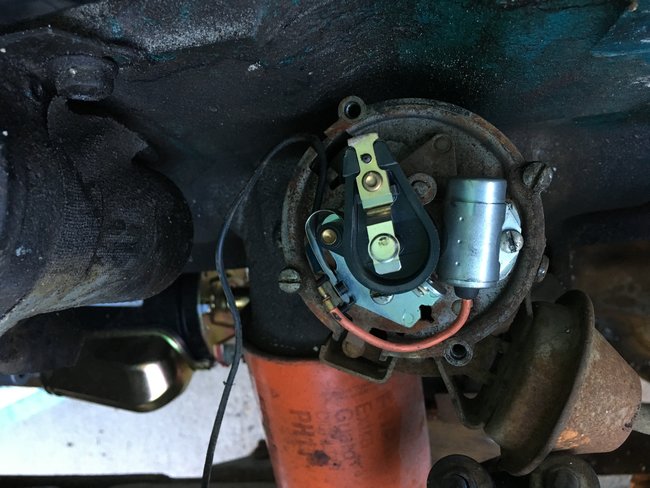

Okay, we are there.
Nov 10, 2018 at 8:55 AM
The beaker points now touch!

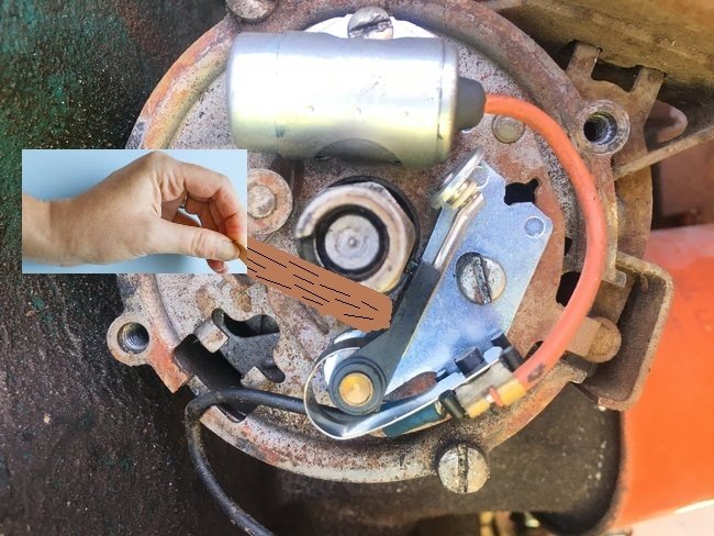

Turn on the ignition (key) to "on".
Do this when it is kind of quiet and maybe not so bright (not in the sunshine).
Insert a Popsicle stick or plastic whatever between the distributor shaft and the point arm.
Warning!
If you use something metal you will probably get shocked!
Twist or pry with the stick to barely crack the points apart.
You should hear a faint pop along with a blue spark between the breaker points.
Pry it open barely but very quickly over and over and over, you should get a pop, pop, pop, pop, pop along with the blue spark each time!
Nothing?
Turn off the key.
Fold a small piece of fine sandpaper in half or grab your cardboard fingernail file. Pry the points open and insert your sandpaper or cardboard fingernail file between them. Let go of the points and commence sanding for a minute or so! Remove the sanding device.
Start over!
Key on.
Popsicle stick
Pry.
Results? Popping? Spark?
Whatever happens (or does not), I am ready to tell you what to try next!
Picture below.
My keyboard has something under the "R", sorry if my "Rs" do not show all of the time!
The Medic

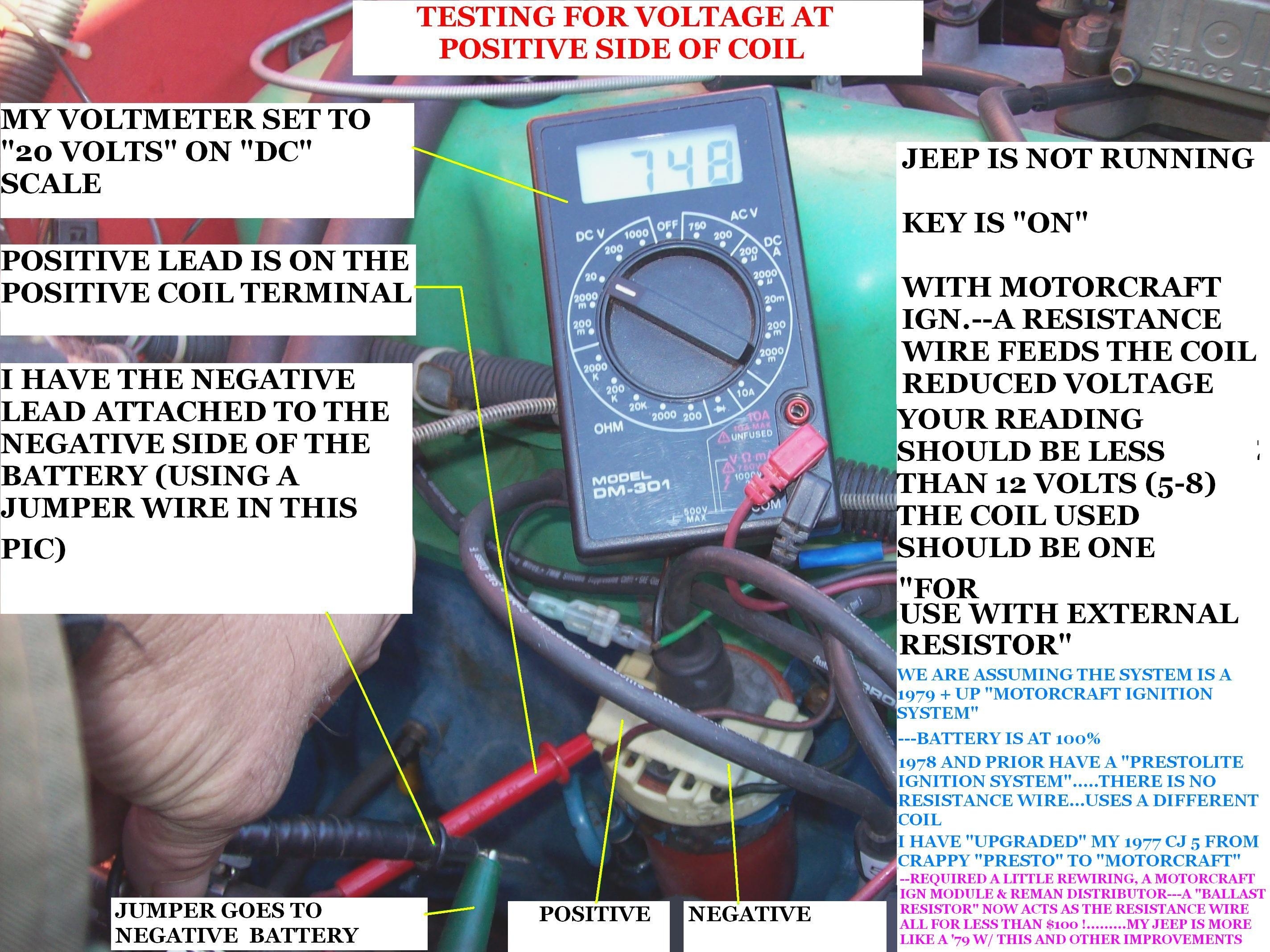

Nov 10, 2018 at 12:44 PM
Do you have a voltmeter?
$5.00 at "Harbor Freight", maybe $20.00 at a parts store.
Got to have one to continue. You can use it forever and ever.

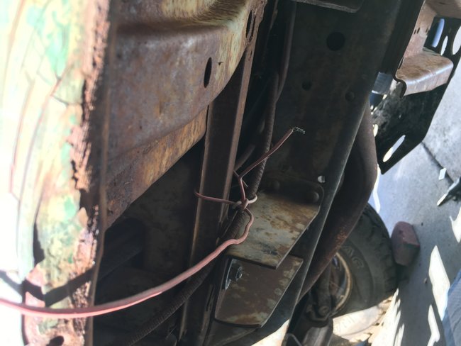

Nov 10, 2018 at 1:51 PM

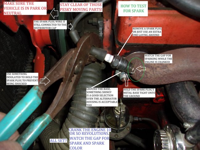

Let's try one more thing while we are at this point.
Turn the key off and re-run your temporary jumper wire from the positive battery post and back over to your positive coil post.
Now with the points being still closed try the Popsicle stick thing again.
Any sparking? Any popping?
The Medic
The Medic
Nov 10, 2018 at 2:04 PM
Voltmeter yes. However, I thought I rushed last night so I tried again what you told me and it is sparking at popping now. Much warmer outside than it was last night.

Points are now adjusted to .016" as per my last diagram?
Did you understand the diagram? I was hoping that would be self explanatory. Do I need to explain it better?
This is quite alright if we are not in the same Jeep. I will simply pull up behind you and give you another push with my push bar!
I just need to know what part of the trail you are stuck on.
The Medic
We will try it again when I run you through another test.
Review

Yes I understood the diagram the points are at .016 they pop and spark. But from the distributor cap to the spark plug wires to the spark plug its self there is no spark.

Okay,
I have been meaning to make this picture for years!
I can now use it a lot for other car questions.
This is so very important for me to know.
Is this how you are testing for spark?
I do realize you are a novice at all of this stuff, I found out in the army it is sometimes easier to teach marksmanship to someone who had never done it before, as they had not picked up any bad habits yet.
So,
You are doing fantastic so far!
The Medic
So,

Nov 19, 2018 at 12:28 PM
More or less on the negative side of the battery. It is shiny.

Let's lightly sand them points some more. Do you have a helper?

I want you to go back to November 12 (My answer, setting the points).
Set/check your point gap with the cam follower on a high point of the cam.
Now it is set with correct gap.
Do not turn the adjustment screw anymore!
Lets do a check.
Rotate the crankshaft with a wrench again. Let's wind up on the next high point of the cam.
The points should be open again!
Check the gap again with your .016" feeler gauge. It should shove into the gap and have "ever so light" tension against the feeler gauge.
Good? I hope so!
Now lets rotate the engine again until the follower (Oops, had to put new batteries in my keyboard) until the follower is in a flat spot, in between two high points on the cam.
Right now the points should be fully closed.
Turn the ignition to "on".
Verify that you have 12 volts at the positive side of your coil.
The negative side of the coil is connected to the distributor.
Good? I hope so!
