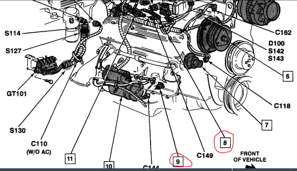

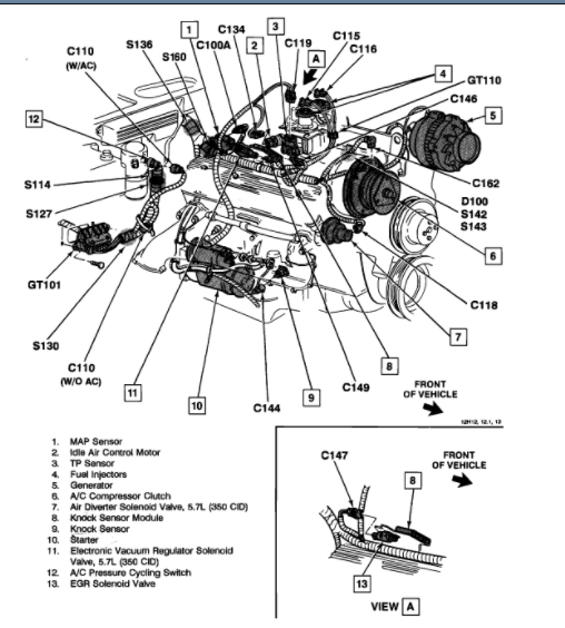

Here's my dilemma: I'm wanting to install a part that I can't, nor anyone else I've asked for that matter, seem to find. I'm looking for the location where the Electronic Spark Controller (ESC) is located on my truck listed above K1500, 5.7L V-8, Auto transmission. It's the last piece, other than a new computer, to try and fix the problem I've been having in regards to engine bog down when it gets hot or when it's humid. I've been looking for this holy grail all morning and have asked numerous local mechanics as well all with the same result. Help! Lol and thanks in advance. :)

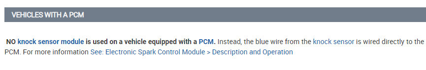

Hello, I'm Danny.
Here is the information you requested. If your truck is equipped an ECM- engine control module it has an external knock sensor and module. If your truck is equipped with a PCM-powertrain control module it is built into the PCM and you won't find it externally. I've attached pictures below showing the ecm system with the external sensor and module circled in red showing their location. I've also attached a picture of the PCM system notes. Hope this helps and thanks for using 2CarPros.
