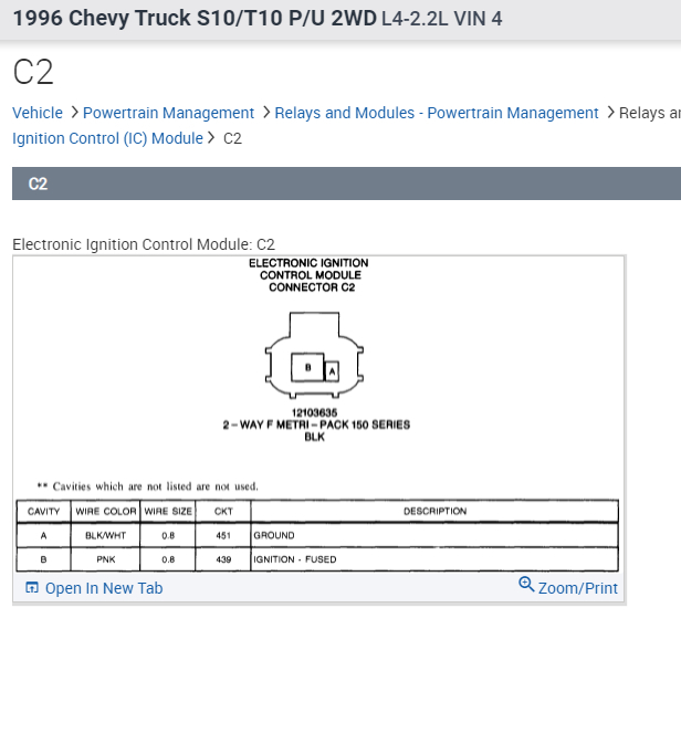

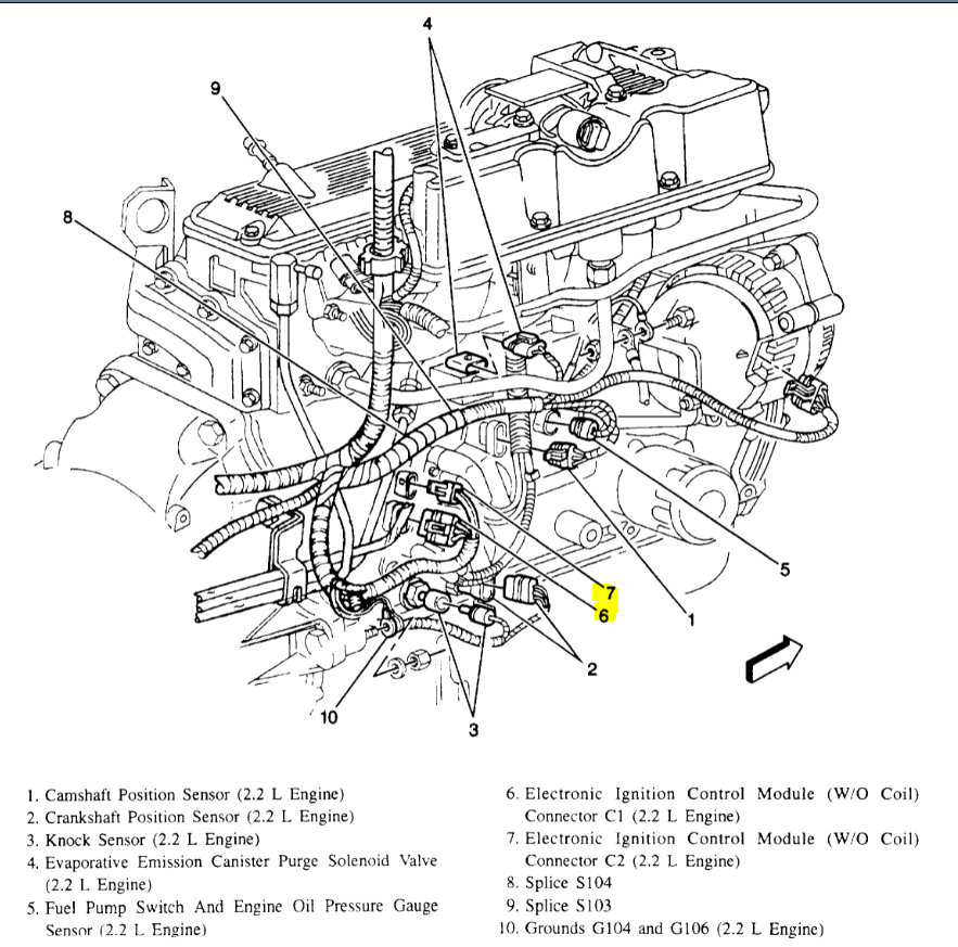

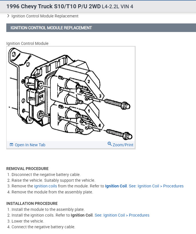

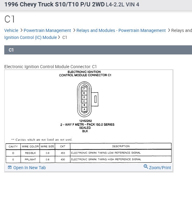

Before I took my engine apart. I had a no start condition. Now I have a new light, reg, size diagram of location of ICM, ck pos. and other comps.
With no spark to plugs, no signal to inj. did have power.
