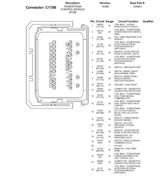

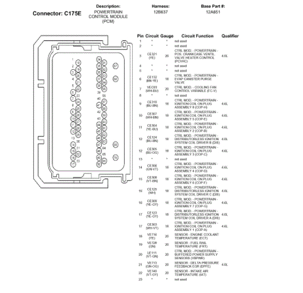

I had Alldata software and can't find the pinout for the PCM.
Its 170 pin
Mvf3 9L2A-12A650-FD
Aug 31, 2020 at 6:02 AM
Good evening,

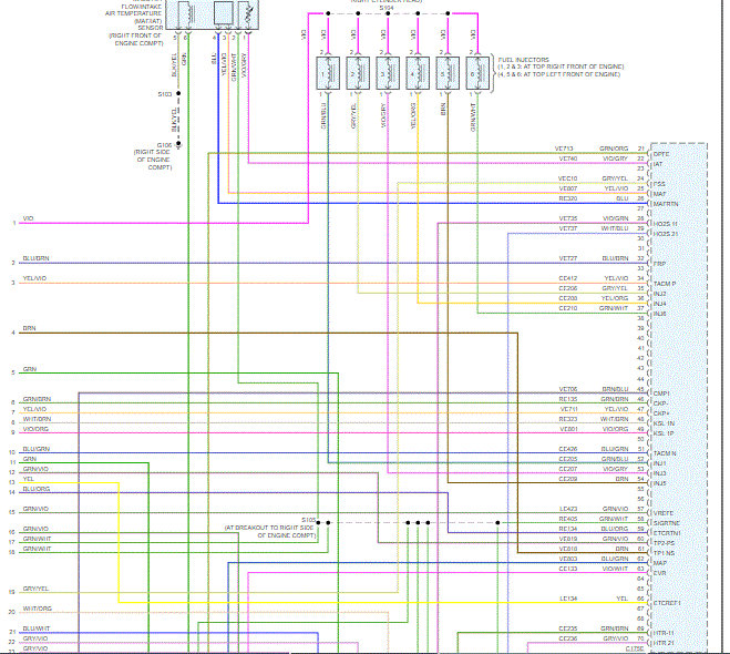

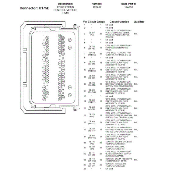

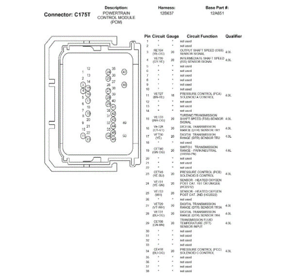

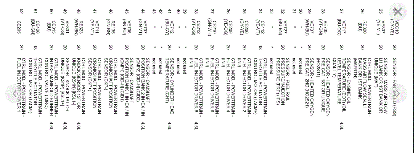

I attached the diagram for you to view.
Let me know if you have any other questions.
Aug 31, 2020 at 8:47 AM
B_ALZUABI77
  • 25 POSTS
And does MST9000 has this PCM model? And does this PCM have specific models type or name?
Aug 31, 2020 at 11:25 AM

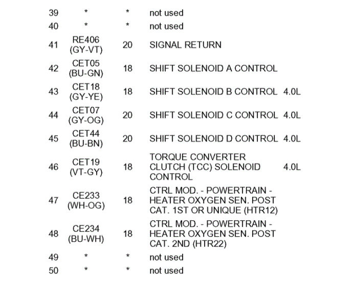

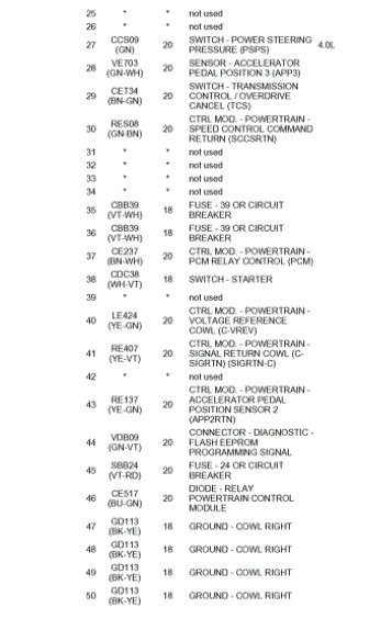

I gave you the pin out for a 1998 Explorer. It is for both engines. The 4.0 and the 4.6.
If you are replacing the ECM, it must be replaced with the exact same part number.

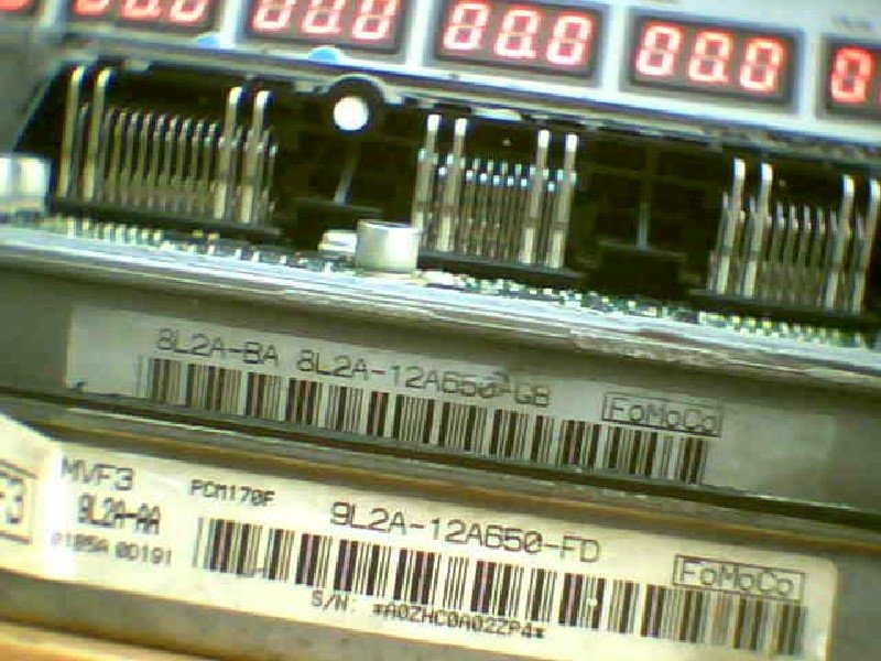

I got you now I am trying to up load pictures to show you my ECU but i can't.
Its 170 pin 2008-2009 Ford Explorer. I am electronic engineer and i switched to automotive electronics maintenance, I bought ktag and kess and mst9000 because i have 2 PCM i love to fix it. I am establishing now my new work shop, and looking for more help, as i ordered Alldata software but it's on the way to me.

Look at my first response and all the diagrams are there.
Sep 1, 2020 at 1:01 AM
B_ALZUABI77
  • 25 POSTS
Sorry to annoying you, but all you sent are for 12A651.
what i need is 12A650
(8L2A-BA 8L2A-12A650-GB).
Thanks Bro.
Sep 1, 2020 at 1:06 AM
As I stated before, the diagrams are for both ECM. The 4.6 engine and the 4.0 liter engine as well.
Sep 1, 2020 at 1:10 AM

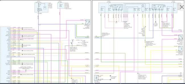

I would like to ask how and where to connect ISC signal from MST-9000 to Ford PCM?
I have the automotive simulator and i would like to test the PCM.
There is pin named ISC and i can't find it in Ford PCM 12A650.
So what is the synonymous for ISC.
And how can i upload pictures here?
Sep 2, 2020 at 11:41 PM
Are you referring to the idle speed control?
Sep 3, 2020 at 2:50 AM
B_ALZUABI77
  • 25 POSTS
Yes, its idle speed control valve drive.
And PFC : ignition driver.
And is at allow to post pictures here?
Sep 3, 2020 at 3:10 AM
With the engine off, you should have 12 volts and a return to the ECM at the ISC, with it running, it will be pulse width modulated. If the check with a voltmeter, you should see around 7 volts to be sure the ECM is commanding it.
Yes, you can post pictures to this post.
Sep 3, 2020 at 3:15 AM

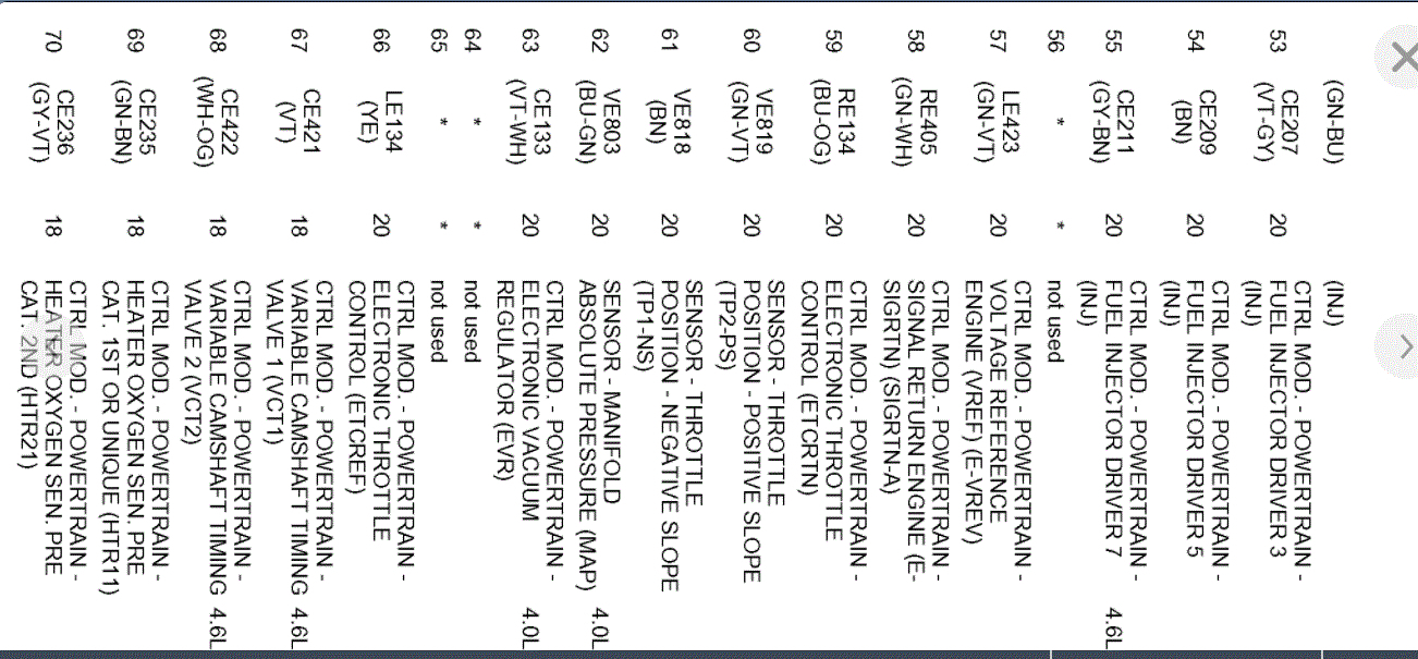

Cool,but which pin in PCM is the ISC and PFC?
How can i post pictures here? Because i tried to click on add Image or video but does not work.
Sep 3, 2020 at 3:22 AM

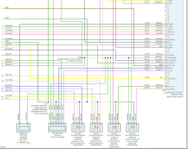

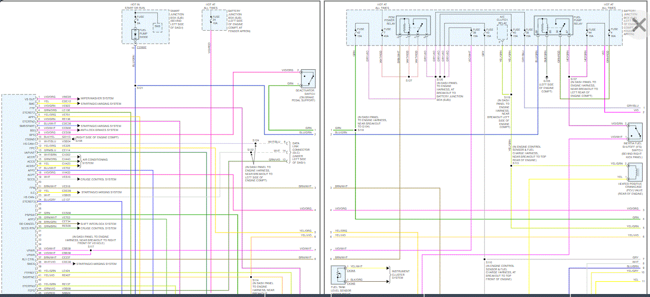

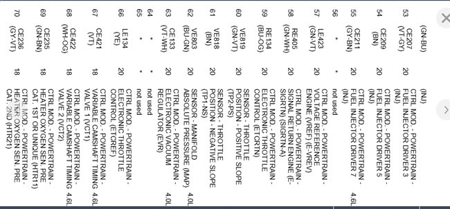

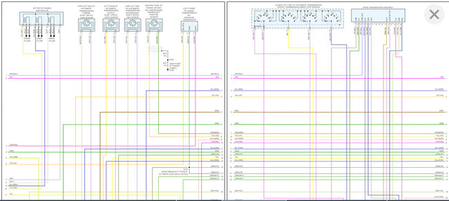

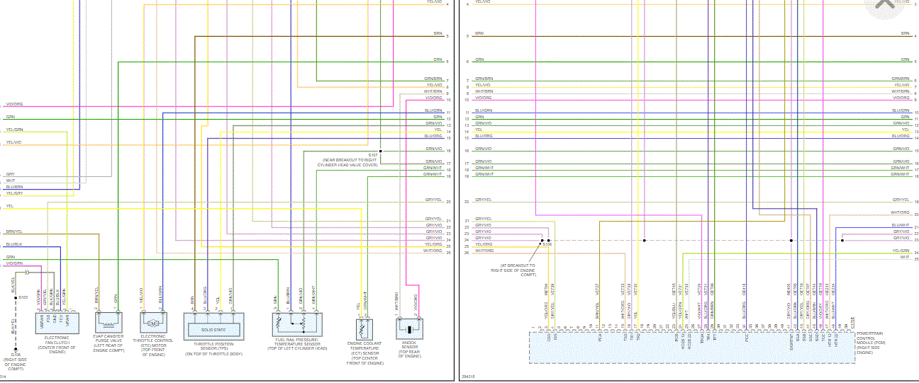

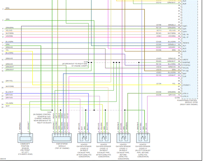

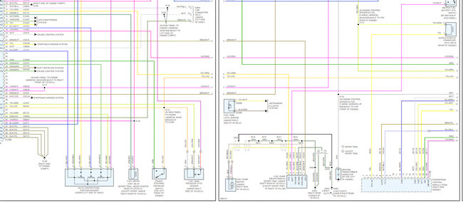

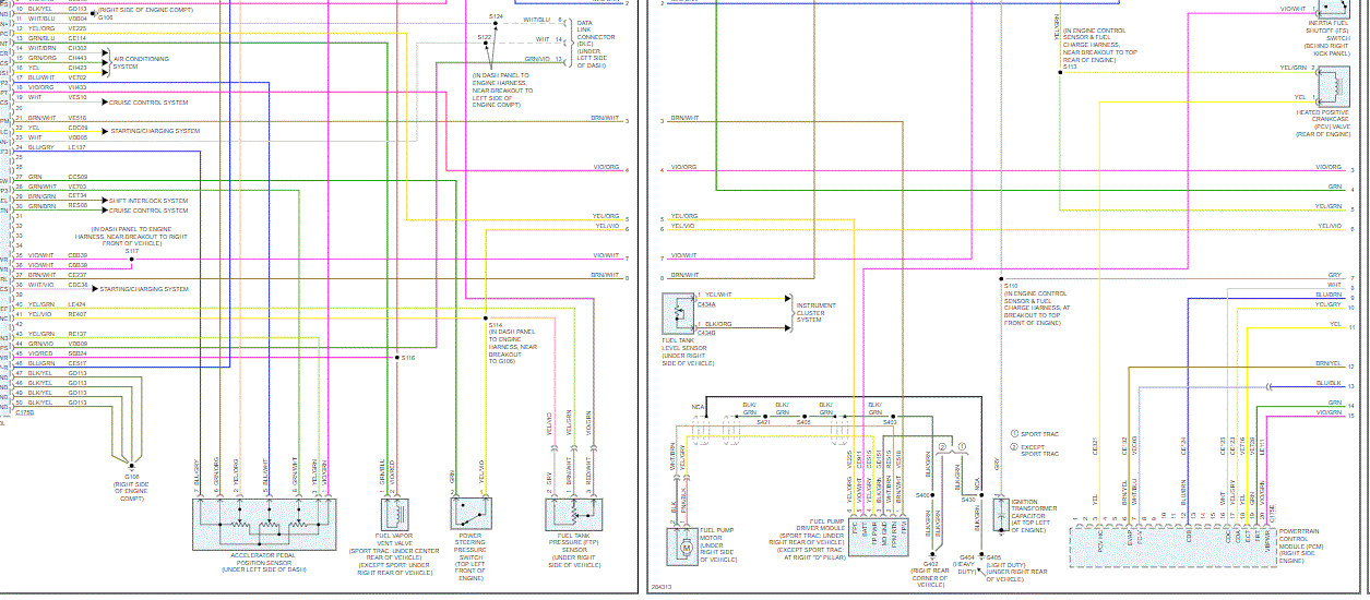

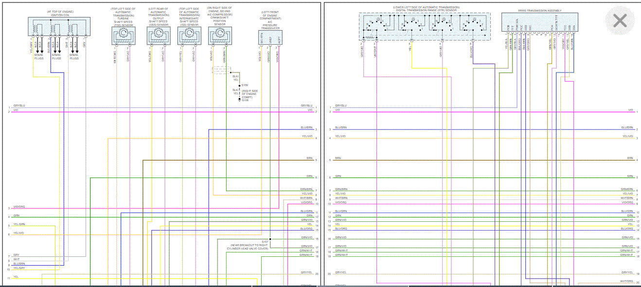

Okay, I attached the complete wiring diagram of the system for you to view so you can find colors and pin number.
Sep 3, 2020 at 3:38 AM

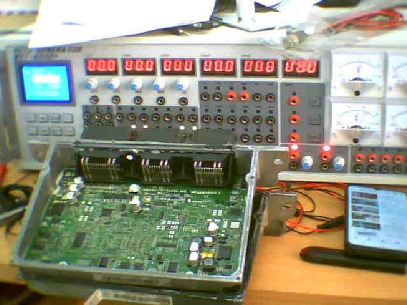

Hi all
I have this 2 Ford ECU, how to connect them to mst 9000 for run and check the out out INJ and IG???
Sep 3, 2020 at 9:26 PM
Cannot answer that. That is specialized equipment required for that.

Cool,
So if you have this PCM ? What are going to do to test it??
I connect B+ and GND.
But the mosfet will not run without signal.
Do you prefer to test the components with multi-meter?
Sep 3, 2020 at 10:01 PM
I do not and never will test it.
I do all the testing around it to verify everything external is working correctly. Once I narrow it to the ECM, I replace it.
I do not care what is wrong with it. I replace it and move forward.
