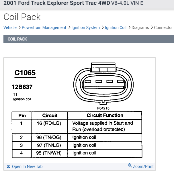

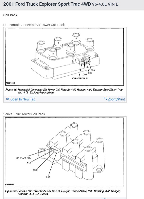

It sounds like you might have issue with the ignition coil pack.
Many times, these random misfires can be due to faulty coil pack. As one coil pack controls all the plugs, when it has internal failure, it can trigger the random misfire.
Here is a helpful guide:

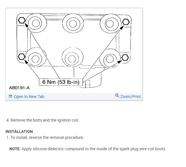

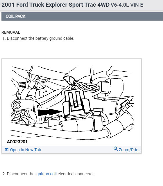

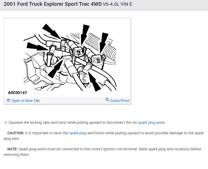

Suggested Repair
Test the ignition coil pack. A failing coil pack can cause cylinder 6 and random misfires even after plugs, wires, a fuel filter, and a PCM flash.
