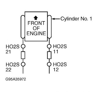

DGONCALVES
  • 17 POSTS
Okay, So you think problem may be a bad O2 sensor like technician said. I already had 1 replaced and mass air flow sensor too. Does that narrow it down to only a few? How many are there on this car?
Monday, December 21st, 2020 AT 11:21 AM
BMRFIXIT
  • 19,053 POSTS
https://www.2carpros.com/forum/automotive_pictures/99387_02_V6_15.jpg
