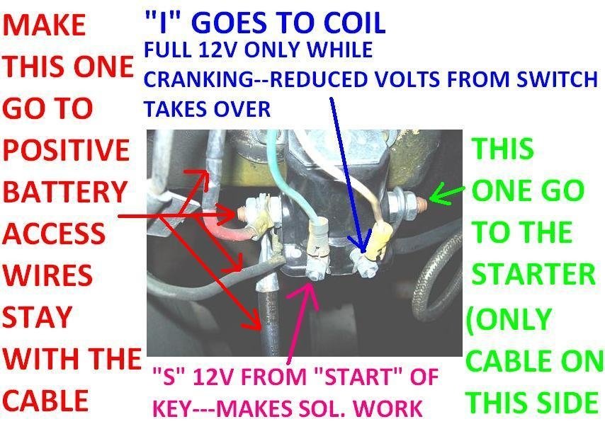

Pic 1) This is the way I wired my '46 Willys to be like my CJ 5. The wires on the big posts can be swapped, the starter is always by itself and the battery cable and those wires stay together. "S" and "I" cannot be swapped.

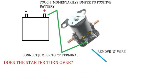

Remove "S" wire from the solenoid. Touch a wire from the Positive side of the battery to "S".
Yep,
If it works, you probably wet your pants, the initial bump will startle you!
It should crank, verifying the solenoid is good.

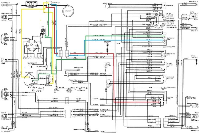

I took two halves of a diagram and made it into one (courtesy of Prodemand) I colored the wires for "starting" and the "charging" systems. I will eventually color the whole diagram, which makes tracing stuff really easy.
You may find your issue by studying the diagram.

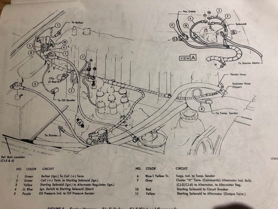

I searched for a couple of hours, but I can't find a wiring diagram that reproduces well enough to be of use. The best I could come up with is this one. The red arrow is pointing to the terminal that connects to the positive battery cable. There's often a second wire attached that feeds all the other circuits including the ignition switch, so that has to be connected for the starting system to work. The blue arrow shows where the cable goes down to the starter. There will never be a second wire hooked there.

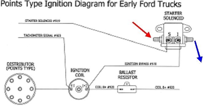

On Ford products, the plug-in "S" terminal is a red / blue wire. I've seen that drawn on the right terminal but I don't know if that was a mistake. On every one of these I've ever seen, the red / blue goes on the left, and some solenoids will have the "S" molded in to identify it as the "solenoid" terminal.
The "I" terminal on the right is for "ignition", meaning the ballast resistor bypass. That doesn't have to be connected for the starter system to work in this system. Don't forget, on some versions that is going to the neutral safety switch. In that case it must be connected for the starter to work.
If you don't accomplish anything else for now, use a test light to check for 12 volts on the red / blue wire when you turn the ignition switch to "crank". I doubt you'll need it, but here's a link to an article on using a test light:
You can do this with a digital voltmeter too, but for this type of problem, those can potentially provide incorrect or misleading results. Current has to be able to get through for the solenoid to work, and it must be able to get through for a test light to work.
I'm going to look for a better wiring diagram at home, and if necessary, we can get CJ Medevac involved. He's a "Heep" expert.

1) "Remove "S:wire from the solenoid, tough a......" Answer> No, it did not crank, no spark I then took a heavy from positive battery to starter connection post and it did crank, tried two to three times and cranked.
2) Battery showed low on a cheap battery tester , showed 10.70 on HF Centec and showed 12 on SunPro set at High and Volts.
3) "Now lets test the "S" wire. Removed from Solenoid....." Answer Yes, I got 12 volts. This was a big success.

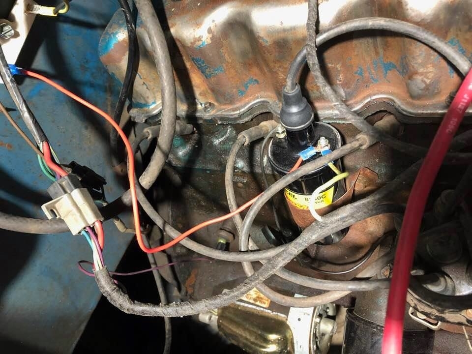

4) 'While Your at it Turn key to On, test positive side of coil" Answer Zero (0). Tested coil volts w ballast connected and disconnected.Zero (0). Note that I may not ( probably did not) re-attache the blue S wire back tot he solenoid. Do I need to do that to test the coil?
Coil is a new Accel 8140C. The old coil I removed was a 12 volt and said "Use with external resistor" May still be good. i keep all parts removed from CJ5 and date and store them.

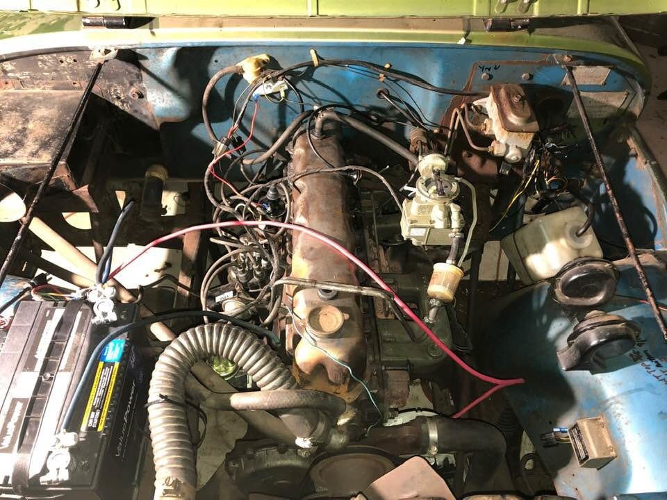

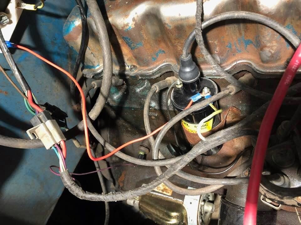

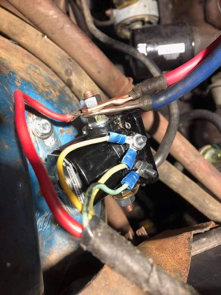

Send a picture of your solenoid
Heck, left, right, and overhead of your engine with the breather off.
We'll get there, I'll stick with you.
The Medic
Mar 25, 2019 at 7:43 PM
JAY BIRMINGHAM
  • 18 POSTS

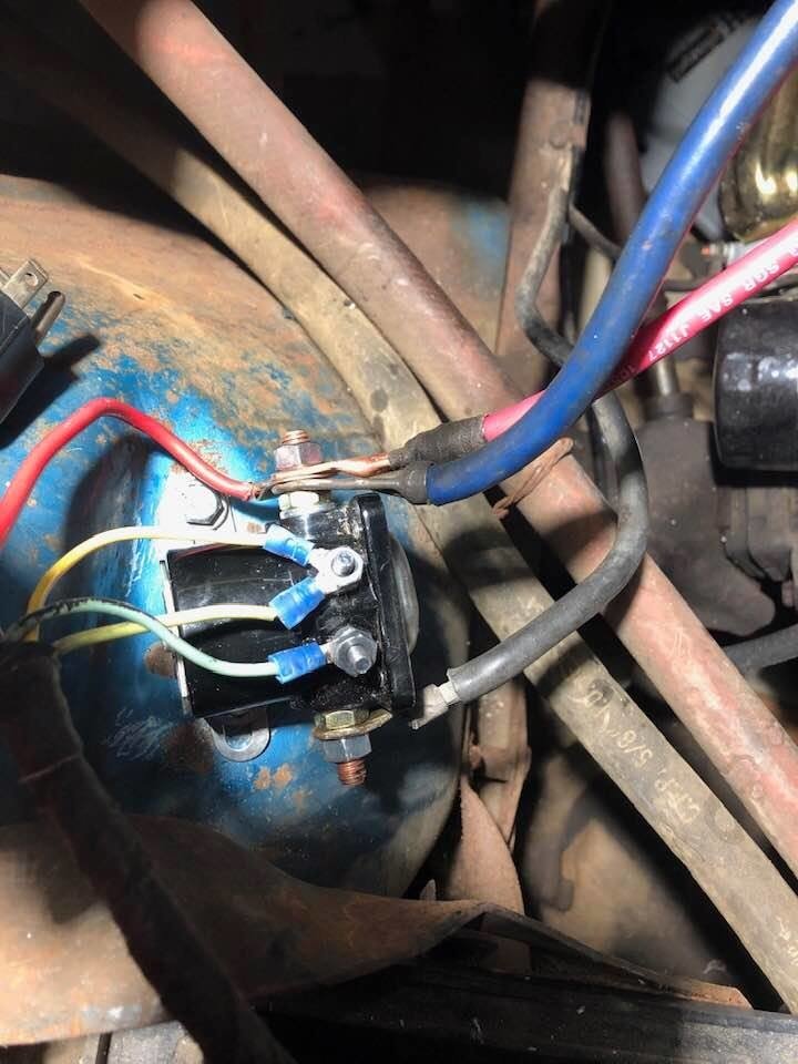

New solenoid. I also scuffed the fender well with a file to help it ground to the new chrome solenoid bracket. Will REM and scuff them both tonight and clean with some elec term cleaner. May try to ground it out on the negative battery post too, unmounted. I was able to bench test it and did get the solenoid to switch last week. I can also bench test the old solenoid and put that back online. Sunny skies tonight in Delaware!

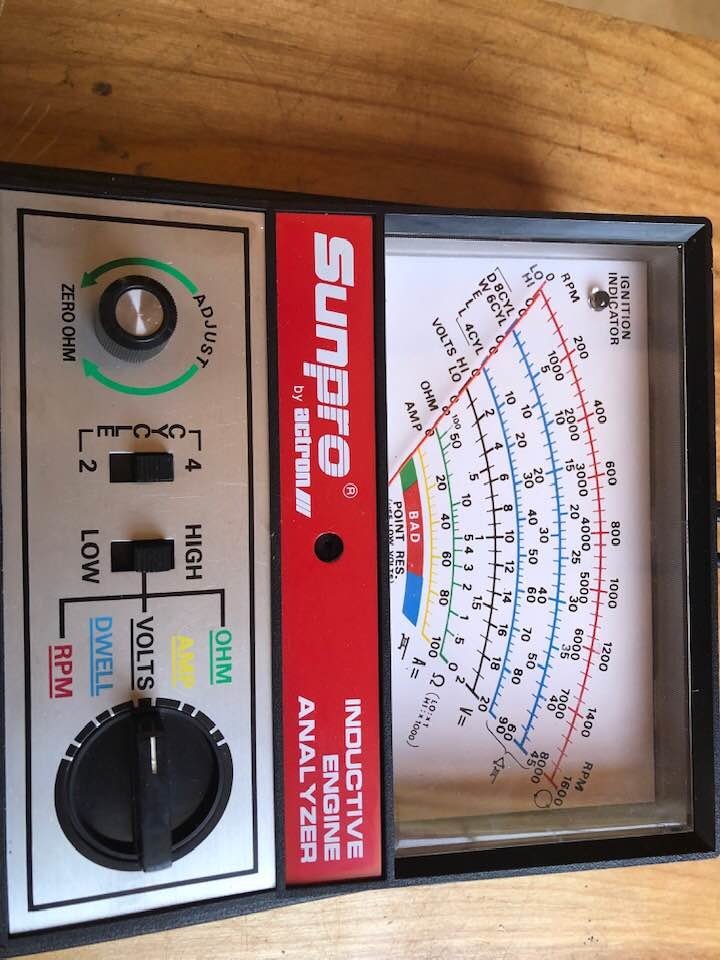

4)Reconnected SunPro, Volts>High>4 Stroke, Get 3 volt with no key in, get 12 volts at "On":

Explain this, is this the voltmeter we're talking about? SunPro, Volts>High>4 Stroke
Tell me what's on the solenoid. I see the starter, I see the battery.
What's the other big cable?
Where is "I" going to?

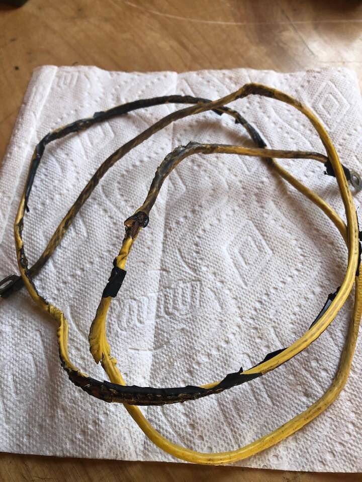

Th other two things on the battery cable post n Sol. are the large red that I made to replace the burnt yellow that went to the alternator. Original cause for all this. The other red is a main the goes into the circuit, looks like up to the firewall connector, over and may terminate at the ignition . I have tested it from the back of the ignition to the solenoid for continuity.

Yes, all tests were turn to try and start the car. Yes, only one bump. that one time. I have an old SunPro Volt/Ohm/Dwell meter that I have kept in a good case and taken care of. I set it on Volt test, make sure it is set on High (vs Low for low volt batteries) and 4 stroke vs. 2 stroke setting. I will send a picture. These two pictures are from 1972 Jeep Shop Manual.

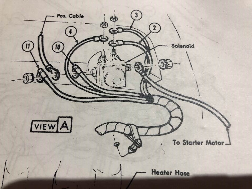

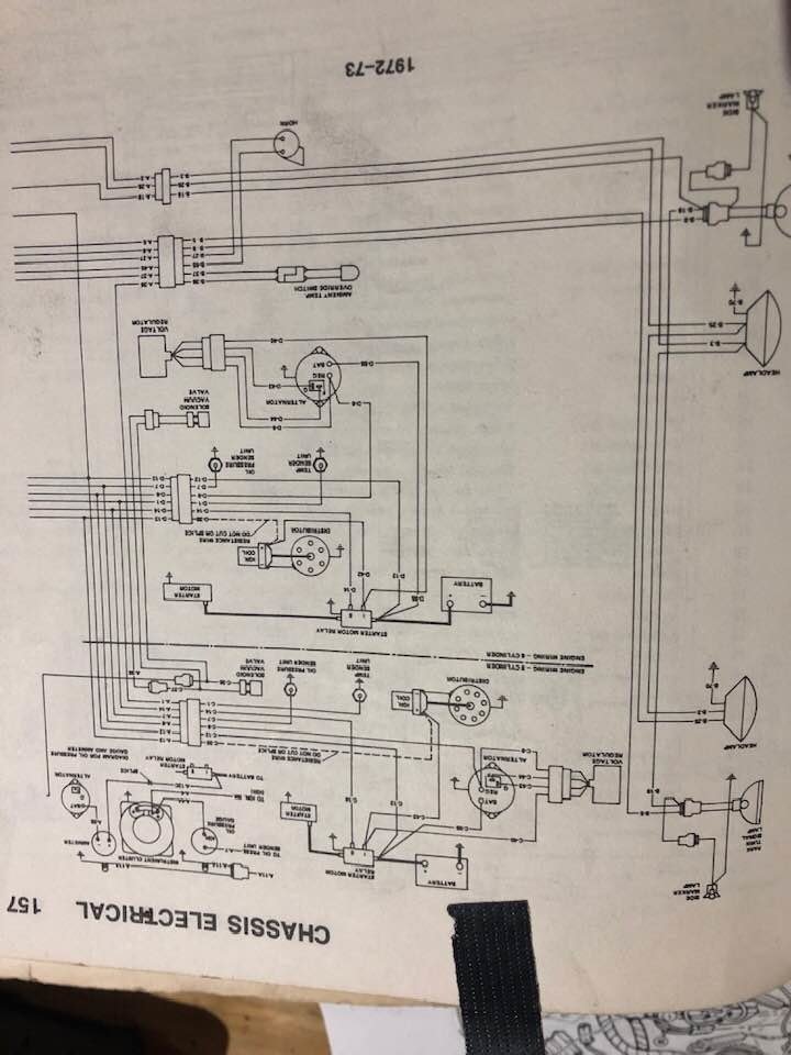

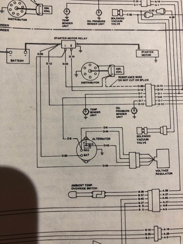

These two images are from Chilton. I also have the Haynes. and will send PICS tonight. Thank you for your service. Note also, when I just use batter POS cable to Starter Cable, by hand, mid air, not connected to anything else.I can crank it over all day. Do I son't think it is a Ground from Engine Block to Neg Battery issue.

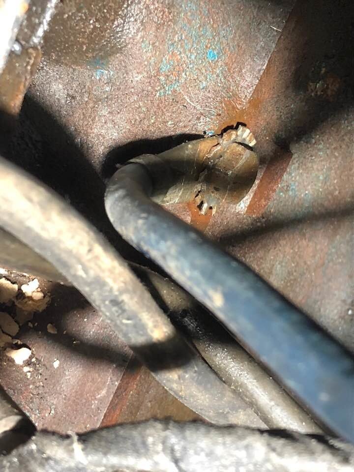

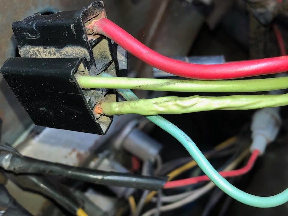

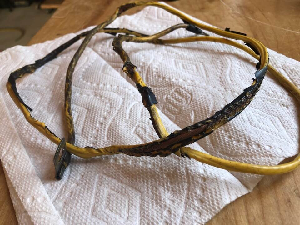

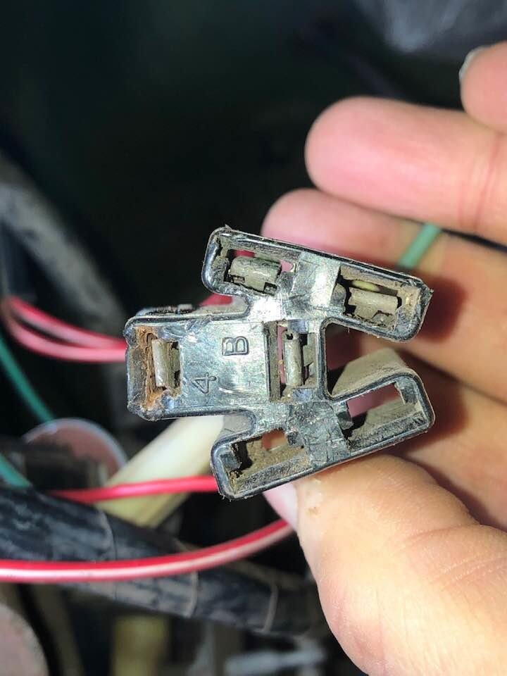

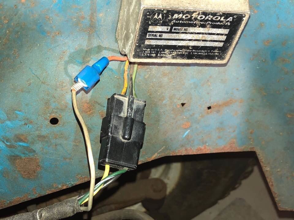

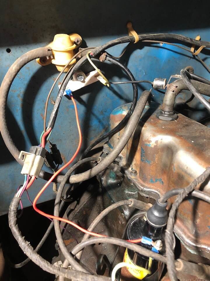

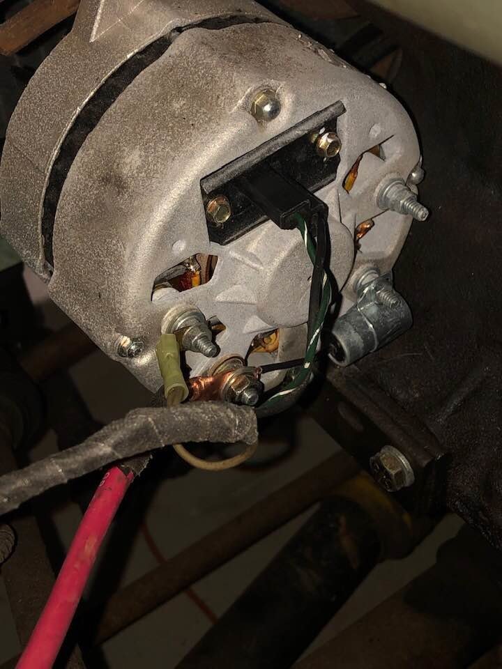

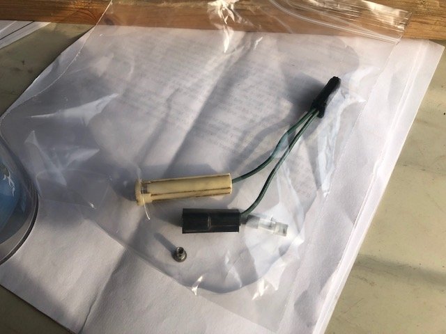

Three pictures attached. Two are the burnt down solenoid to alternator wire that I replaced with Red 6-8 AWG. The burn occurred when i may have tried to connect the battery while the ignition was on or I may have tried to connect the battery with positive and negative inverted and to the wrong battery cable? I am unsure. Burn down occurred and I could not start since then. Great Jeep!

The heavy blue cable goes to positive battery.
The heavy red stacked against the blue is the alternator.

Yes - The heavy red stacked against the blue is the alternator. Yes- and the small red in between is going to the harness up to firewall, into behind dash.

You have two different solenoids. When it needs the mounting bracket grounded, that is required to work that way, and the new one must be the same. The second small terminal is for the ignition resistor bypass. If you did have a neutral safety switch or clutch switch, it would be in series with the small wire plugged in on top to the first small terminal.
It sounds like your second solenoid uses the two small terminals on top for the actuating coil. Those have no connection to the mounting bracket. They're typically used with electronic ignition that has no ballast resistor to bypass during cranking. That's the terminal that would go to a neutral safety switch or clutch switch if you had that.
