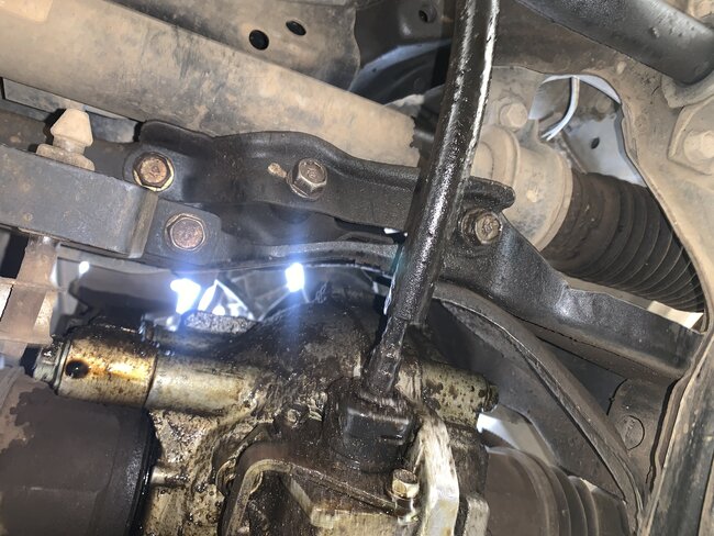

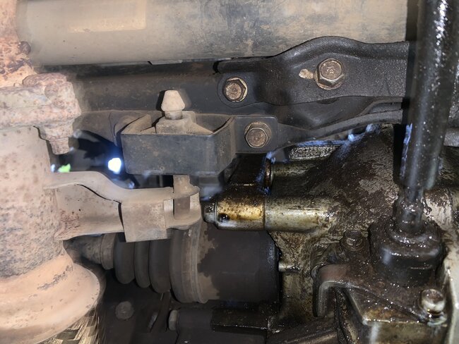

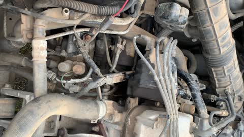

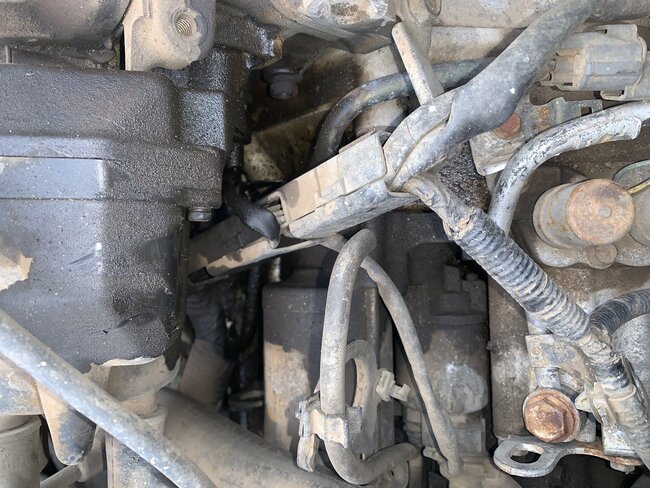

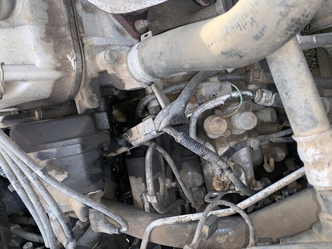

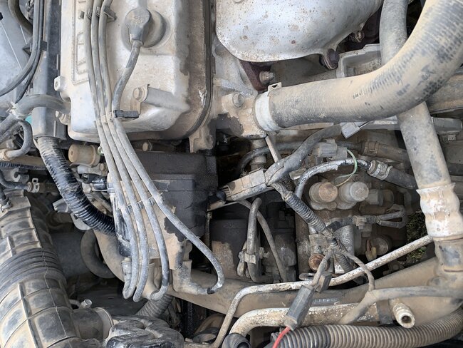

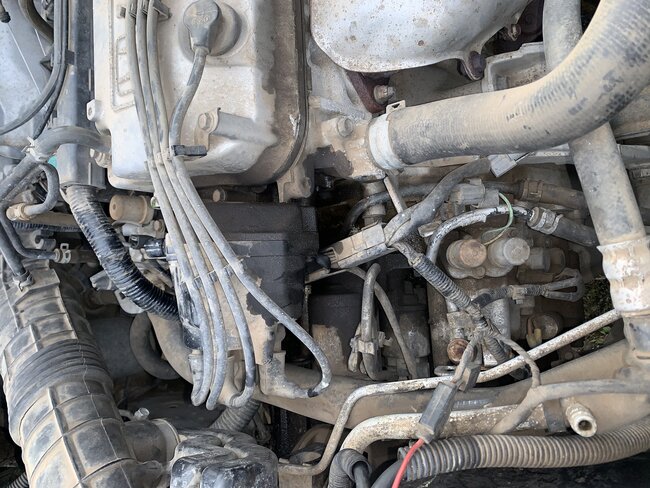

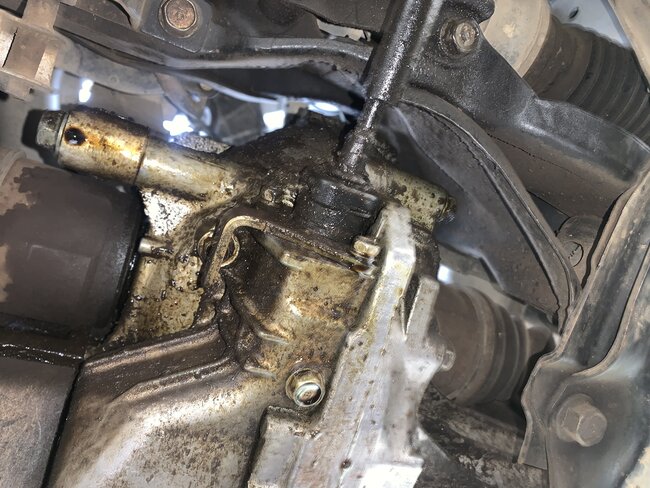

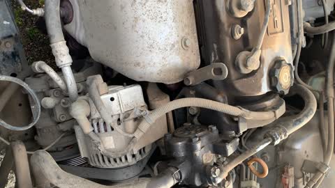

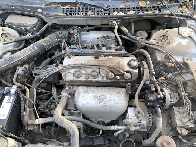

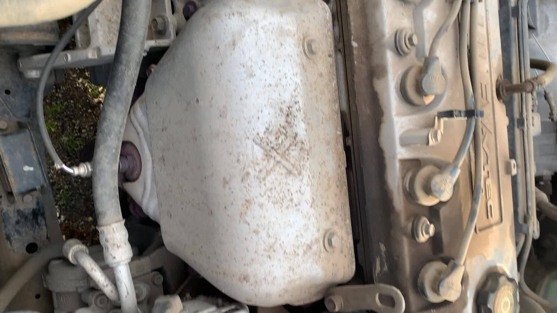

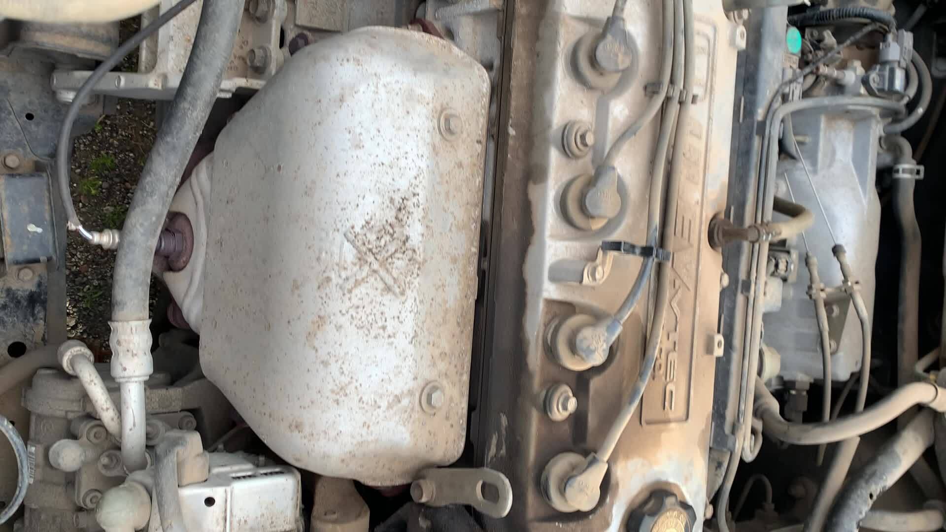

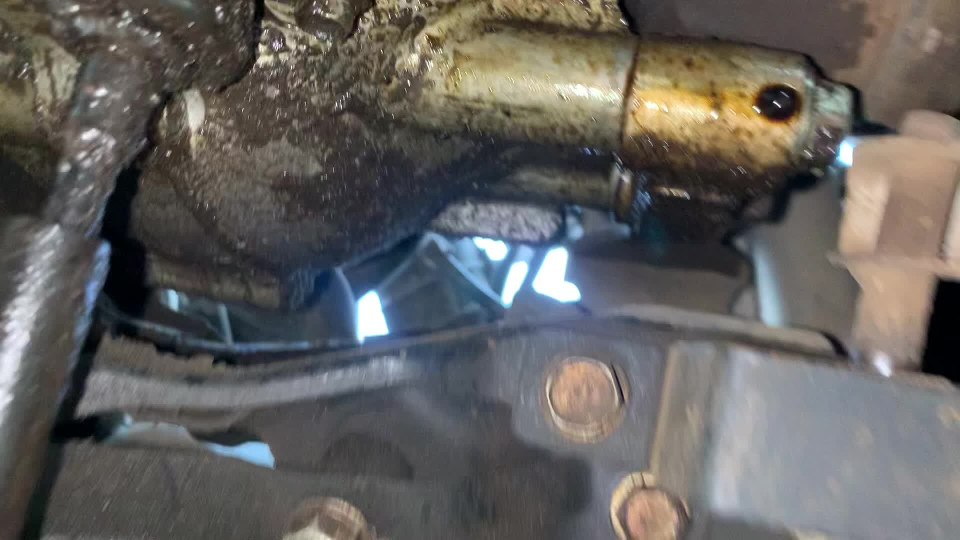

Hello, my car is leaking oil. I would like to know where the oil leak might be.

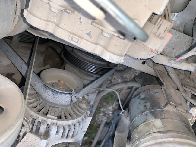

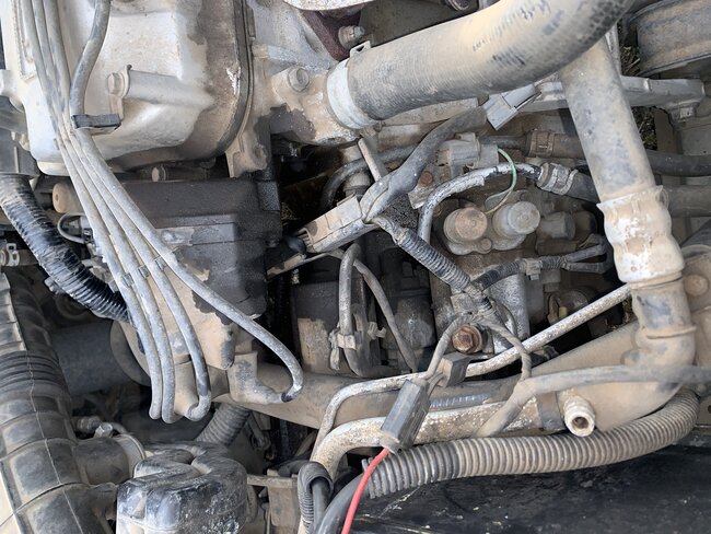

There is an oil stain on the right and left side of the engine. The stain on the left side is beside the serpentine belt. My serpentine belt looks worn out so I am going to get it changed but I'm not sure if a worn-out serpentine belt can cause an oil leak. The oil stain next to the serpentine belt looks and feels old but the oil stain from the left side feels recent. I took several pictures and a video from under the left side of the car and noticed the oil looked and felt recent. I apologize for the poor video quality from under the car, I didn't have the tool to lift my car up to take a better video so I just took the best video I can. I'm not sure if it's relevant but I recently got an oil change. All in all, it's unrealistic for me to ask the exact location of the oil leak from just a few pictures and videos so all I ask is to for you to give me your best guest, I greatly appreciate it.

Good morning, AVID LEARNER,

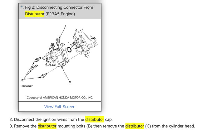

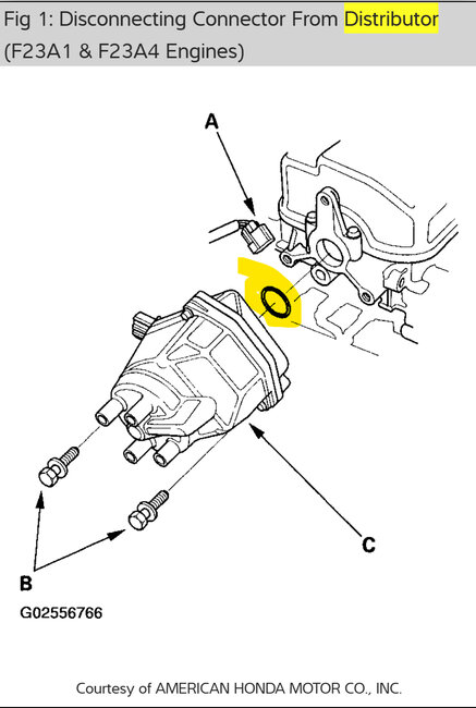

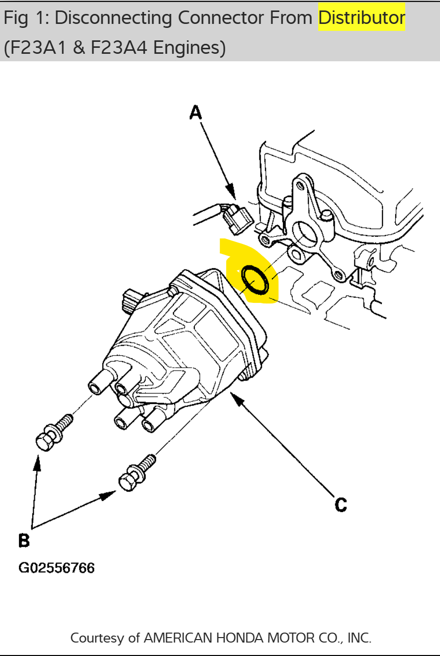

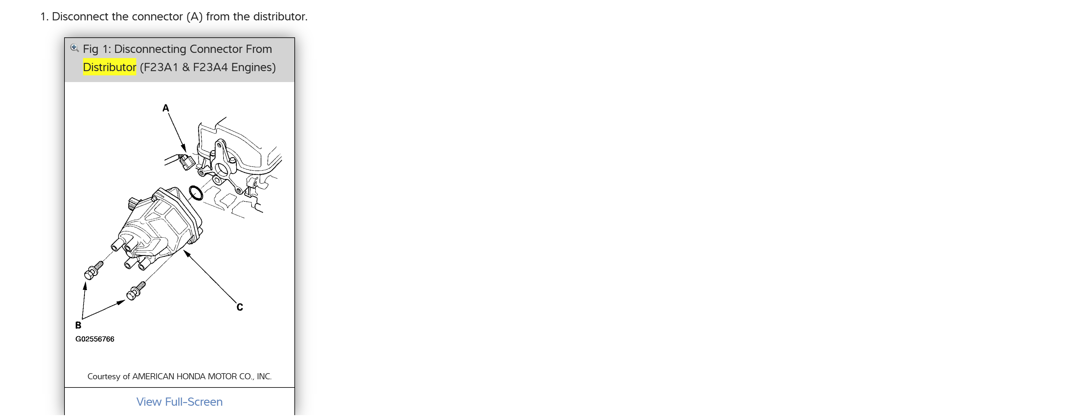

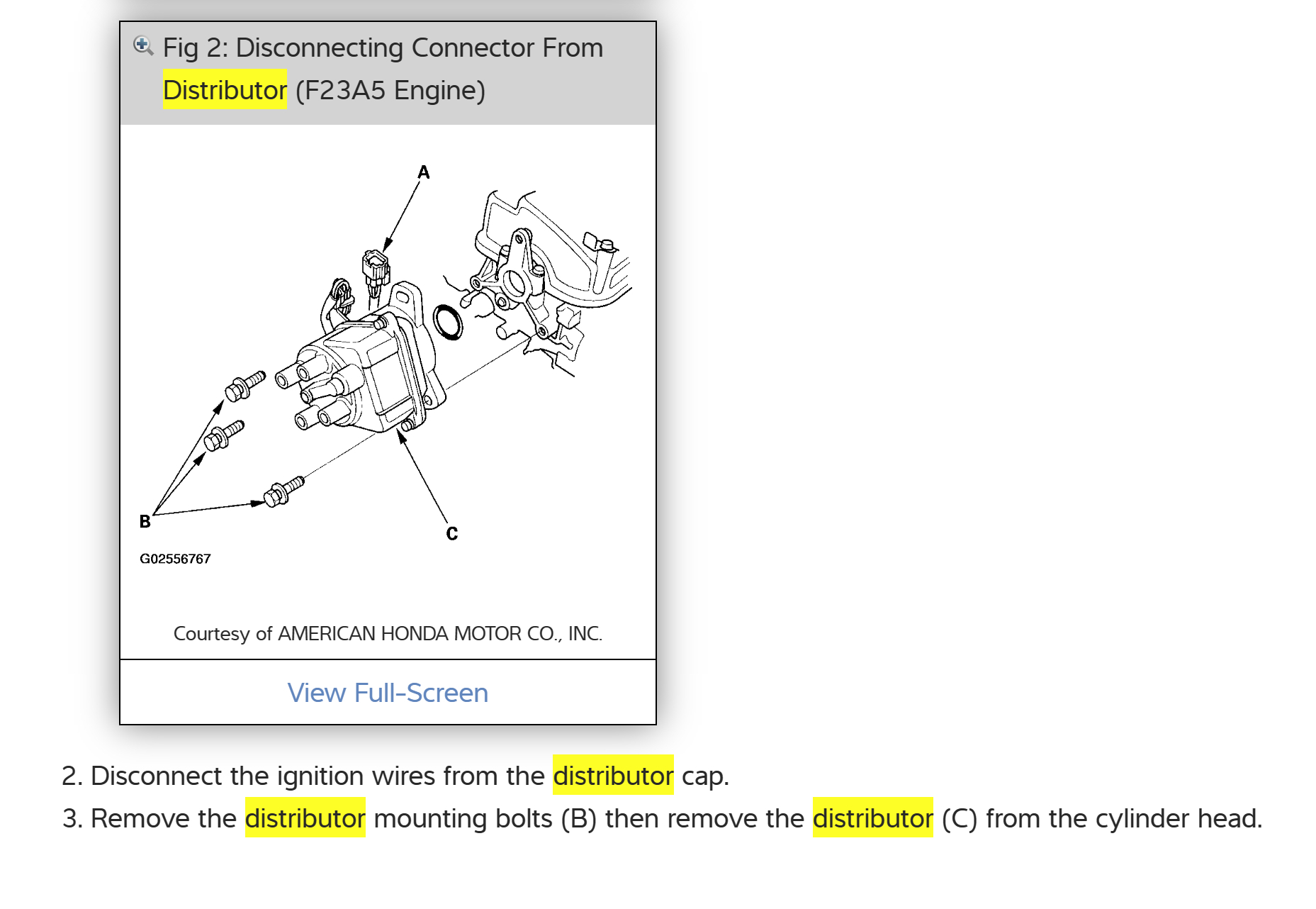

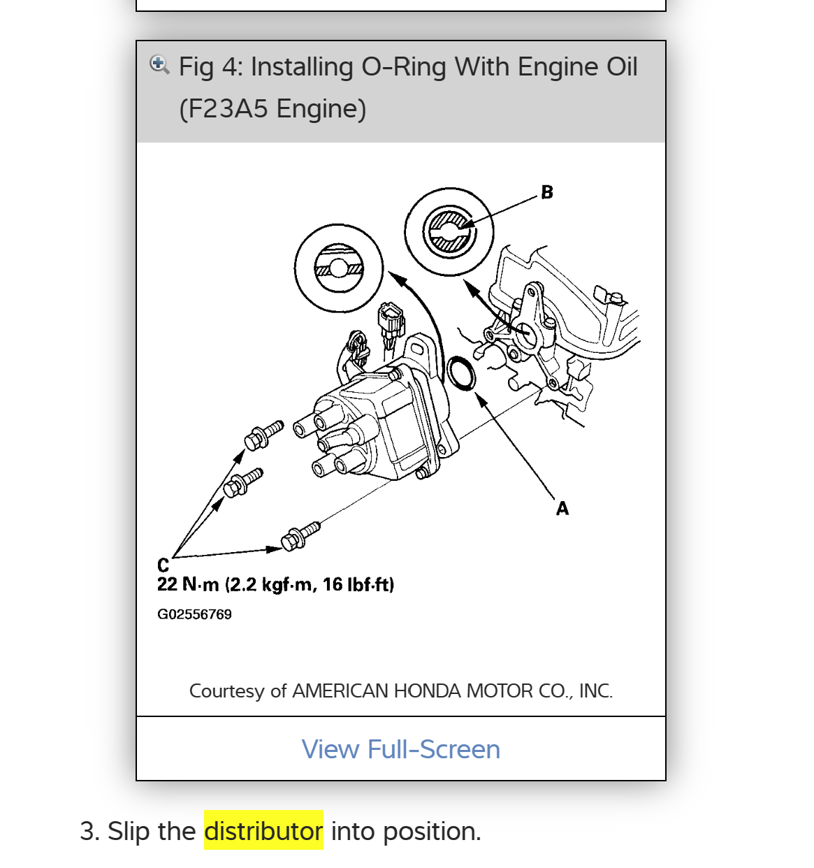

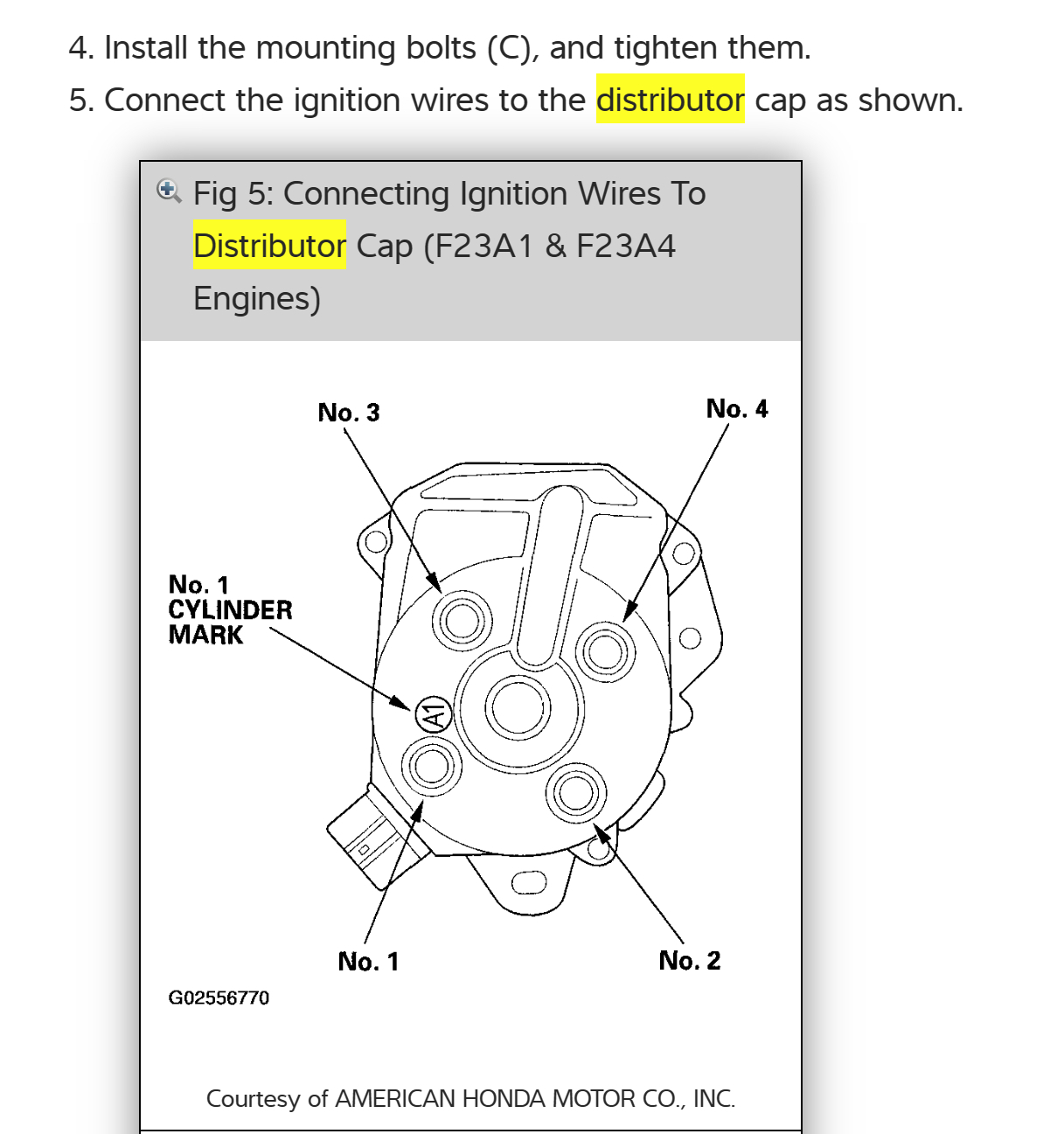

A worn-out serpentine belt won't cause an oil leak but an oil leak that gets on the belt could cause it to degrade. It could be the O-ring seal behind the distributor on the passenger side. I am adding a picture of this and instructions on how to replace it. It's very easy.
The instructions have you take the spark plug wires off, you don't need to do that because you are not replacing the distributor. Just need to remove the bolts, unplug the connector on the side and pull it off. Take note of its position for installation.
Then coat the new seal in a little oil with your fingers so when the distributor is installed it slides right in and doesn't tear the new seal.
I would recommend getting the seal from the dealer that way you know it fits. You will need to bring your VIN. Last thing you want is it to leak again cause the seal from the auto parts store isn't the right thickness.
The driver's side it looks like it might be a line on the power steering pump or valve cover gasket.
I would clean the engine with brake cleaner and a rag. Having an engine soaked in oil is not only a fire hazard but makes it a lot harder to find other leaks. Since it seems like you may have multiple leaks, it's a good idea to fix one, clean the engine, and let it leak again so you can pinpoint where it is coming from.

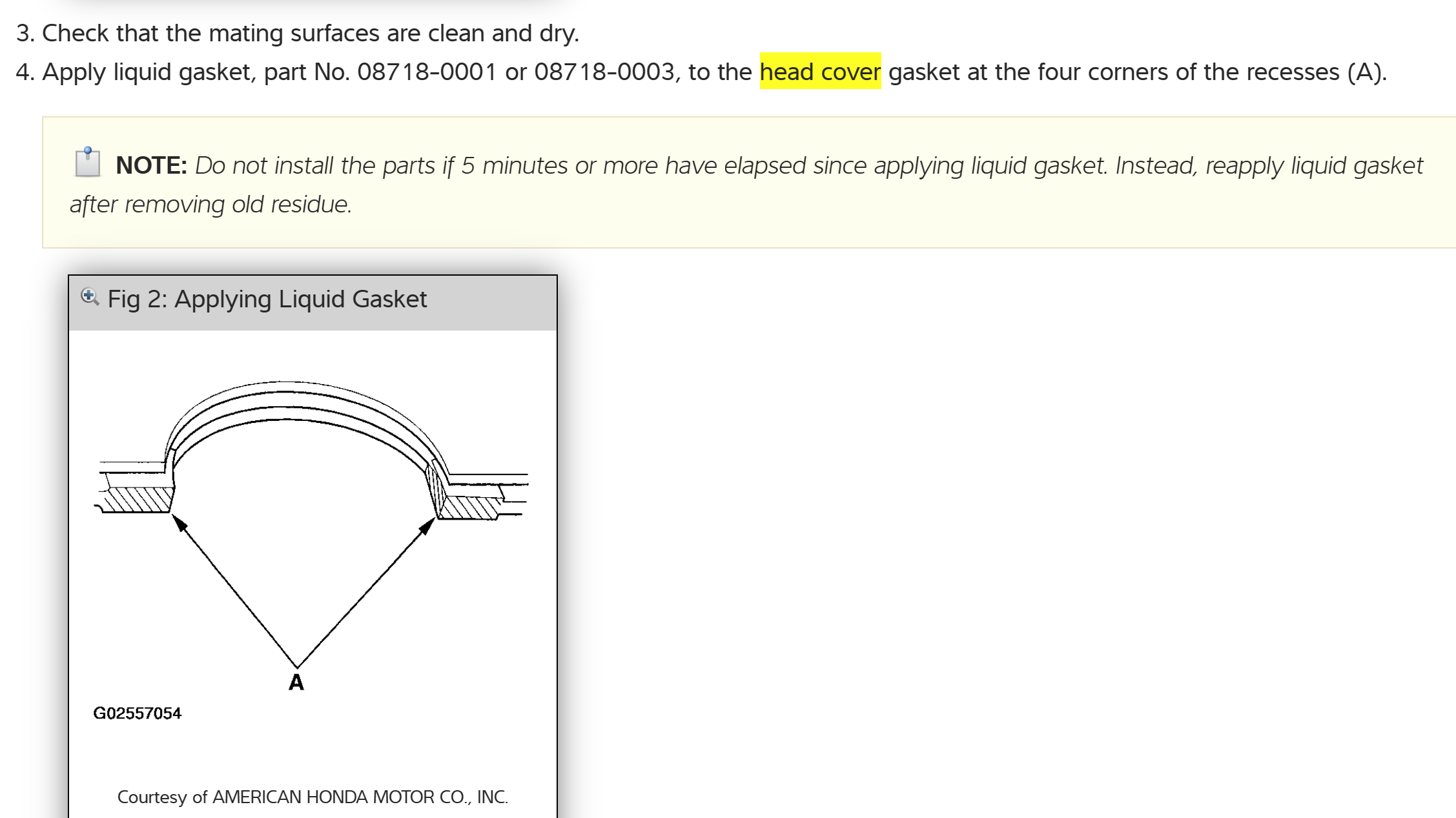

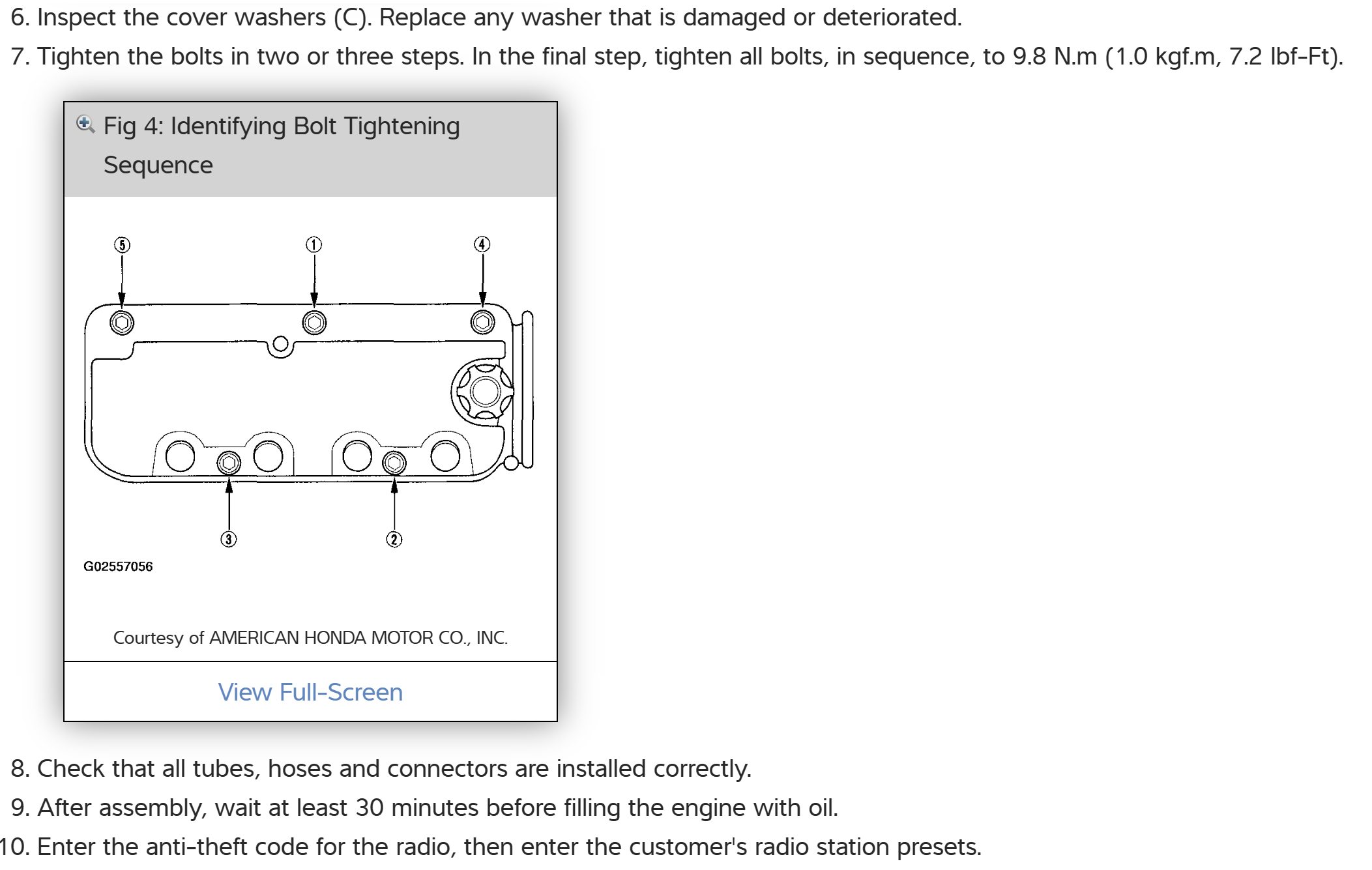

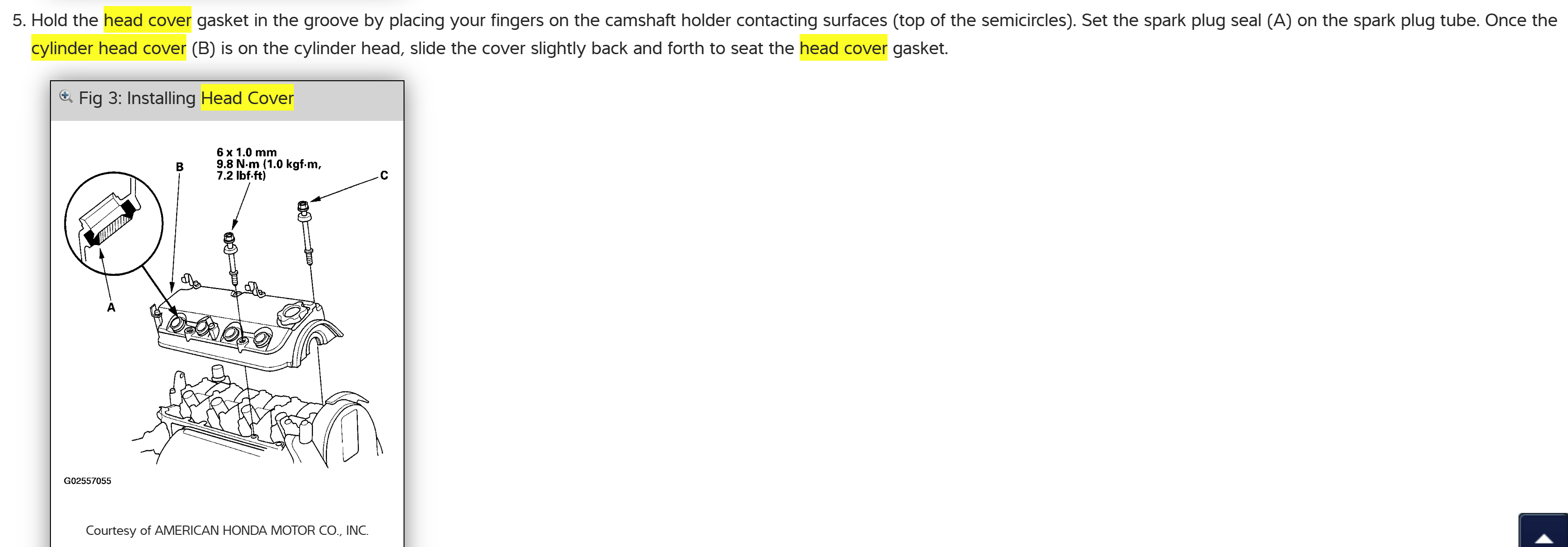

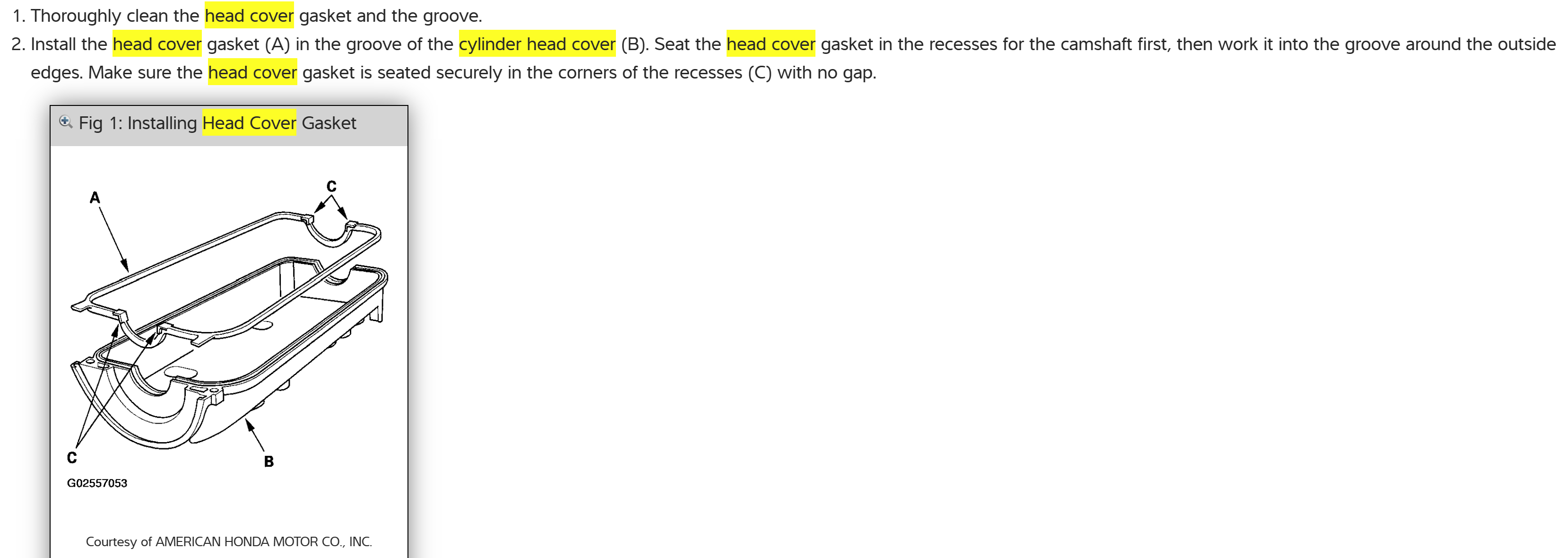

I am adding the procedure for replacing the valve cover gasket for you in case you need it. In these instructions there is no removal procedure.
So here is how to remove it:

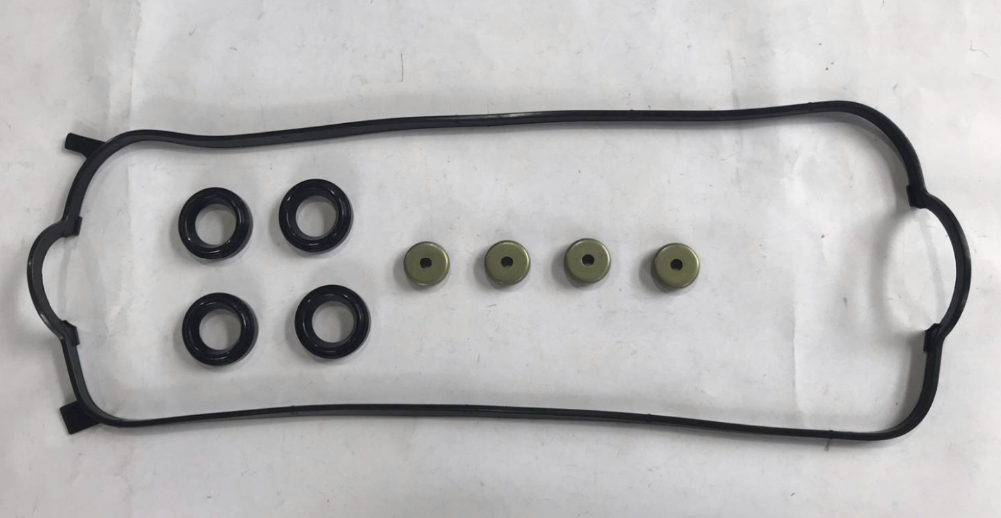

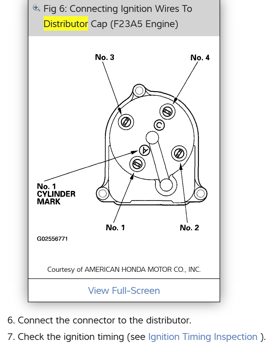

I would use a piece of masking tape on each plug wire and number them according to the cylinder locations. Cylinder 1 is closest to the serpentine belt. Next to it is 2 and so on. Once they are labeled, carefully remove the wires leaving them plugged into the distributor and set aside. Remove the bolts holding the valve cover on and remove cover. Once removed follow the installation instructions provided.
In these instructions it refers to using liquid gasket at the four corners of the valve cover gasket. I suspect this is where the leak may be. I would use Permatex black RTV sealant that you can get from the auto parts store. I will add a picture of this for you.
Make sure to clean everything well.

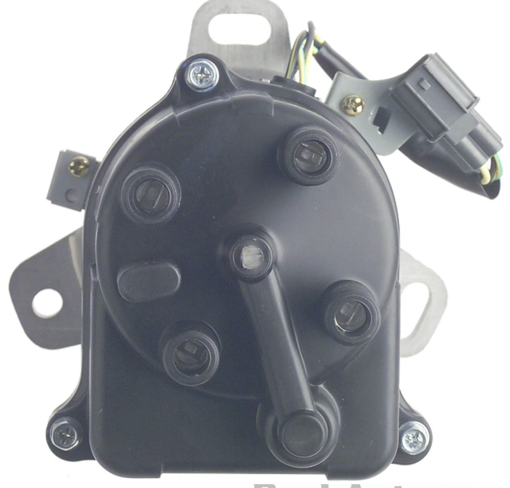

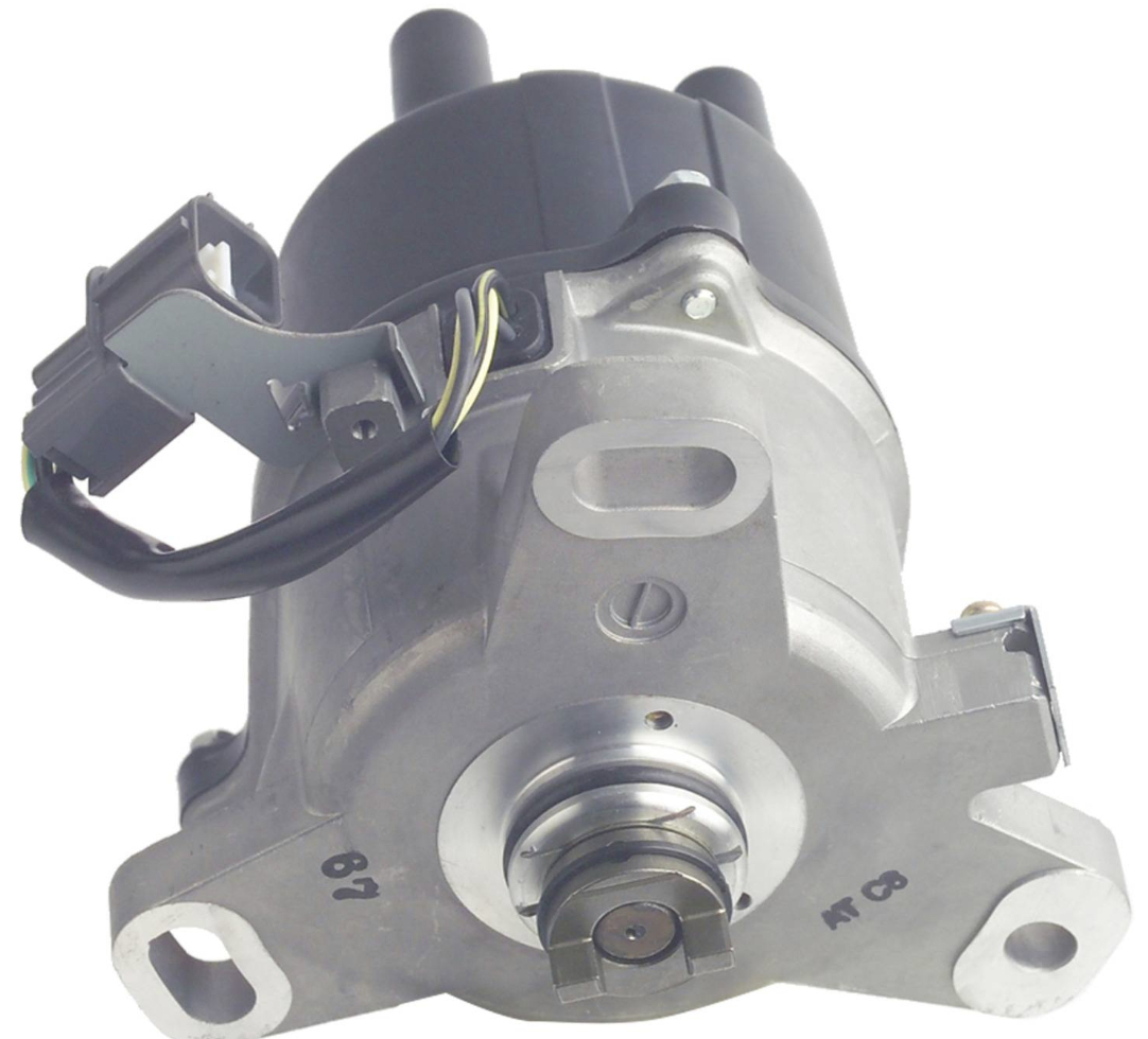

Leave the wires right on the distributor cap. The distributor on your vehicle can only be installed in 2 ways. So, snap a photo or 2 of how it is positioned. Remove the 2 or 3 screws (depends on the engine code) and gently slide the cap off.
If the seal is bad in the distributor, you will more than likely have oil in the distributor, inside the cap or the cap seal may be swollen as well.
If there is then the distributor will have to rebuilt in order to replace the second seal. In my opinion I would just get a whole new distributor at that point. To me it’s not worth rebuilding things anymore especially if your only vehicle. There is one on Rock Auto that is $148. To me this better than rebuilding it because it will be new and clean and won’t cause you anymore problems.
If there isn’t then you can just do the O-ring on the shaft. Unfortunately, with the amount of oil leaking chances are both gaskets are bad.

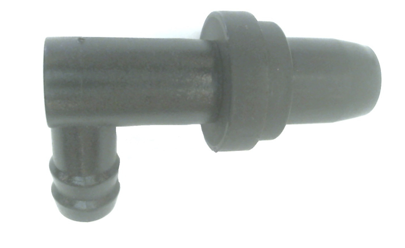

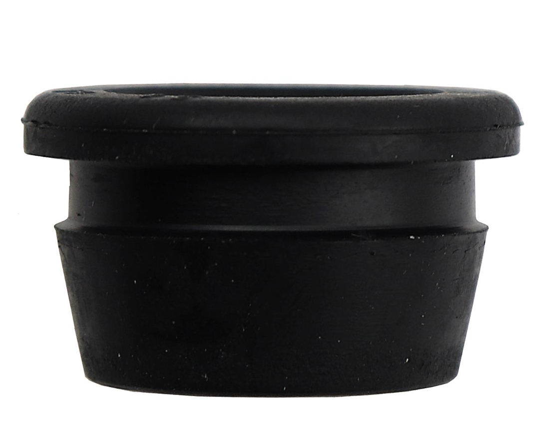

One other thing is yes, the car is old so it is going to leak but a lot of times the PCV valve can be bad and cause pressure to build up in the crankcase from something called blow-by gasses. These gases build up and literally push the oil out of your engine. If you haven’t replaced it lately then I would grab one. I will add a picture of it for you. You will also need the grommet for it. These parts are also from Rock Auto for less than $5. This will help prevent future leaks.
