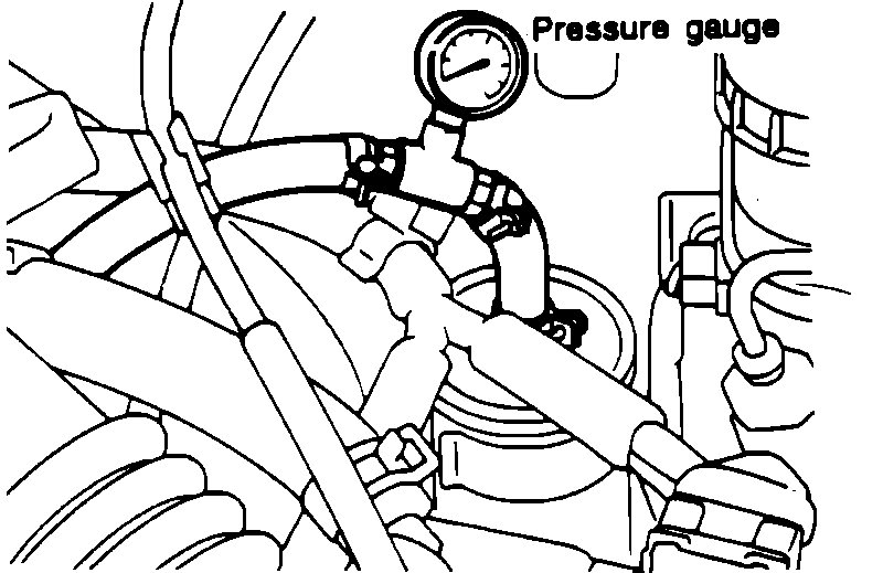

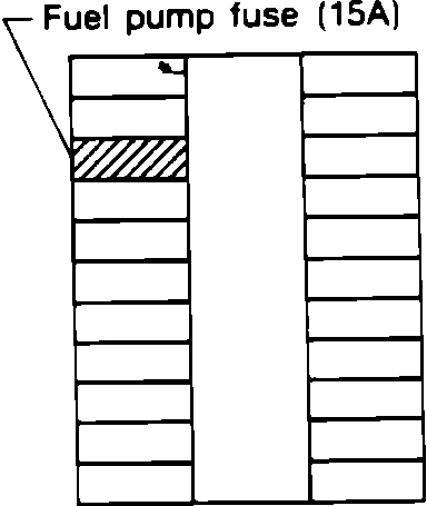

FUEL PRESSURE TEST
Fuel Pump Fuse
Pic 1
NOTE: To obtain an accurate fuel pressure reading the engine must by running. Basic fuel pump operation can be verified in a no start condition by observing gauge reading while cranking engine. Fuel pressure should be approximately 43 psi (294 kPa).
1. Remove fuel pump fuse from underdash fuse box.
2. Start engine.
3. When engine stalls, crank or attempt to restart engine 2 or 3 times to release pressure.
4. Turn ignition switch off and reinstall fuel pump fuse.
NOTE: Steps 1 through 4 are provided to release fuel system pressure to eliminate fuel spray.
Fuel Pressure Gauge Connection
Pic 2
5. Disconnect fuel line from fuel filter and connect a suitable pressure gauge as shown.
6. Disconnect and plug vacuum line from fuel pressure regulator. Connect vacuum pump to pressure regulator.
7. Start engine and idle.
8. Fuel pressure should be approx. 43 psi (294 kPa). If pressure is correct proceed to step 10, if not OK continue.
9. Using pliers, gently pinch fuel return line at fuel rail. If fuel pressure rises to approx. 43 psi (294 kPa) pressure regulator is defective. If pressure still is low or did not change, check fuel filter before replacing pump.
10. Slowly apply vacuum to the pressure regulator while watching fuel pressure.
11. Fuel pressure should decrease as vacuum increases, down to approx. 33 psi (226 kPa) at 20 in.Hg.
12. If fuel pressure does not respond to the application of vacuum, check fuel return line for restriction prior to replacing fuel pressure regulator.

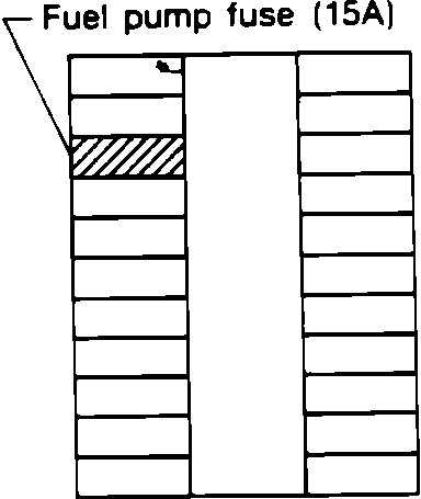

Fuel Pump Fuse Location
Pic 3
1. Release fuel pressure:
A. Remove fuse for fuel pump.
B. Start engine.
C. After engine stops, crank engine two or three times to make sure that fuel pressure is released.
D. Turn ignition switch off and install fuse for fuel pump.

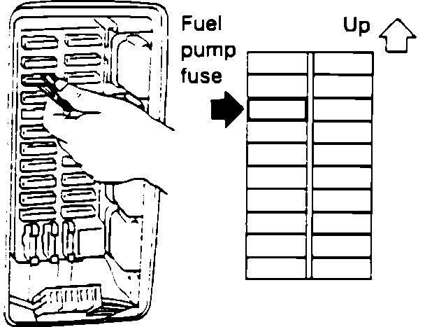

2. Remove rear seat bottom and back cushion.
Fuel Pump Access Cover
Pic 4
3. Remove Inspection hole cover.

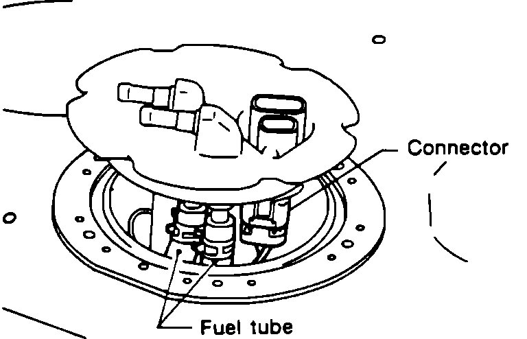

Gauge/Pump Assembly Removal
pic 5
TECH TIP: The sheet metal for the top of the fuel tank is REALLY SHARP! One way to protect yourself is to take some door edge moulding and apply it to the lip of the tank opening. Vacuum hose sliced lengthwise will work too.
6. Remove fuel gauge sending unit and disconnect the fuel hoses and connector.

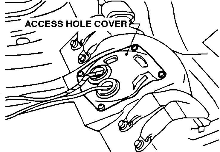

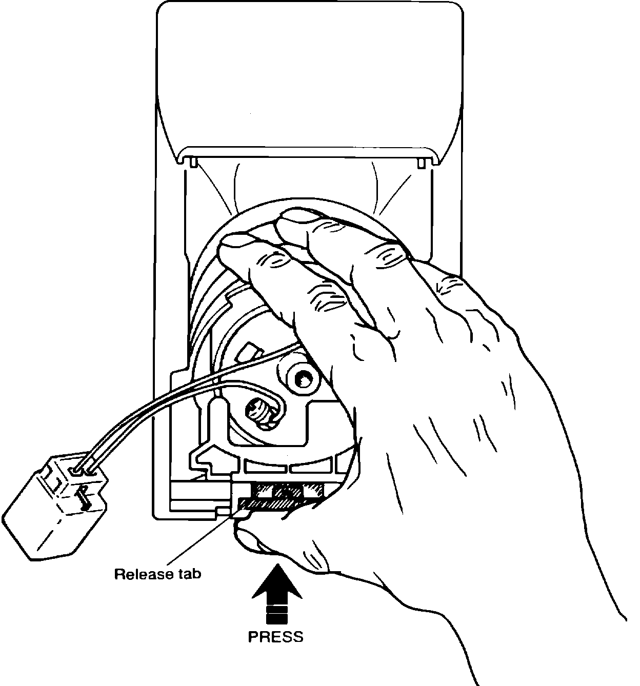

Fuel Pump Removal
pic 6
7. Remove fuel pump from fuel pump bracket by pinching the tab and lifting the pump out of fuel tank bracket.
8. Installation procedure is the reverse order of removal noting the following:
Always replace fuel tank O-ring with a new one.
Verify the two hoses to the plastic cover plate are installed correctly. The engine won't run if the hoses are reversed.
Tighten screws to specified torque 2.4-3.1 ft.lbs.
After installation, run engine and check for leaks at connections. Also verify the fuel gauge works.
