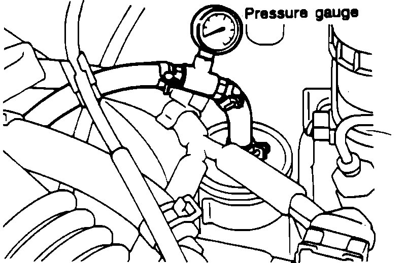

Only when car is idling and I attempt to press gas pedal car shuts off
Jan 7, 2021 at 5:14 AM (Merged)
  • 110,248 POSTS
Welcome to 2CarPros.
If it stalls when you press the gas, I have a feeling the fuel pump isn't producing enough pressure. Is the check engine light staying on when the engine is running?
If the light isn't staying on, I recommend starting with fuel pressure. Here is a link that explains in general how it is done:
Here are the directions specific to your vehicle. The specs are in the directions and the pictures correlate with the directions. Note: I realize most people don't own a fuel pressure gauge. However, most parts stores will lend or rent one to you.
____________________________________________

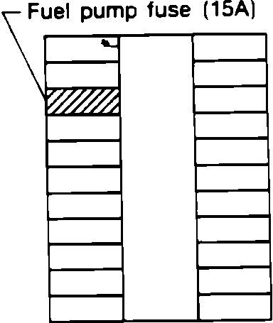

FUEL PRESSURE TEST
Fuel Pump Fuse
Pic 1
NOTE: To obtain an accurate fuel pressure reading the engine must by running. Basic fuel pump operation can be verified in a no start condition by observing gauge reading while cranking engine. Fuel pressure should be approximately 43 psi (294 kPa).
1. Remove fuel pump fuse from underdash fuse box.
2. Start engine.
3. When engine stalls, crank or attempt to restart engine 2 or 3 times to release pressure.
4. Turn ignition switch off and reinstall fuel pump fuse.
NOTE: Steps 1 through 4 are provided to release fuel system pressure to eliminate fuel spray.
Fuel Pressure Gauge Connection
Pic 2
5. Disconnect fuel line from fuel filter and connect a suitable pressure gauge as shown.
6. Disconnect and plug vacuum line from fuel pressure regulator. Connect vacuum pump to pressure regulator.
7. Start engine and idle.
8. Fuel pressure should be approx. 43 psi (294 kPa). If pressure is correct proceed to step 10, if not OK continue.
9. Using pliers, gently pinch fuel return line at fuel rail. If fuel pressure rises to approx. 43 psi (294 kPa) pressure regulator is defective. If pressure still is low or did not change, check fuel filter before replacing pump.
10. Slowly apply vacuum to the pressure regulator while watching fuel pressure.
11. Fuel pressure should decrease as vacuum increases, down to approx. 33 psi (226 kPa) at 20 in.Hg.
12. If fuel pressure does not respond to the application of vacuum, check fuel return line for restriction prior to replacing fuel pressure regulator.

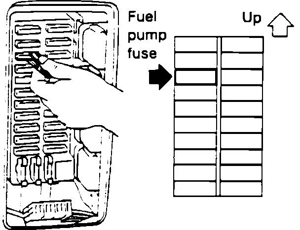

Fuel Pump Fuse Location
Pic 3
1. Release fuel pressure:
A. Remove fuse for fuel pump.
B. Start engine.
C. After engine stops, crank engine two or three times to make sure that fuel pressure is released.
D. Turn ignition switch off and install fuse for fuel pump.

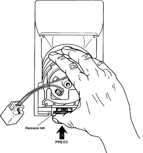

2. Remove rear seat bottom and back cushion.
Fuel Pump Access Cover
Pic 4

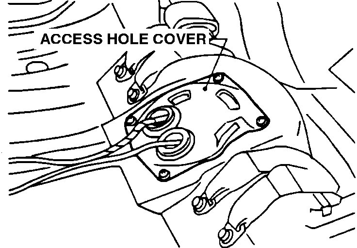

3. Remove Inspection hole cover.
CAUTION: Use rubber gloves to prevent fuel from contacting the skin when removing the fuel hoses and pump.
4. Disconnect electrical connector and fuel hoses.
5. Remove the six screws.
Gauge/Pump Assembly Removal
pic 5
TECH TIP: The sheet metal for the top of the fuel tank is REALLY SHARP! One way to protect yourself is to take some door edge moulding and apply it to the lip of the tank opening. Vacuum hose sliced lengthwise will work too.

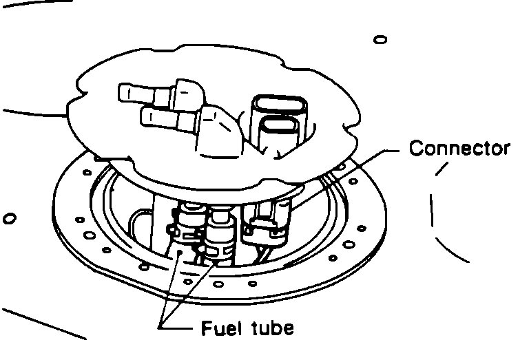

6. Remove fuel gauge sending unit and disconnect the fuel hoses and connector.
Fuel Pump Removal
pic 6
7. Remove fuel pump from fuel pump bracket by pinching the tab and lifting the pump out of fuel tank bracket.
