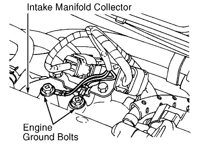

i have two codes p0450 and a p0446 both says that driver wont notice any thing. could they possibly be something else like a vaccum line broke causing both of these codes? it dosnt do it all the time though
Jan 7, 2021 at 5:08 AM (Merged)
HMAC300
  • 48,601 POSTS
these are both relaated to evap emission sensor check groundonintake-pic attached and then it may need a smoke test to see if it operatescorrectly.

how do you do a smoke test?? would that cause the car to die?? the grounds look ok im going to do more checking the vac hose's look ok to me so far
HMAC300
  • 48,601 POSTS
a smoke test has to be done professionally. you don't have nor can you get eth equiptment to do it.

i have power back at the valve on the canister. so should i go ahead and change that valve. if i can get if off i can hook it up to a battery and see if it is working where is the evap emission sensor located at??
HMAC300
  • 48,601 POSTS
the sensor is the valve.
JDAGBOY
  • 14 POSTS
could it be the tps is bad but not showing up on the scan tool cause it doesn't do it all the time??
HMAC300
  • 48,601 POSTS
no if anything the tps may be sticking and try to clean it with choke clear where it meets the throttle body.
but those codeare evap codes, it could be a small leak as well.

will these codes make the car die at red lights????????????????????????
HMAC300
  • 48,601 POSTS
it sholdnt' but you should clean tehthrottleplate and iac hole as that will. unless your fuel presure is low or the evap is putting fuel into the engine at idle it will also.
