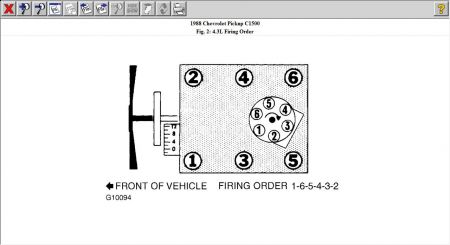

i just replaced my plugs and wires,along with the distributor cap and rotor,,i think i screwed up and got a few wires mixed up,,must be close cause its running,,but running rough.anywhere i can get a diagram that shows what wire to what plug,,have the hanes manual but it just tells me the firing order and does not work as i understand it,,its a 4.3 litre
Oct 20, 2020 at 6:02 AM (Merged)
  • 75,992 POSTS
See below
https://images.2carpros.com/forum/automotive_pictures/12900_43_1.jpg

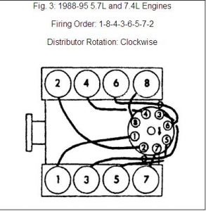

need firing order for 454 engine
DR LOOT
  • 2,311 POSTS
The intake manifold, should have the firing order stamped on it but I've will send you this photo.
https://images.2carpros.com/forum/automotive_pictures/307270_Graphic_2.jpg

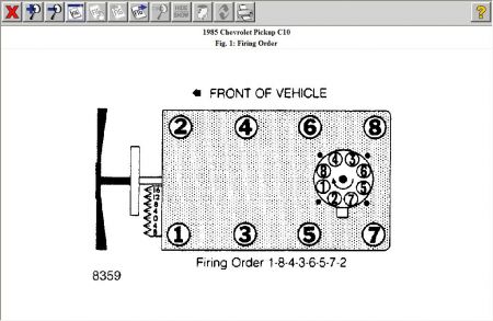

i need to know where the number 1 pin on the distributor cap is so i can put the firing order right........i believe the order is 18346572 not really sure about that either
Oct 20, 2020 at 6:03 AM (Merged)
JDL
  • 16,098 POSTS
https://images.2carpros.com/forum/automotive_pictures/170934_firing_order_2.jpg
I found the above picture. If you put the number one cylinder on tdc of the compression stroke whichever plug tower the rotor is leading into, should be the number one plug tower.

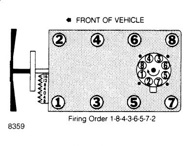

I had to remove the distributor to do some work on my truck and put the spark plugs back in the wrong order the eng is now back firing can you help me with the firing order so that I can reset the spark plugs wires correctly.
  • 75,992 POSTS
The firing order is 18436572. Here is a diagrams to help show you.
https://images.2carpros.com/forum/automotive_pictures/12900_fo_15.jpg
