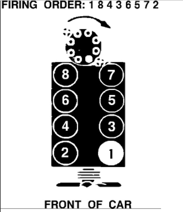

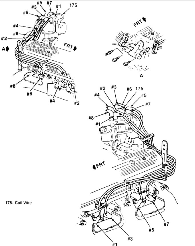

Well I tried to change the plugs and wires myself. The first side ( even #'s ) I just pulled all the wires off at one time. So I really didn't get the order down. The odd side I did one at a time so it should be correct. I tried moving them all around but no luck. It is still running rough ( off balance/out of order ) I guess. Any ideas on how to get the right order back in place? The ignition thing is numbered but I do not know which plug goes to which number.
Thanks.

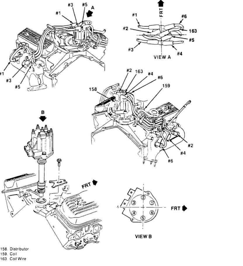

I have the 1500 model with the 4.3 Vortec V6. I recently did a tune up on the engine due to the mileage. I had my new brother-in-law help me out with the tune up. Well he pulled the wire off the plugs without marking the distributor cap and I am trying to find out how to set cylinder one so I can restart it. Please help! This truck is a business truck, and I am losing money just having it sit.

Here is the firing order for a 4.3 liter v6 and the 5.7 liter v8 chevy engine. Check out the diagrams (below) Firing Order 1-6-5-4-3-2 Firing Order 1-8-4-3-6-5-7-2

Firing order 1,6,5,4,3,2.
The driver side bank, front to back, 1,3, 5.
The passenger bank from front to back, 2, 4, 6.

What is firing order of 5.0 engine

https://images.2carpros.com/forum/automotive_pictures/188069_91Chevy5Lfireordr_1.jpg
