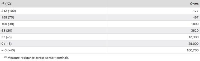

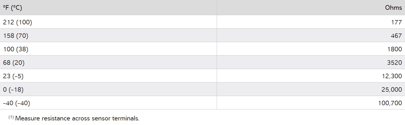

those ecms do not come with a prom and to get one is almost impossible but check it out and see what you can find first.If you had a manual to help would be much better also check coolant sensor for resistance and see if map sensor vacuumline is plugged or rotted/soft that creates problems as well. but I you get codes is much better help.
