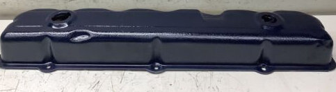

How would I check for stuck valves?
Tuesday, October 18th, 2022 AT 6:49 AM
HHLAMBERT
  • 19 POSTS
And where even are the valve covers?
Tuesday, October 18th, 2022 AT 6:52 AM
  • 109,885 POSTS
The valve cover is at the top of the engine. It is where the oil fill cap is located. See pic below for a picture of one.
