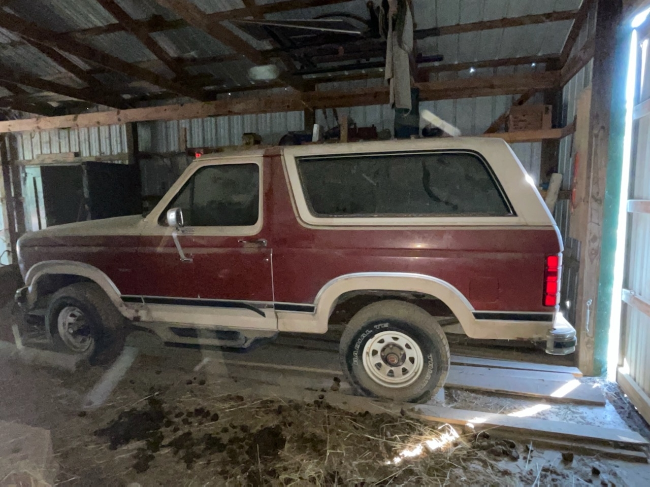

I have the vehicle listed above (XLT) sitting in my barn, it has sat there for around 8 years, and it won't start. I replaced the battery and tested the distributer cap, and everything seemed to work fine, and I had just replaced the oil and gas before trying to start it. I also replaced the battery, and it still would not start. I know there is electricity going to the spark plugs, however I am not sure if the sparkplugs are bad. I don't entirely know what to do so if anyone can help it would be greatly appreciated.

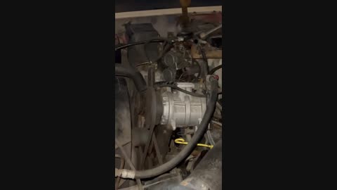

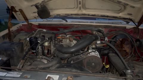

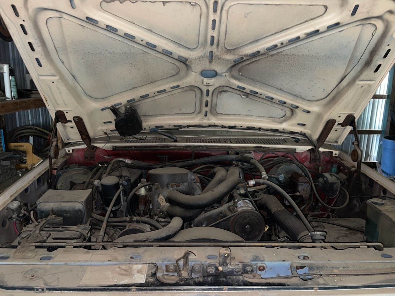

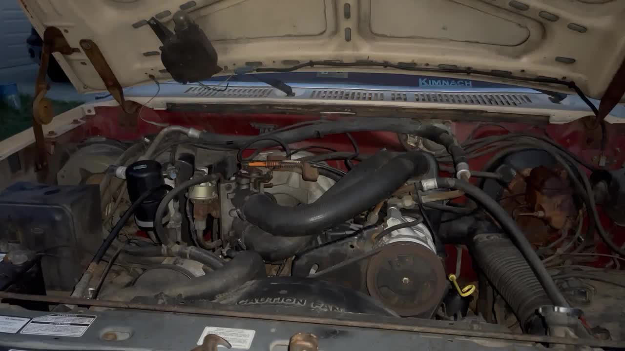

I have a few pictures that might help.

So, my vehicle listed above Eddie Bauer - V8 - 5.0L 302ci GAS MFI vin N - 2 valve OHV has been having trouble starting and It has not started in around 10 years and I have already replaced the high pressure fuel pump, the fuel pump relay, the spark plugs, the spark plug cables, and the air filter But it still won't start for some reason I know it has spark because It does backfire out of the carburetor when cranking it with starter fluid and I know it has compression because I tested it myself. I know starter fluid should allow it to run for a minute and then shut off, but it won't even do that. I recently replaced the high-pressure fuel pump that is an In line fuel pump and I know it should be getting fuel but I just don't understand why it won't start still.

If it backfires, it could be timing related. However, that would also affect compression. What pressures did you find when tested?

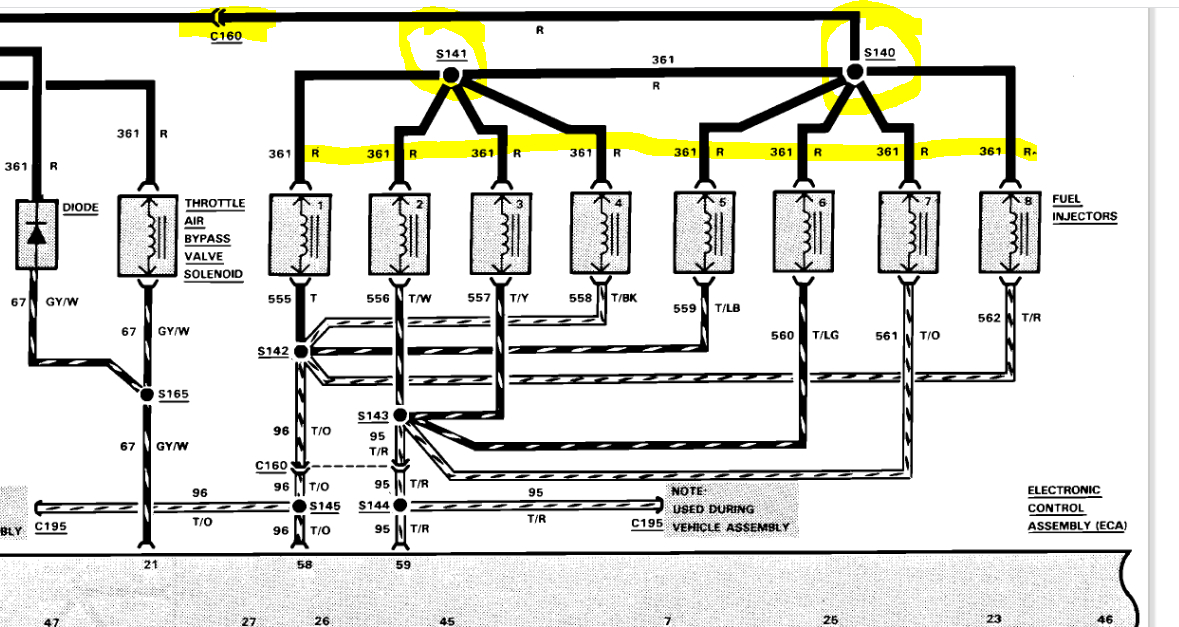

Also, with the key in the run position, check each fuel injector for power. Each injector will have a red wire going to it. (See pic below). Confirm there is power present using a test light or voltmeter.
Let me know what you find.
See pic below.

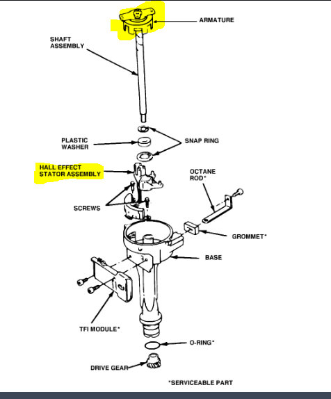

Have you checked the pick-up in the distributor? I know you mentioned the distributor cap was checked, but make sure the stator and armature are not corroded or rusted. See pic 1 below

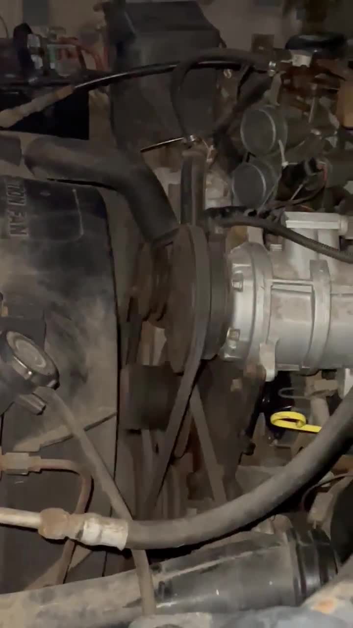

Hello there Joe, I am following up on a request to post a video of it cranking and I have a video that i forgot about it. here it is:

I also have a more recent video of it if you would like.

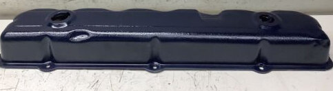

When you were cranking the engine, I heard what sounded like a knock when the starter would slow and strain to keep turning. I would do two things. First, I would remove the valve covers to confirm there are no stuck valves. If they are good, I would perform a compression test.

How would I check for stuck valves?
Oct 17, 2022 at 11:49 PM
HHLAMBERT
  • 19 POSTS
And where even are the valve covers?
Oct 17, 2022 at 11:52 PM
  • 110,244 POSTS
The valve cover is at the top of the engine. It is where the oil fill cap is located. See pic below for a picture of one.
