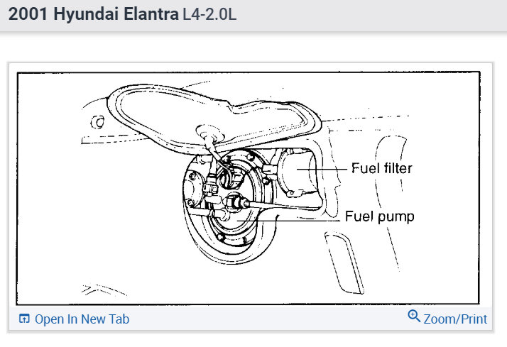

FRANKSTERX
Engine Performance problem
2001 Hyundai Elantra 4 cyl Front Wheel Drive Manual
i would like to know roughly where the fuel filter is located. i thought i looked in the usual places, maybe im over looking it?
Dec 31, 2019 at 2:02 PM (Merged)
BLUELIGHTNIN6
  • 16,542 POSTS
Under vehicle, center, below cargo area, mounted on top of fuel tank, in fuel pump module

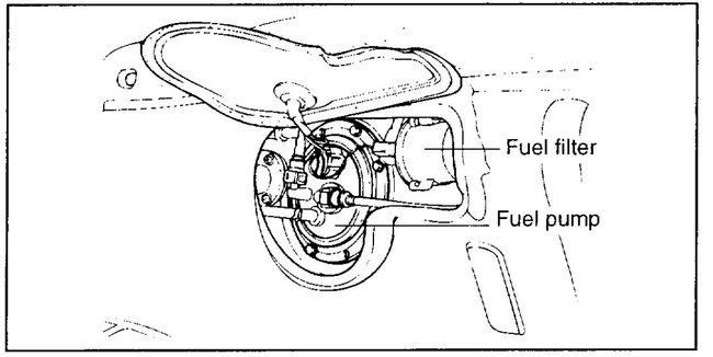

SATURNTECH9
  • 30,869 POSTS
https://images.2carpros.com/forum/automotive_pictures/416332_2003_hydi_elantra_fuel_filter_1.jpg
The fuel filter is located under the rear seat in a compartment above the fuel tank. Also, a filter sock at the base of the fuel pump located in the fuel tank. There you go. USER NOTE: Some of the cars don’t have a fuel filter there

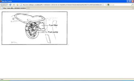

LINDSEYTRAVIS34
It bogs down when you turn the car off. it will sit for a minute and start back up. How many fuel filters are on this car and where are they located?
Good morning.
There are two filters. there is one external and one internal in the tank. I attached a picture of the external but to access the internal, the tank must be removed for access.
