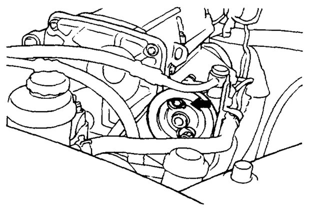

When I start my car there is a squealing (sounds like a belt) that goes on for 5-30 seconds and then stops. The same squealing can sometimes be heard when I make a turn. Also, when the car is cold the steering wheel is difficult to turn.
Jan 22, 2009 at 11:11 AM
  • 110,194 POSTS

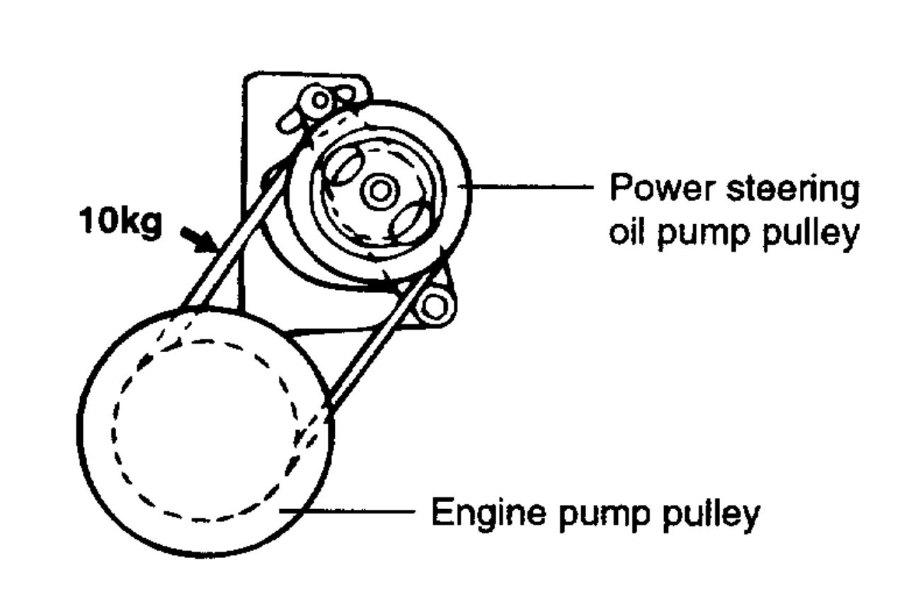

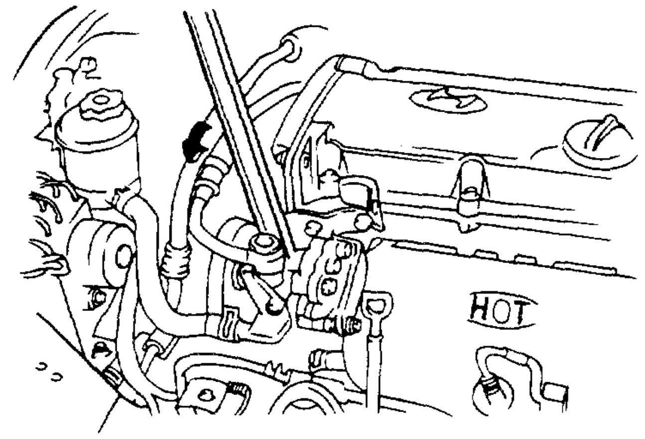

It sounds like the power steering pump is loose. You should not have more than 1/2 inch up and down play. If there is more, adjust or replace the belt.
1. Press the V belt, applying a pressure of 98 N (10 kg, 22 lbs.) at the specified point and measure the deflection to confirm that it is within the standard value.
standard value
V belt deflection: 6 - 9 mm
2. If the belt deflection is beyond the standard value, adjust the belt tension as follows.
1. Loosen the bolt adjusting the power steering "V" belt tension.
2. Put a bar or equivalent, between the bracket and the oil pump and adjust the tension so that the belt deflection is within the standard value.
3. Tighten the bolt adjusting the power steering "V" belt tension.
4. Check the belt deflection and adjust it again if necessary.
Let me know what you find.
See the diagrams below

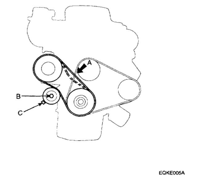

I recently had the timing belt, water pump, serpentine belts (alternator and A/C compressor) and tension-er pulley all changed and I still have a squealing sound when I start my car. The sound is prevalent when the engine is cold, but after running a few minutes, the sound stops. My nephew did the work for me and he is at a loss as to what could be causing it. Any ideas as to what the problem could be? I did not have this issue before all the work was done. Thanks for the help.
Dec 12, 2018 at 6:05 PM (Merged)
  • 54,840 POSTS
It sounds like the belt tensioner is not doing its job correctly or not adjusted right, but to be sure remove the serpentine belts and start the car to see if the noise is gone. This will confirm the belt is the problem.
If so then double check the size of the belt and make sure the tensioner spring is working correctly. Here is a diagram (below).
and
https://www.2carpros.com/articles/how-a-serpentine-belt-tensioner-works
Please let us know what happens, we are interested to see what it is.

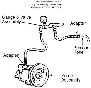

When turning the steering wheel, there is a screaching noise. Visual indicated that the pump pulley almost stops. If the steering is returned to straight ahead, the squealing stops. Adjusted the belt tighter than spec with no change. Is this a pump problem. plugged filter, or ???
MERLIN2021
  • 17,250 POSTS
If the tension on the belt is good, check the fluid level, and if OK, the pump, or rack is bad.
FJLABARBERA
  • 8 POSTS
The fluid level is ok. Is there a way to check the pump or do I have to replace it first to see if it fixes the problem?
MERLIN2021
  • 17,250 POSTS
SYSTEM TESTS STEERING PUMP PRESSURE TEST 1. Disconnect pressure hose from oil pump. Install pressure tester between pump and pressure hose using Gauge (09572-22100) and Adapter (09572-22000). See Fig. 1 . See SPECIAL TOOLS . 2. Bleed air from system. Start engine and allow it to idle. Turn steering wheel lock-to-lock several times until fluid temperature reaches 122 °F (50 °C). Raise engine idle speed to 1000 RPM. 3. Close and open shutoff valve to measure fluid pressure. Relief pressure should be at or near specification. See RELIEF PRESSURE SPECIFICATIONS table. If relief pressure is not as specified, replace pump. See POWER STEERING PUMP under REMOVAL & INSTALLATION. CAUTION: DO NOT leave shutoff valve on pressure gauge closed more than 10 seconds, or damage to oil pump will result.
https://images.2carpros.com/forum/automotive_pictures/62217_elantraa_2.jpg
