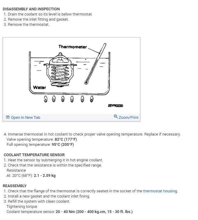

I checked both cooling fan and air conditioning compressor cooling fan. They are operating normally and the car is now blowing cold air. After letting the car idle until the temperature gauge reached the halfway mark, the water in the radiator is remaining still, no movement at all. Did not think the car needed to run 'hot' before water started to circulate.
Thursday, July 17th, 2008 AT 1:50 PM
DOCFIXIT
  • 18,828 POSTS
You have found the problem. Yes, coolant should be circulating the thermostat is not opening to allow flow. Replace thermostat and you should be fine.

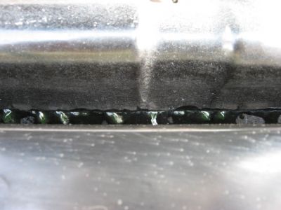

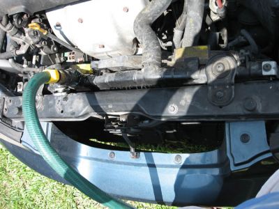

As I was adding water I noticed some 'pinholes' on the seam of the radiator near the top radiator hose. Are these normal 'overflow' type holes or did the weld let loose as the radiator overheated as I suspect.
Photo #1 shows the complete top of radiator.
Photo#2 is a close up of the 'pinholes'.
Thanks for all your help, just a mom with limited knowledge trying to get the kid back on the road. She has my car!

DOCFIXIT
  • 18,828 POSTS
Bummer on the radiator you are right pinholes not good.
Is that a metal tank if so a radiator shop may be able to repair if plastic no.
Are you going to DIY?
Thursday, July 17th, 2008 AT 2:48 PM

It is plastic and yes DIY, sigh.

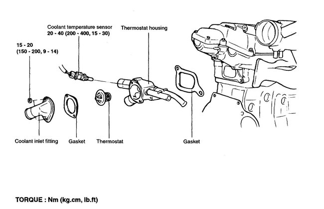

The thermostat. Follow top hose to engine housing two bolts.
Radiator on top the two black brackets unbolt fan assembly needs to come off
Also two metal lines that go to transmission for cooling need to be removed with a line wrench.
Good luck and please pm me if you need help.
Shop around for radiator and some shops do repair plastic so try that to save money.

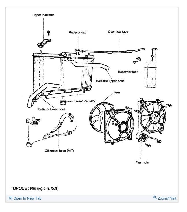

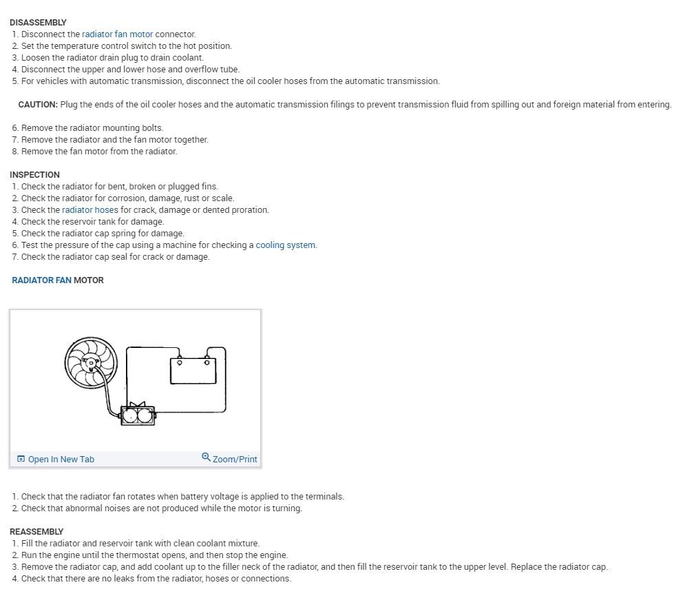

See the guides below on thermostat replacement and radiator replacement, they are not specific to your car, but will give you an idea of what is in store.
https://www.2carpros.com/articles/how-to-replace-a-car-radiator
See the diagrams below for make/model specific instructions and pictures.

MARK6937
Your radiator is bad. The exact thing happened to my 2002 Elantra. I first noticed a mild smell of anti freeze followed by my AC blowing warm, I thought my AC went out until I noticed my car spewing anti freeze. I could not find the leak until I back traced the fluid and where it was leaking from. I replaced the radiator and everything went back to normal including the AC. This vehicle also has a problem with the Fan located to the passenger side of the front of the motor; the right one works but the one on the passenger side do not. I am almost positive your radiator id bad. They make this one with plastic seams and when it overheats the radiator bursts at the seam.
