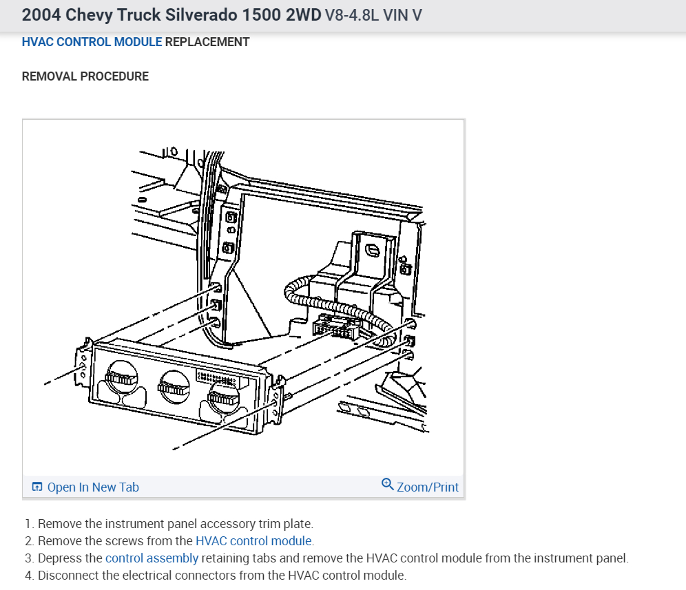

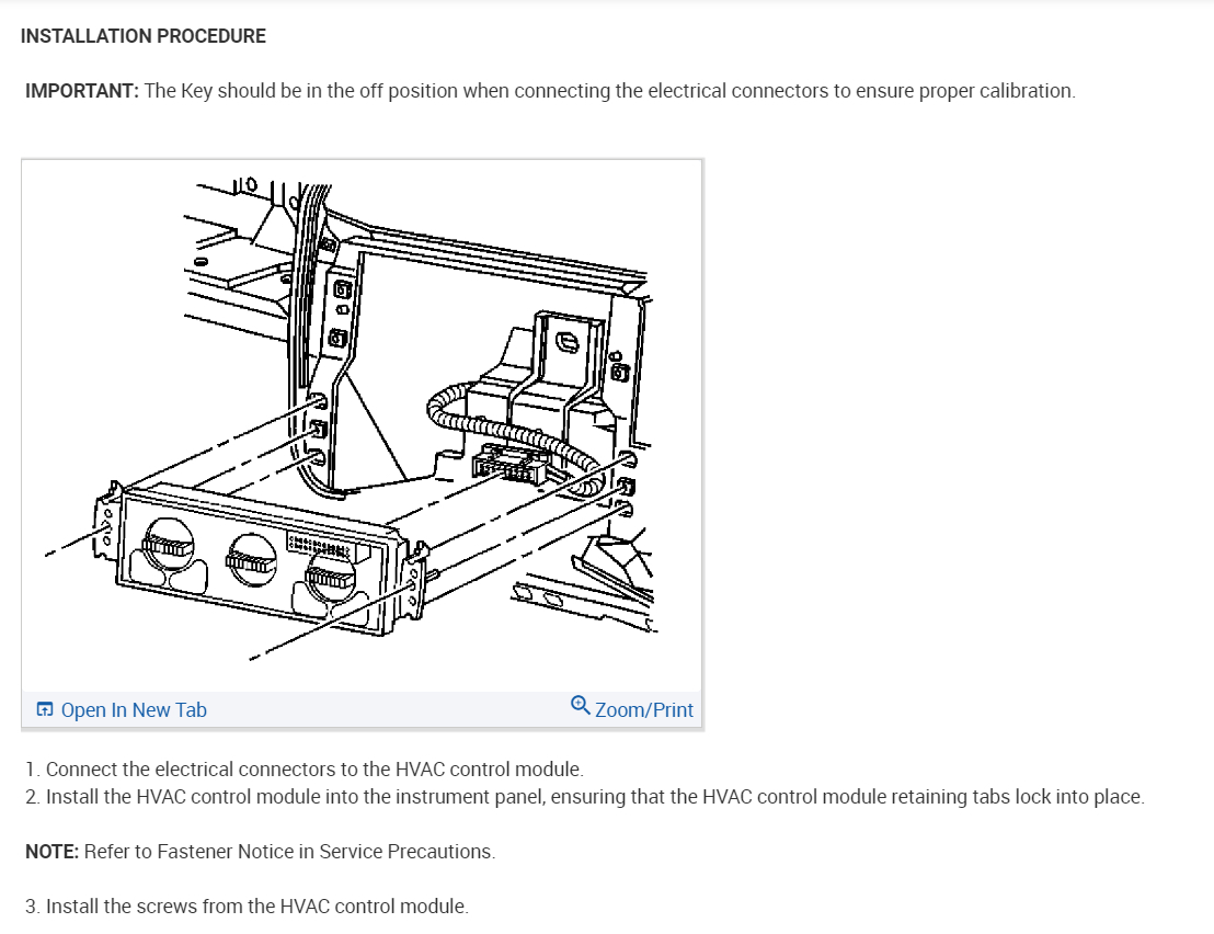

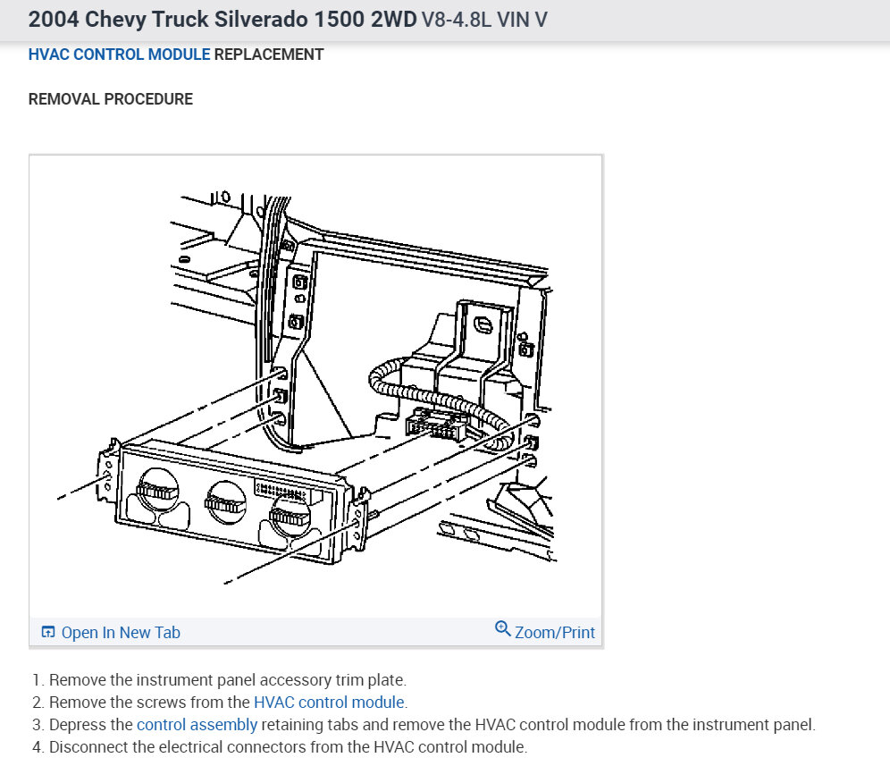

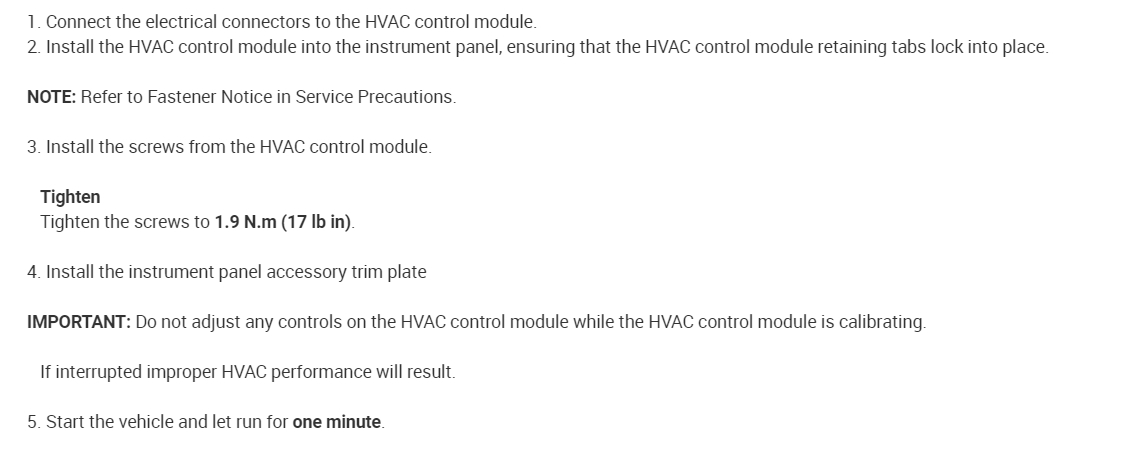

Here is how to change out the HVAC control head in case you need it. Check out the images (below). Please let us know what happens.
