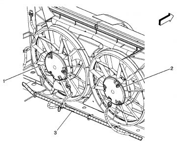

DOCFIXIT
  • 18,828 POSTS
Fans on back radiator towards engine see figure
http://www.2carpros.com/forum/automotive_pictures/198357_Graphic_527.jpg
Tuesday, July 27th, 2010 AT 12:09 PM

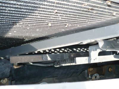

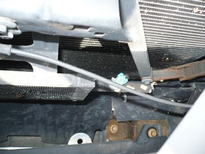

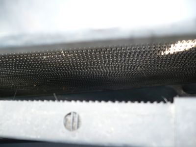

KINGTAUPO
  • 6 POSTS

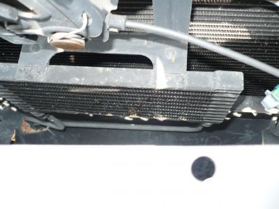

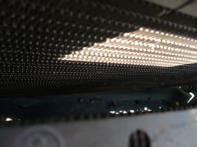

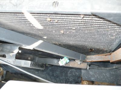

Thanks for working with me in this. I pulled the plastic cover off the top of the radiator and there are no fan infront of or behind the oil heat exchanger, the AC heat exchanger or the engine radiator. See picts.
http://www.2carpros.com/forum/automotive_pictures/554744_P1020672_2.jpg
http://www.2carpros.com/forum/automotive_pictures/554744_P1020671_1.jpg
http://www.2carpros.com/forum/automotive_pictures/554744_P1020670_2.jpg
http://www.2carpros.com/forum/automotive_pictures/554744_P1020669_2.jpg
http://www.2carpros.com/forum/automotive_pictures/554744_P1020668_2.jpg
http://www.2carpros.com/forum/automotive_pictures/554744_P1020667_1.jpg
Tuesday, July 27th, 2010 AT 2:02 PM
DOCFIXIT
  • 18,828 POSTS
O.K.
Pics show front of radiator little rad is for power steering next is condensor for A/C then Rad look between rad and front of engine for fans
Tuesday, July 27th, 2010 AT 2:44 PM

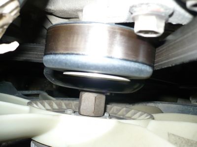

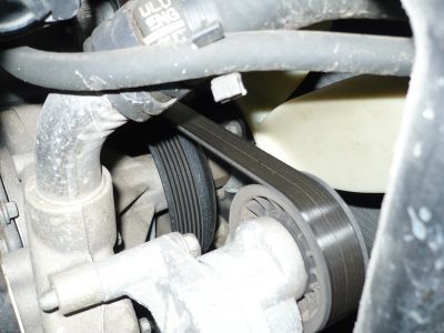

KINGTAUPO
  • 6 POSTS

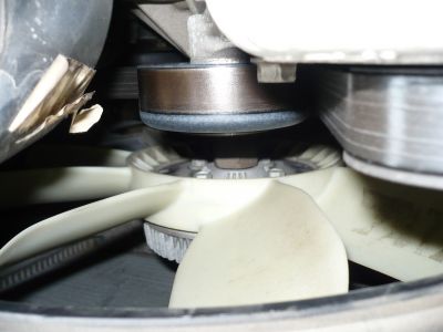

The is a large off white plastic fan infront of the water pump that the serpentine belt is attached to. There are no other fans from that fan forward or rear. See picts.
http://www.2carpros.com/forum/automotive_pictures/554744_P1020673_1.jpg
http://www.2carpros.com/forum/automotive_pictures/554744_P1020675_1.jpg
http://www.2carpros.com/forum/automotive_pictures/554744_P1020677_1.jpg
Tuesday, July 27th, 2010 AT 3:50 PM
DOCFIXIT
  • 18,828 POSTS
That is a mechanical fan and clutch silver thing in middle is clutch that needs to be replaced if not hard to turn by hand engine hot.
Wednesday, July 28th, 2010 AT 1:28 PM
KINGTAUPO
  • 6 POSTS
The clutch replacement will fix the AC issue? How are they related?
Thanks
Wednesday, July 28th, 2010 AT 1:39 PM
DOCFIXIT
  • 18,828 POSTS
Driving at speed A/C works because ram air is driven through condenser to cool. In traffic if clutch is faulty it will not pull enough air through Condenser to cool freon so A/C stops blowing cold.
