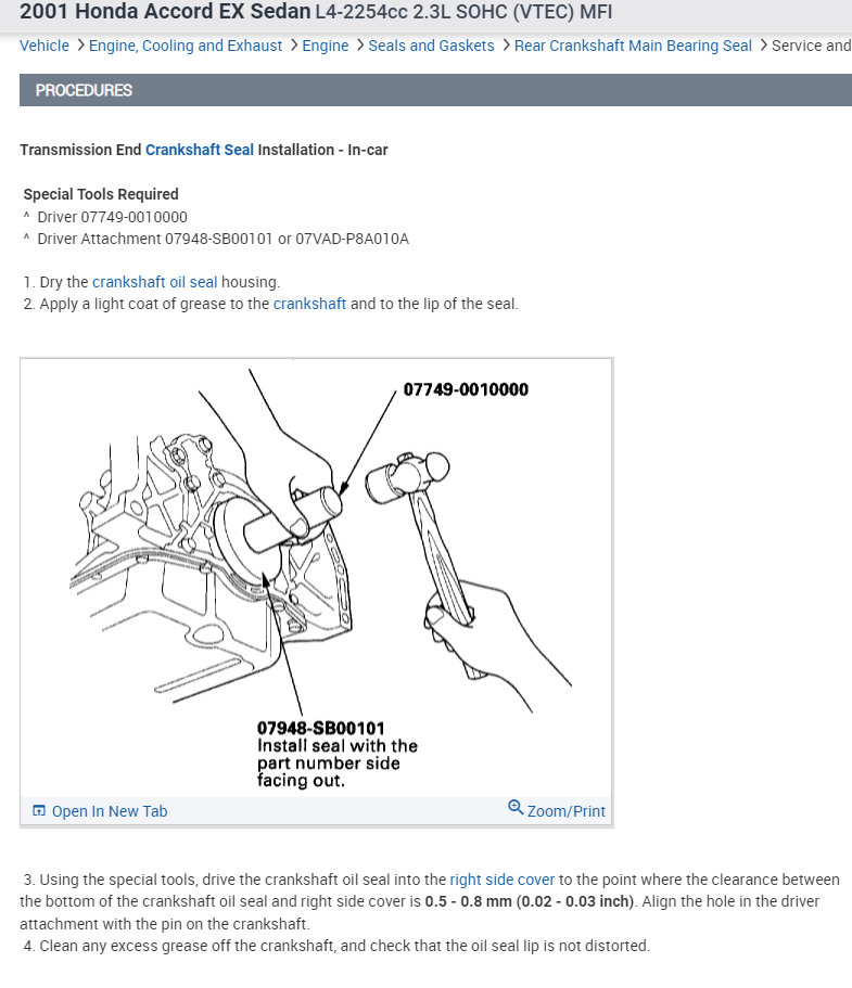

Larger leaks many times are from blown seals. One of the common leaks is the rear main seal.
This is where the engine and transmission connect.
This, however, will require the removal of the transmission to access.

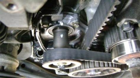

Hi, I just wanted to jump in. As Sean mentioned earlier, a blown seal will cause a major leak. One thing I have run into is the balance shaft seal popping out. Remove the timing belt cover to inspect. See image below. Even if the seal is not all the way out, check for a leak and check both timing belts for oil saturation. If it has oil replace them also.
