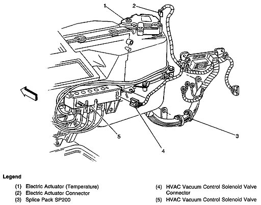

EDLYNCH
Is the location of the blend door actuator the same for right hand drive as it is for left hand drive and if not what is the location?
Jan 4, 2021 at 1:00 AM (Merged)
WRENCHTECH
  • 20,761 POSTS
I can tell you where it is for left hand drive because that is the only type we have in the US. It is on the top of the HVAC housing and requires removing the dash to access it.
See image:

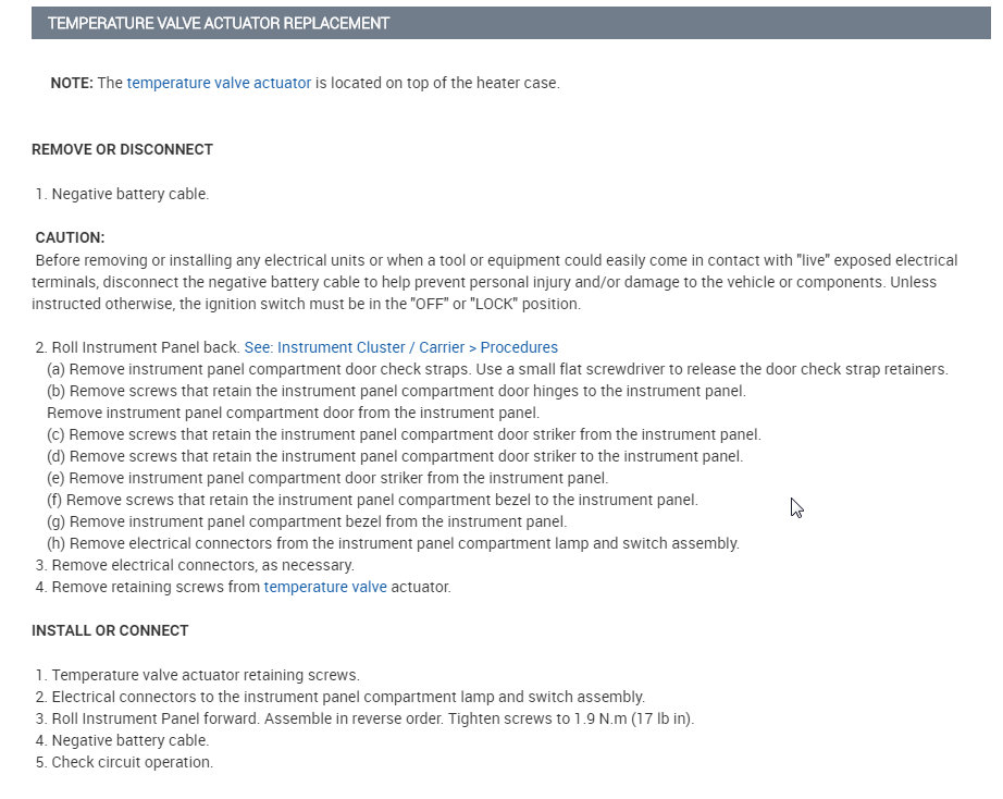

Hot all the time. I need the location to replace temperature blend door actuator.
Attached is the location and procedure for this actuator. Let me know if you have questions and I will be happy to assist further. Check out the diagrams (Below). Please let us know if you need anything else to get the problem fixed. Thanks

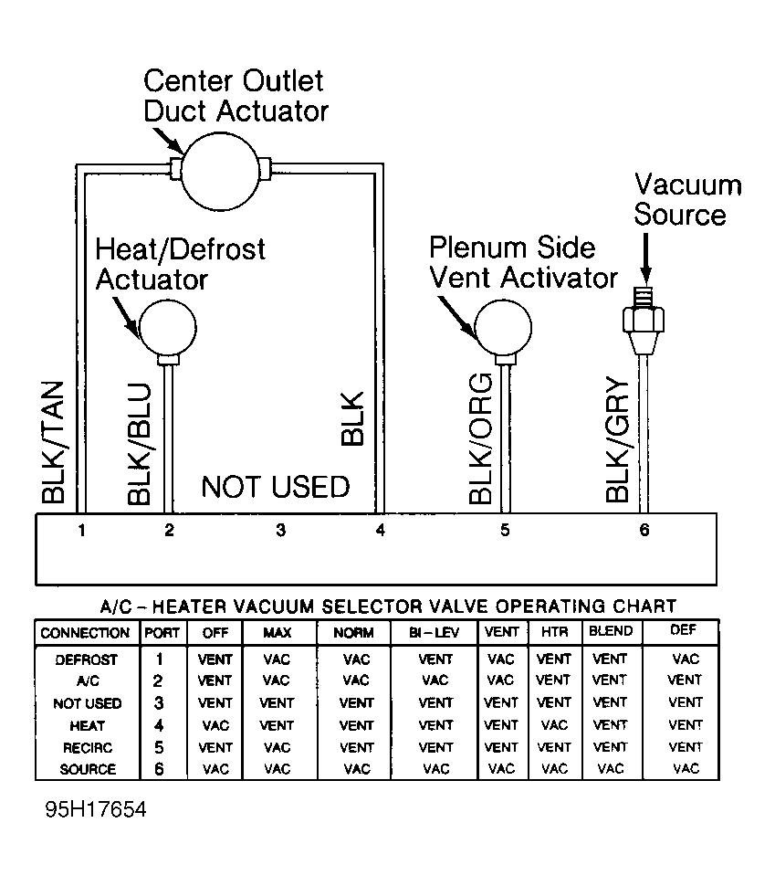

I can't find the actuator. I've looked and looked. I found 2 different actuators but neither is the one I'm looking for. The ones I found are vacuum ones. I'm looking for the electrical ac door actuator. Can you please help?
  • 110,244 POSTS
First, is this a full size blazer or S-10 Blazer. If full size, everything I find is vacuum actuated. See attached image.

  • 110,244 POSTS
I looked up for an S10 and the vacuum schematic is the same. Which door are you looking for? Can you describe the problem?

Do you have a diagram of the vacuums for the 95 s10 blazer?
Jan 4, 2021 at 1:01 AM (Merged)
  • 110,244 POSTS
I thought it was all vacuum. As far as a schematic, I sent the only one for the HVAC system that is listed in my manual. I checked the S10 and it's the same one.
Are you looking for something different?

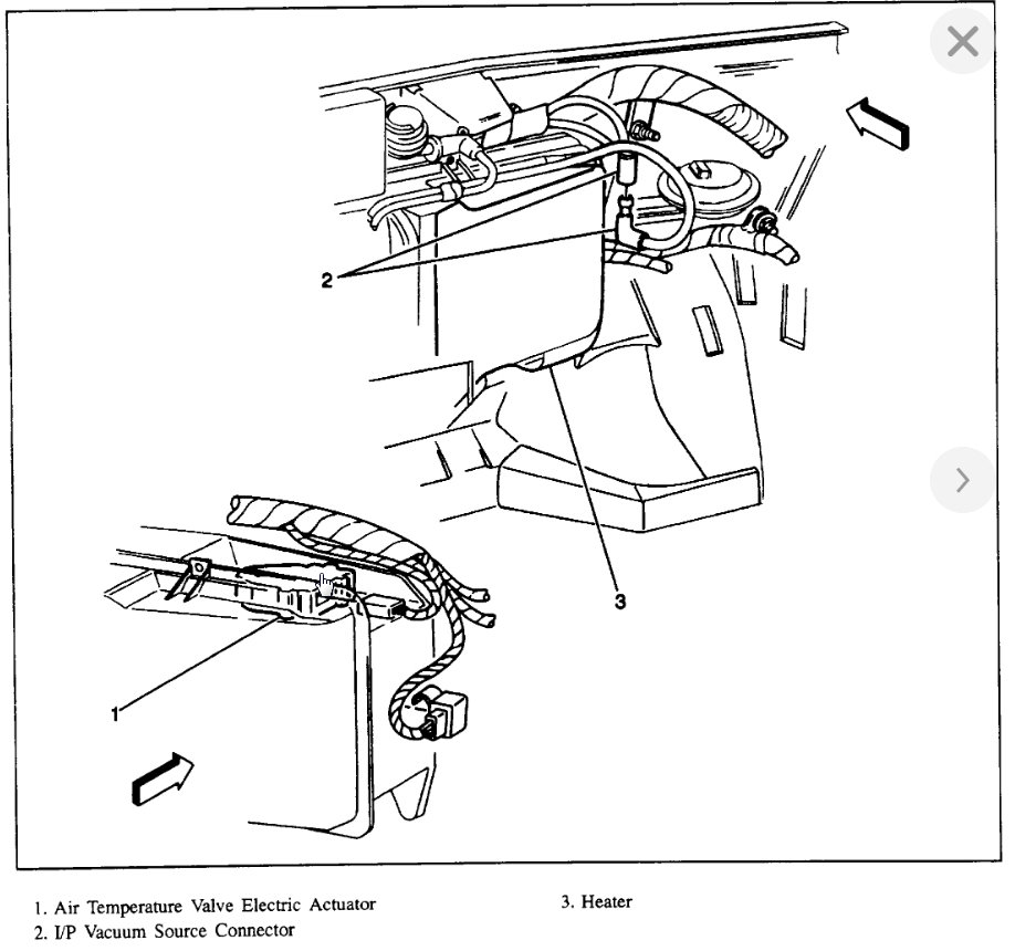

STEVE MEENTS
Need to repair air plenum door inside air flow box.
STEVE W.
  • 15,352 POSTS
Which one? Most of them require you to pull the dash and the HVAC box to do anything. Have you tested to be sure it is not just a bad actuator?
STEVE MEENTS
Got door plenum to move freely. I got the old actuator out with some difficulty ( big hands ) bought new one and am having hard time aligning and installing. Do I need to pull dash out?
STEVE MEENTS
On this 2000 Blazer the actuator sits at the very top next to dash board.
STEVE W.
  • 15,352 POSTS
OK you're working through the glove box on the temperature actuator correct? There isn't much room but you can get it in there with a bit of fiddling.
