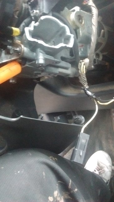

I had lost my keys and have to get to work,so I pulled the ignition out,and went to start with a screwdriver,it turn over but the locked in the on position and lights on dash said secerty system,now the ignition is locked in the on position and car will turn over but not start,,,,

Okay, the cable moves two little buttons in and out as I shift, look at orange, changes nothing.

This system may not work with the lock removed. It is not designed to do that. My advice is repair the damage and put the system back to original condition.

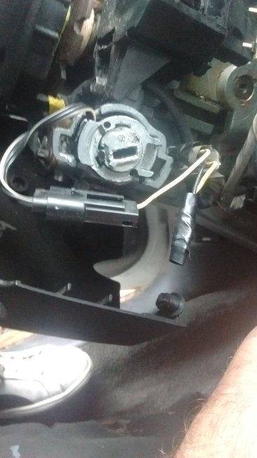

Here it is in its original with lock back in will turn over now but still locked in the on position and secerty system light still flashing on dash will turn over but will not start.

I still have the black and yellow hooked together though.

Nobody told you to hook those wires together. You were supposed to solder a very specific resister between them.

Solder, not twist together.
